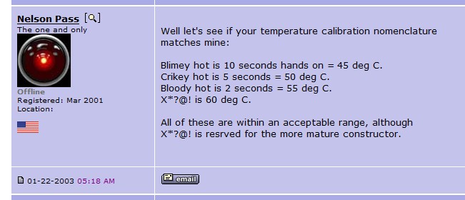

regarding heat, after running for some 15-20 minutes i am not able to touch the heat sinks more than 1-2 sec.. Is there any thing else to check/measure (current /voltage) in the circuit to confirm every thing is normal, apart from the 10v voltage between the main gain MOSFET drain and ground?

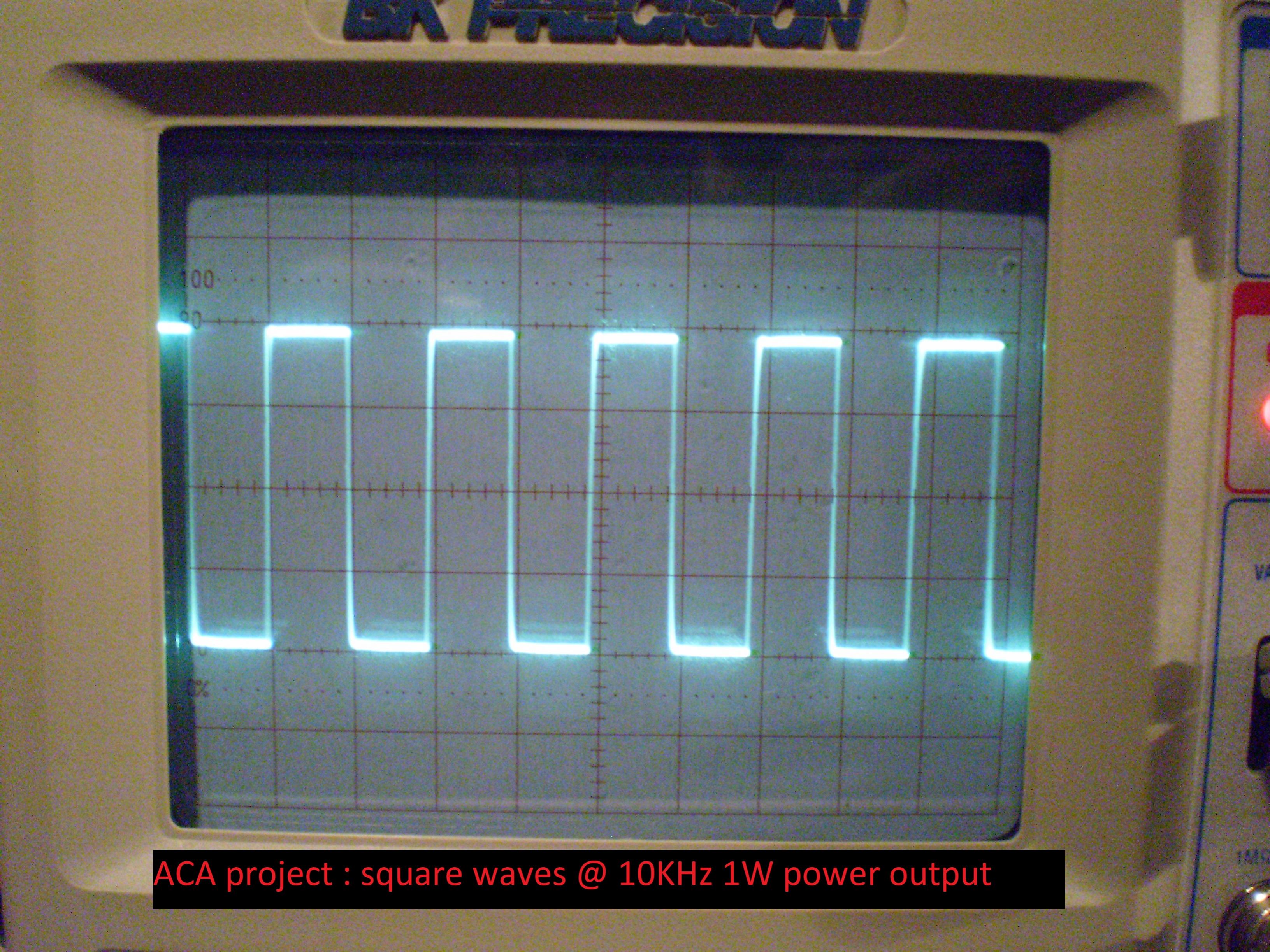

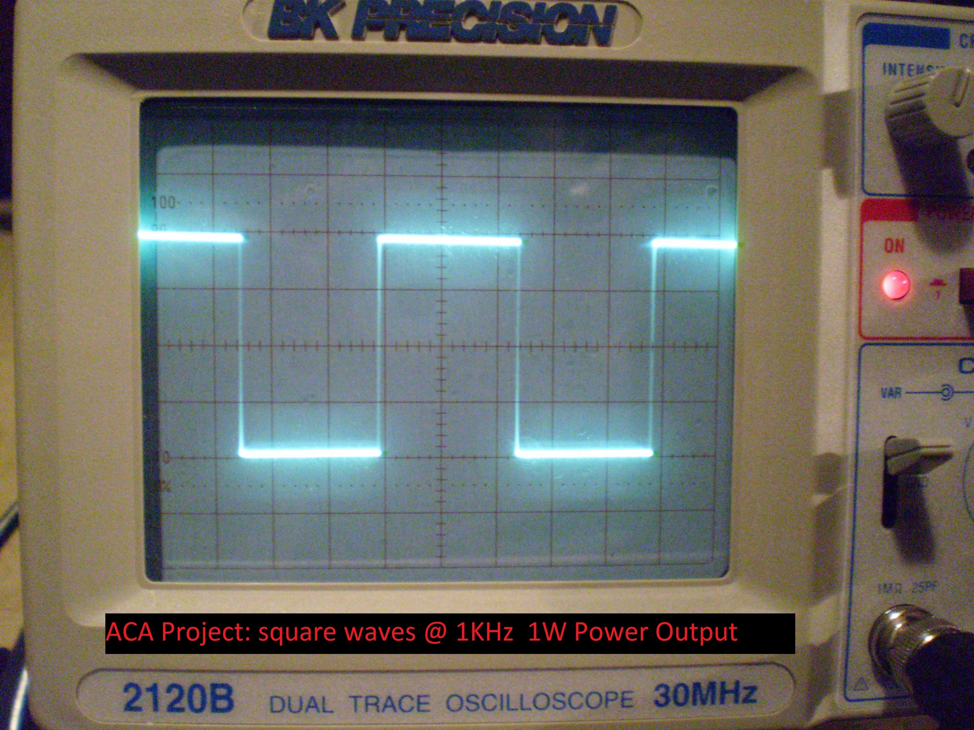

ACA Project: square waves & power output after R15 mod
After R15 mod, I investigated square wave performance at 1KHz & 10KHz (1W power output). These waveforms did not change significantly with R15 mod.
Power Output at onset of clipping after R15 mod increased from 3.5W to 5W. That seems to follow published power output graphs by Pass Labs for the ACA circuit.
Next test will be bandwidth sweeps to determine -3dB low/high frequency performance.
