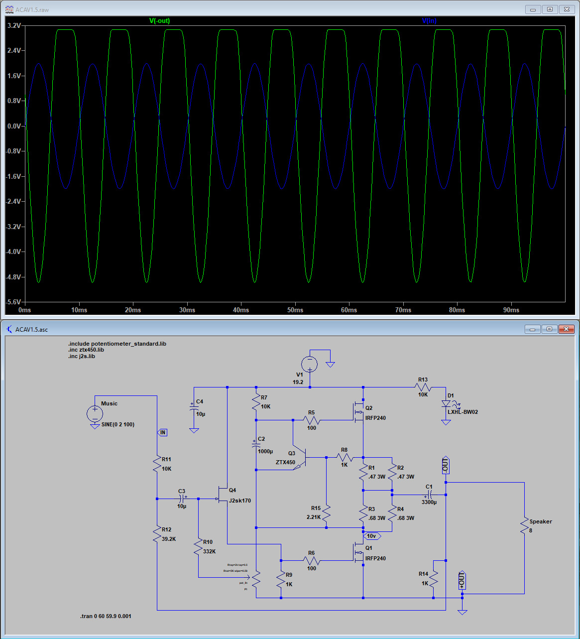

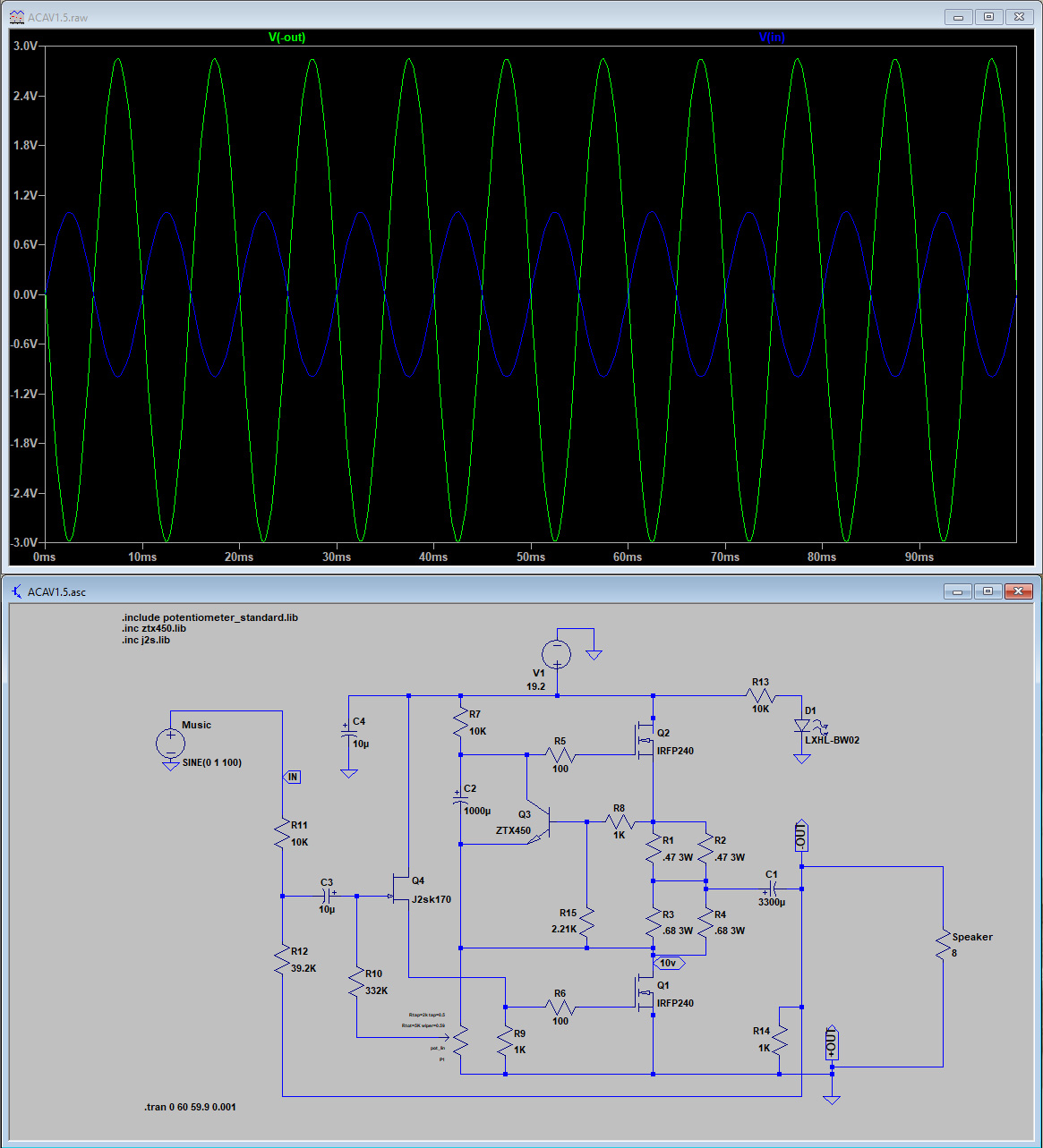

Just to back-up a bit, here are my simulations at 1V, 2V and 4V sine wave into a 8 Ohm 'simulated' speaker.
Do this graphs make sense? I have a full +3V ~ -3V swing when inputting 1V. When I up the input signal to 2V, then I get clipped +3.2V and (apperently unclipped) -4.8V swing. When it reaches 4V, I get less positive output than the original signal! I get a heavily clipped +2V ~ -5.4V swing.
Does this mean that if I input a 4V signal to the amp I will get heavily (insert adjective here: distorted, clipped, muddy, noisy, compressed, etc.) sound? Am I reading this wrong?

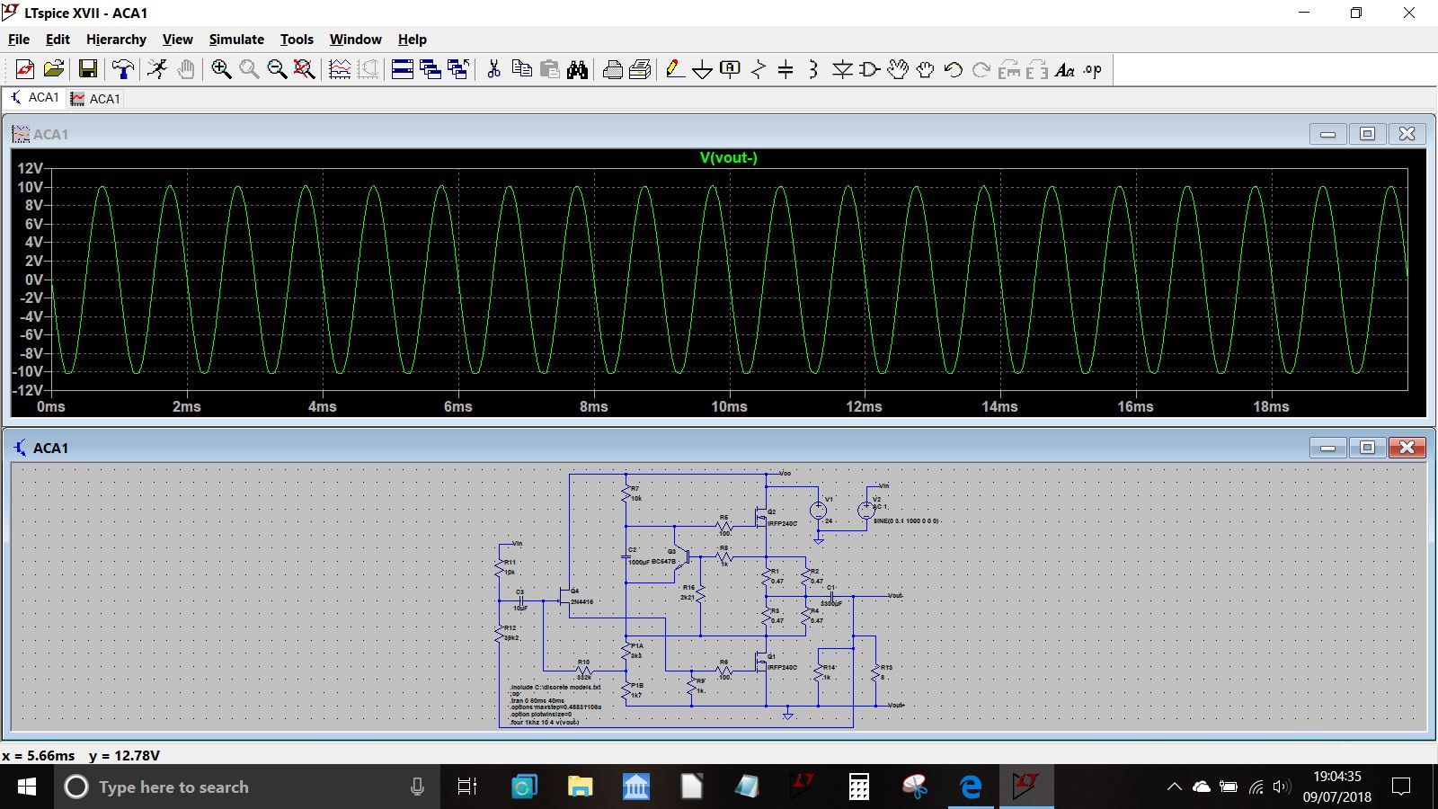

Something is amiss with the simulation. You should be able to hit close to 8vrms into 8 ohms.
Without sweating the details I suspect you will need a preamp with a voltage gain of around '5' in order to give a decent feel to a volume control and to be able to reach full output from material recorded at lower than average levels... of which there are such examples of CD's for example.
Yes, your simulation looks cleaner... still, there's a couple of things there:
  • C4 is missing (not sure its important)
  • The 'central' array of resistors has 4 x 0.47Ohm instead of the 2 x 0.47 + 2 x 0.68
May that make a difference?
edit: Also, is the sine wave not going through the 10K R11 input? Not really sure that makes a difference, but it might?
edit2: sorry, missed the labeling there. I see its vin as expected.

C4 has no effect in the simulation because the rail is pure and at zero AC impedance.
My mistake on the 0.68 ohm... I hadn't noticed. Changing those doesn't greatly alter things on the sim as far as I can tell.
The simulation is pretty critical on the model of FET used and I also had to tweak the bias setting resistor to obtain around 1.45 amps. I need R15 at 600 ohms to achieve that.
...The simulation is pretty critical on the model of FET used and I also had to tweak the bias setting resistor to obtain around 1.45 amps. I need R15 at 600 ohms to achieve that.
I did download models for the ztx450 and the J2sk170, those may account for the differences?
For the bias, do you mean adjusting the R15 2.21K to 600? Where should I measure the bias? I was measuring the 12V on the main Q1, which, exactly like you, yields me a 0.66 on a 5K Pot (I donwloaded a linear Pot model) which mimics your 3300 - 1700 pot resistors. That gives me the 12V on Q1.
So where should I measure the current of 1.45 to ensure the correct bias? Thanks,
Rafa.
