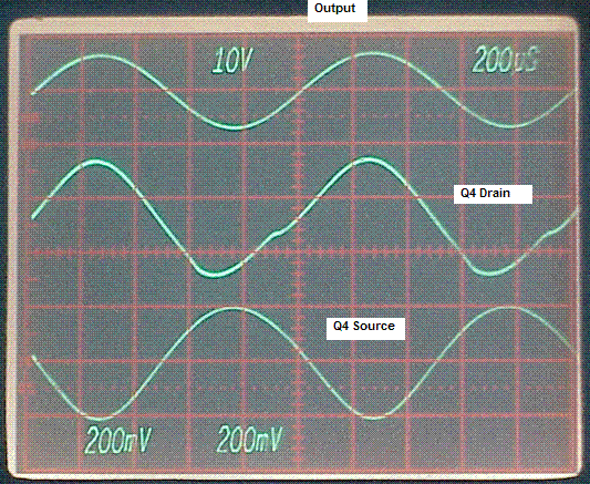

I'm not sure what Nelson was getting at exactly. Here are a few measurements I took and a scope photo where you can see the distortion at Q4's Drain.
Distortion 1kHz 1 Watt @ 8 ohms
Output 0.79%
Q4 Source 3.46%
Q4 Drain 6.04%
Distortion 1kHz 3 Watt @ 8 ohms
Output 1.63%
Q4 Source 6.55%
Q4 Drain 12.8%
Note that the generator amplitude was 963mV RMS. Signal at Q4 Source is about 140mV RMS.

@Loudthud: what was the circuit in the '170 drain lead used for your distortion measurements? Did you measure against earth?

Loudthud:It seems to me that loop feedback is contaminating the intrinsic performance of Q4 [in janneman's schematic] which maybe pristine without it. What are the distortion properties at the source and drain of Q4 without loop feedback by comparison? How great is the performance of Q4?
Yes. The 100K input impedance of my Audio Precision System 1 is capacitor coupled. I just left the ground connected and moved the hot lead to different points. To double check, I connected the System 1 differentially across the 1K Drain resistor and there was very little difference in the distortion reading. In the scope photo the output is DC coupled before the output capicitor, the other two traces are AC coupled.
I'm using a linear bench power supply. My shop is about 2 miles from a 50KW AM radio station. At times it gets into things, the analyzer seems to need a ground wire clipped to the circuit under test. There is a 5 Megawatt TV transmitter about 300 yards from the shop, but I never noticed any interference from it despite using a 1 GHz scope.

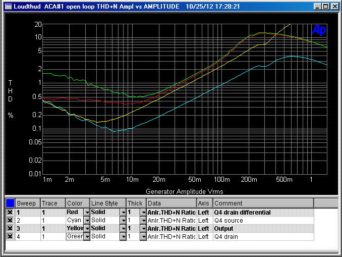

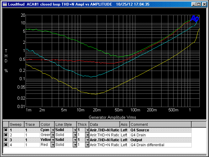

Voltage at the drain in the split load phase inverter (an analog of the drain current) depends on the total impedance at the source which includes the gate of Q1 and it's gate stopper. The point of the overshoot being that Q1 is a substantial load. I tried the ACA using IRFP460's which have a Ciss over 4000pF. The results were terrible even with 3 Q4's in parallel and R9 at 330 ohms. Obvious distortion on high amplitude outputs even at 1kHz. The non-linearity of the capacitance was evident when Q1's drain voltage dips below it's gate voltage.
Getting the analyer to plot distortion vs generator amplitude was not straight forward, it likes to plot against the analyzer amplitude. I think I got it right, but the graphs have some surprises. Q4's drain voltage is plotted single ended to ground and differentially across the 1K resistor. I didn't install the decoupling network that Jan used, but there is a 100uF cap bypassing the 19V right near Q4.
