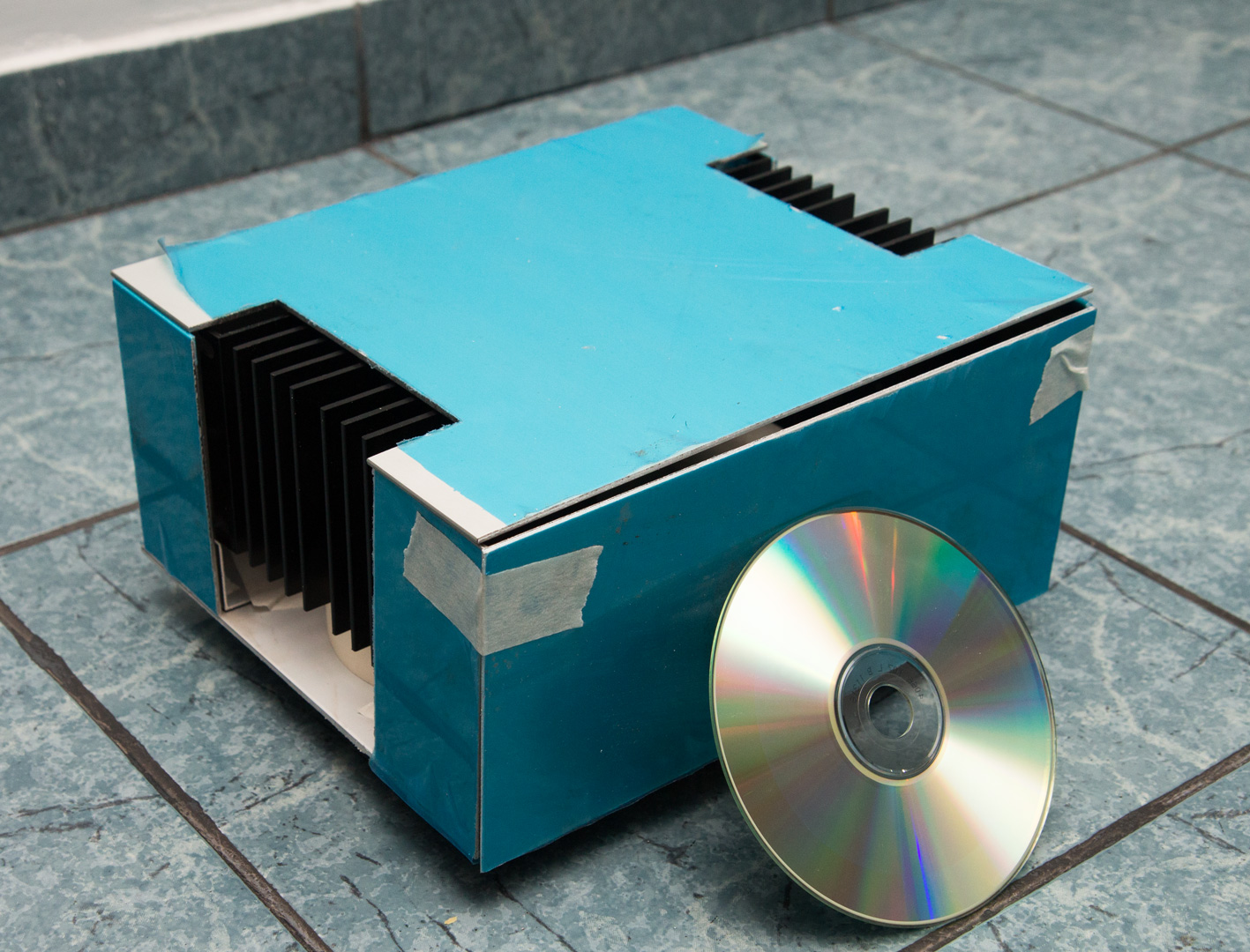

Here's the first day, just assembling the pieces with masking tape to make sure everything fits:

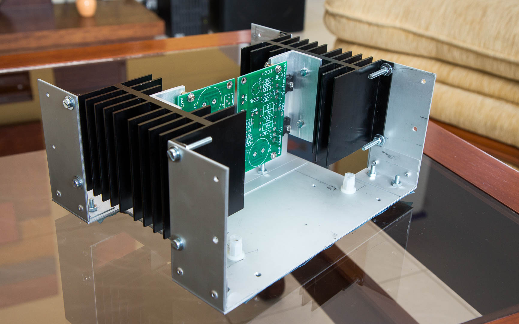

Here's the fantastic suggestion made here at the forum to allowing for the MOSFETs to be attached to the heatsink without the need for cables and other complex solutions. Thanks!!!
I decided to rivet some of the L profiles... this results in a side that looks like a showcasing of all the different types of bolts and rivets one can find. Not really happy with that, I may end up just replacing those with hex bolts as well:
To avoid bolts on the top and front sheets, I went for gluing the profiles to those sections. That was a really life saving decision, as perfect matching of the holes would have been a headache. This way, there is one section with holes, the other is just 'hand positioned' and then glued to the Ls. Now everything matches and is a bliss to assemble. Really happy with that decision:
Here's how the PCBs are positioned:

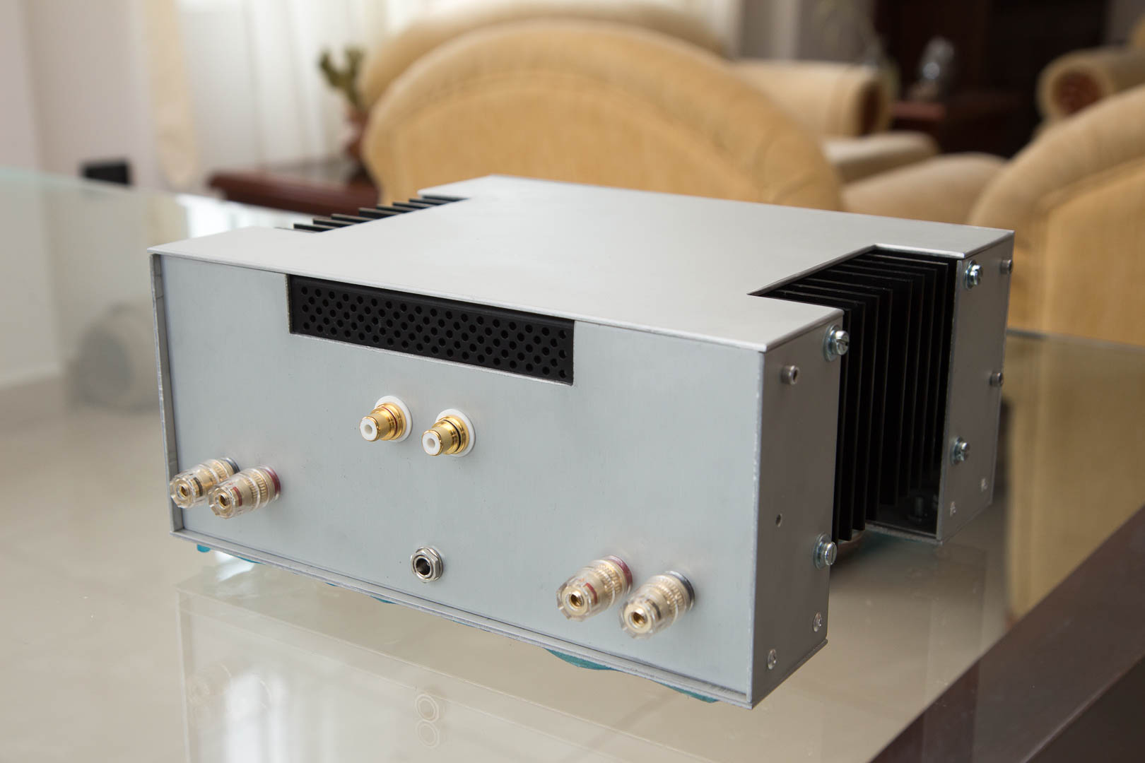

The case mostly in its final form, missing just the glass window with the name and logos:
Here's the back layout... I'm, for the time being, considering a front switch... still that is on the fence right now. We'll see:

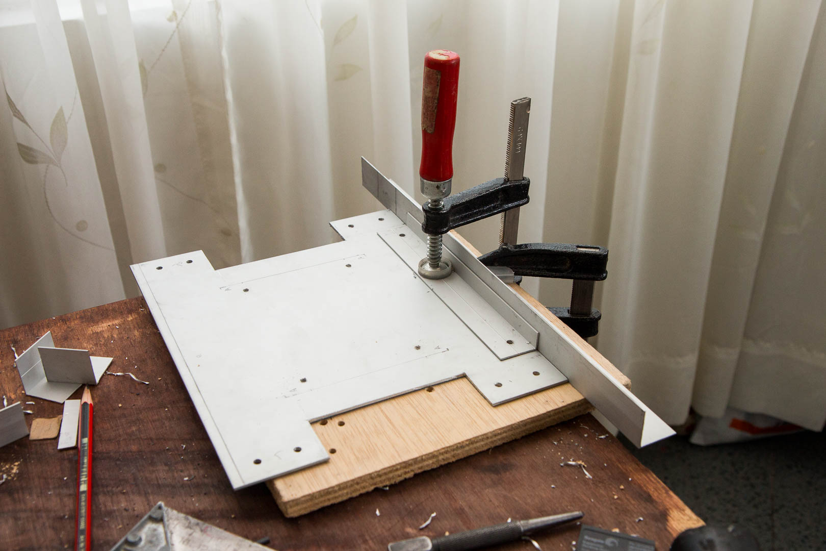

Drilling L profiles to allow proper assembly. Bending would have saved a lot of time, but I don't have the machine to bend 2mm aluminum, so I designed it that every piece was flat. Perhaps not the best idea, maybe taking the pieces to be bent would have been a more clever approach:

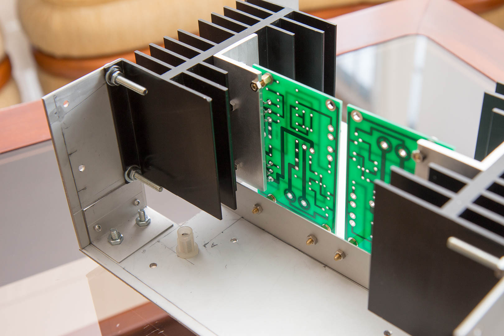

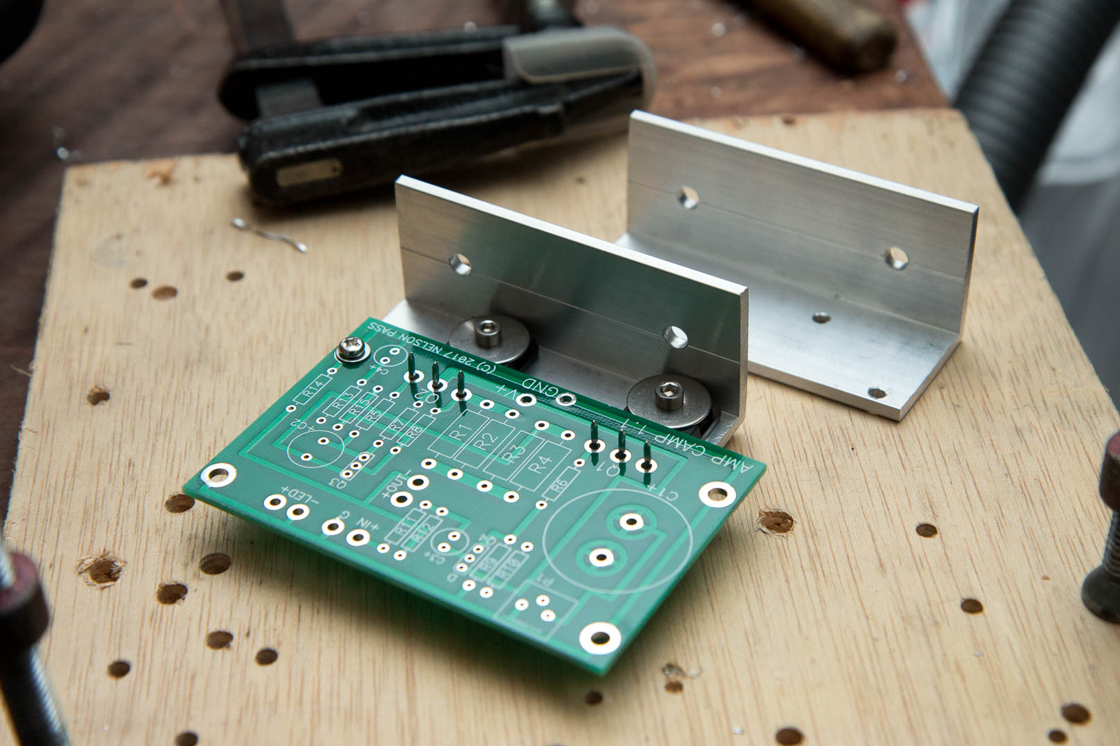

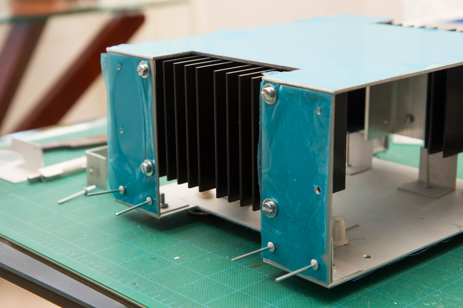

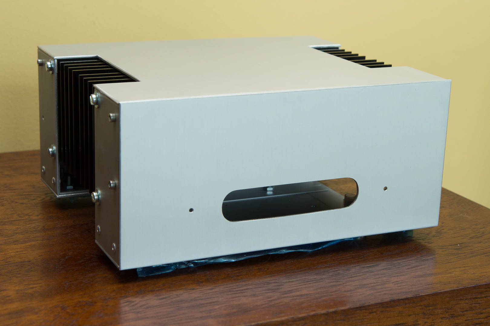

@Alan, I bought anodized Aluminum, so they have been with those 'plastic' protections up until two days ago. I just very gently rubbed them with WD40 and they get nice and shiny. Maybe this is not showing in the pictures properly. When I'm completely done, I'll disassemble all the case and give the exposed 'edges' a final sanding so they are nice and smooth, as well as with 'congruent' reflections (not sure how to explain this).
The inner parts that have been annotated in, I'll sand with a 400 water paper sand, and that'll be all. Assemble back together and that's it.
I'm still debating if covering the back panel with black vinyl (or paint?) to give the recessed panel (and the fact that it is holding the connectors) a different 'visual language', but that is also not yet clear at this point.

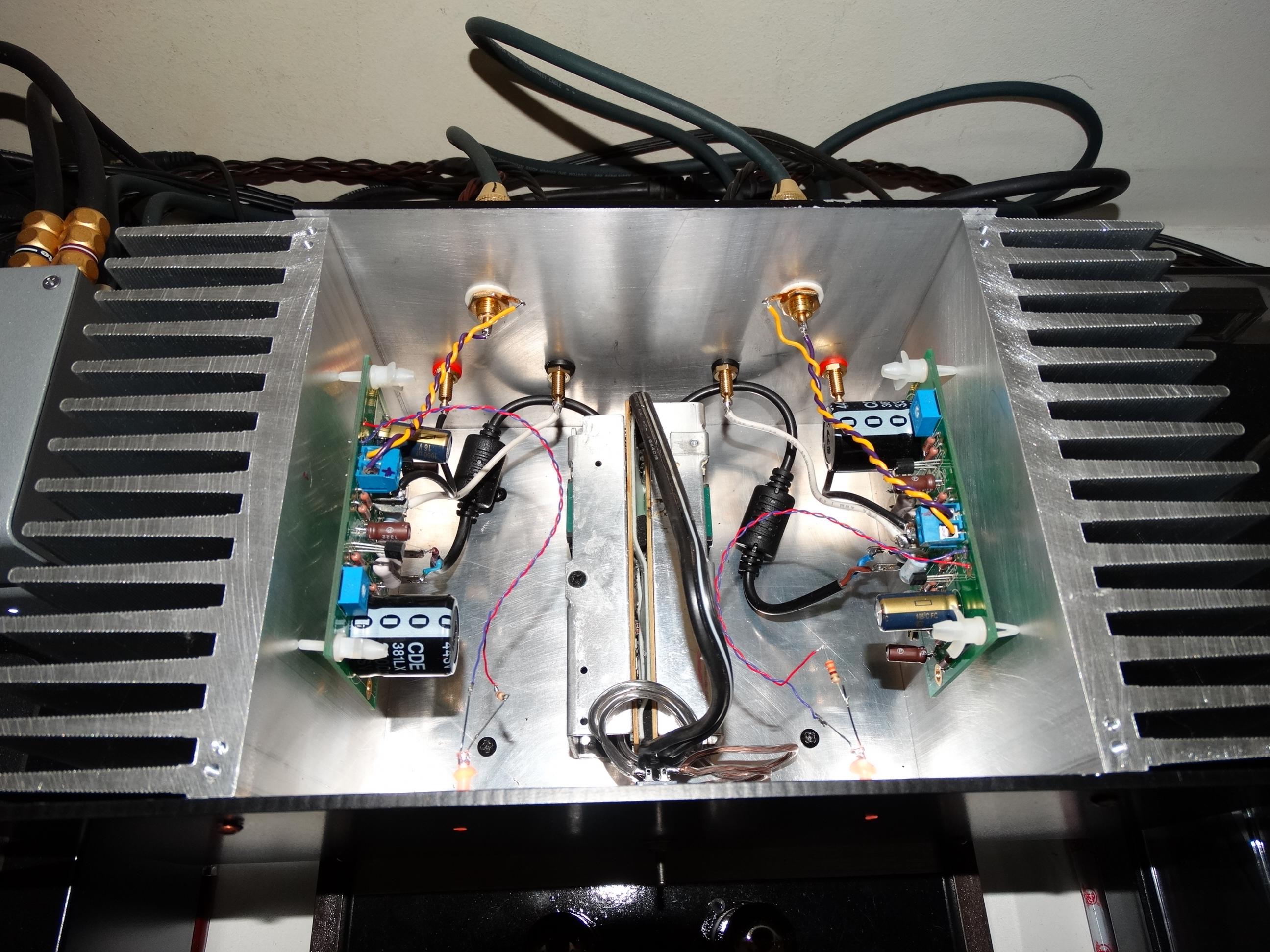

I wired the one in the guide as closely as Nelson did in the one he built. It’s quiet. The common buss is a convienent way to make a number of common connections.
What your dad says will certainly work and is worth trying.
I used the normal wire on the signal RCA because it’s included in the kit, a small coax would be better.
My guides are intended to be clear, well illustrated, easy to understand, and show an example of a way to get the project working properly and quietly. There’s a number of ways to do that, “my way” is just one way of many.
