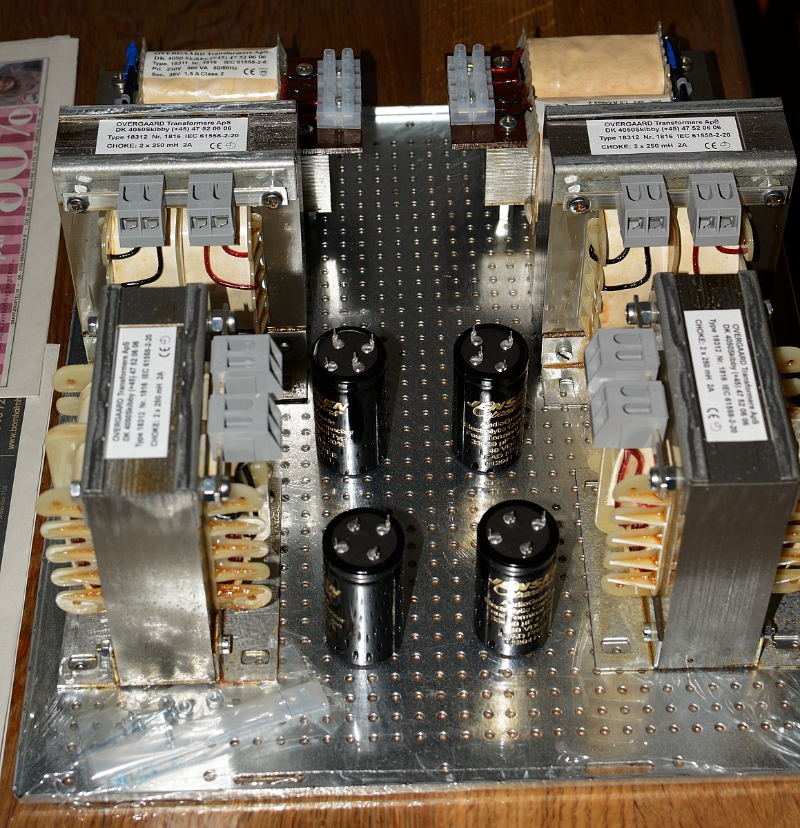

Yes, but it will take a while before everything is built but I have a constant progress. Sometimes the progress is just a new idea or a way to mount things.
I got a Pesante chassis with the extra base plate for the 2x 24V linear PSUs. As you can see from the pictures everything fits at the base plate (300VA UI trafo and 2 x (2 x 250 mH) chokes pr. side. The problem is that the about 40 kg iron is way too much for such a chassis. If I try to lift the base plate it bend like paper. Even components for at single PSU seems to be too much stress. I need 3mm steel plates for this. Maybe "rifle grade" steel.
The way to go is to built the PSUs on wood.......I think.
I have just taken the ideas from the double Lundahl chokes and use the serial connection af the chokes which Lundahl describes "for better common mode rejection" (used it for a tube HV PSU). But it is important to couple the two chokes rigth so the DC will drive the flux in the same direction in both chokes opposite that was a common mode choke does (as far as I have studied).
Lundahl describes the different ways the double chokes can be coupled and the winding direction is also marked. So everything it "transparant" on how it is done.
http://www.lundahl.se/wp-content/uploads/datasheets/2742.pdf
If it is not done right the choke will just be an expensive resistor (as Eduard wrote to me after having "talked" to Lundahl).
