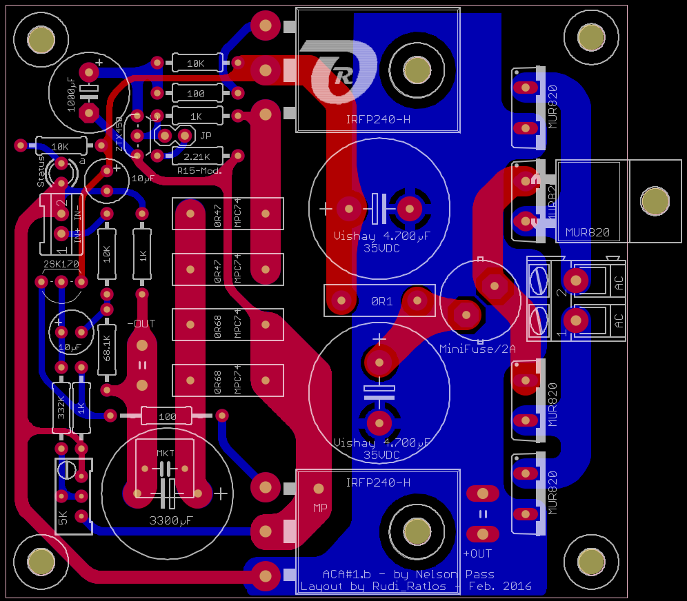

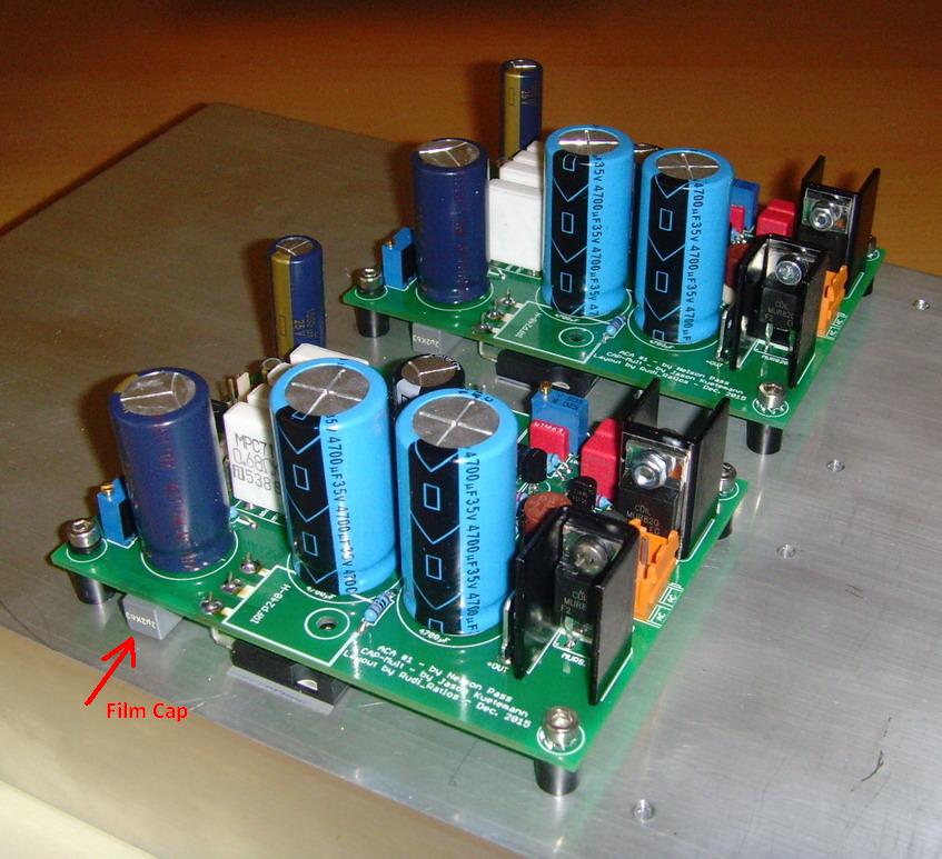

Has anyone else put some film caps in parallel with C1 and C2? I just used some I had laying around (Hovland Music cap 3.3uf on the 3300 and ClarityCap PX 1.0 on the 1000) and I think the soundstage, upper frequency registers are better - noticeably better.
@all212: the film-cap across the 3.300µF that I have soldered, is meaning only a very small improvement in sound.
If you want to listen to an ACA "at its best": give it a 24-25VDC PSU.
For example the one shown below.
You only need a dual 18VAC secondary - transformer (rated at 120-160VA) to connect to the ACAs.
At what voltage are you operating your ACAs?
Best regards - Rudi

The ACA doesn't require matched 2SK170's as each monoblock only uses 1. Is it OK to use cheap 2SK170BL ones from China? 40 in a bag for $7.
Original free shipping 2SK170BL 2SK170 K170 TO92 40PCS/LOT in Stock-in Integrated Circuits from Electronic Components & Supplies on Aliexpress.com | Alibaba Group
I know, a crapshoot... I actually have two real ones I bought from Linear Systems but that order for two with shipping cost the same as 40 from China!
