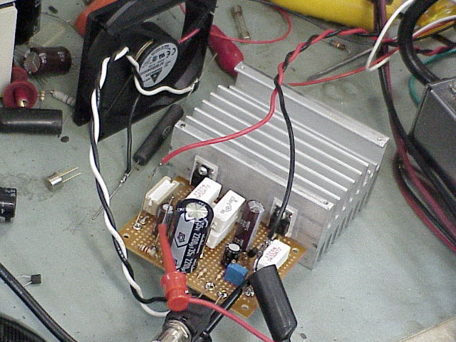

I built one channel using IRF640s, a 2N3904 and MPF102 (Idss=11mA). The only deviation from the ACA1 schematic was a 0.1 ohm resistor in series with the source of Q1. To measure open loop gain I just look at the gate of Q4 with a scope. Gain was 20 (26dB) with the 0.1 in place and 23.1 (27dB) with the 0.1 bypassed.
Looking at the IRF data sheet, the Gm is very non-linear at 1 amp. Isn't there a better part? This amp biases Q1 pretty hot, but that makes it more linear.

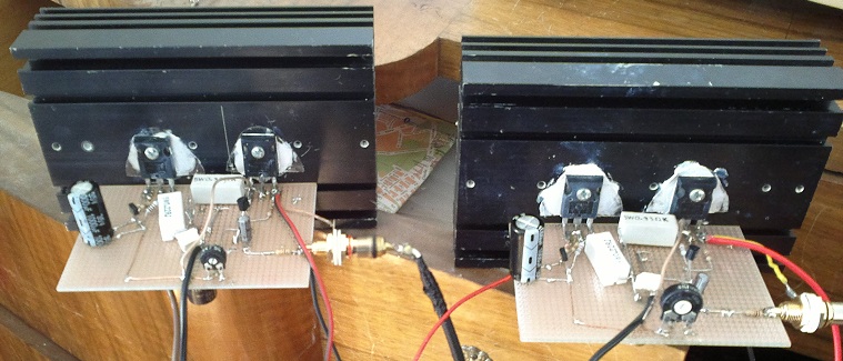

A pic of the proto ACA I did build here .
They are in 2 sided board style , p2p , with IRF044 , works great .

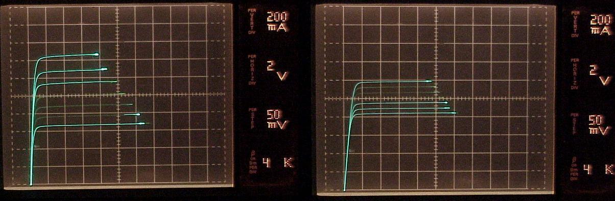

I looked at an IRF640 on the curve tracer using offset to get smaller steps around the (about) 1 Amp operating point. The second plot is the same part with 0.47 Ohms inserted in the source lead. The gain goes down but the linearity increases. I have no control over the camera shutter speed so some of the traces are fading out.

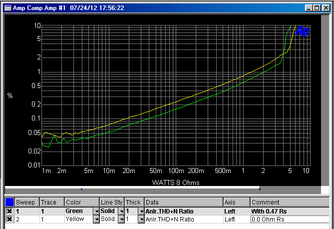

I replaced the MPF102 I was using with a PN4393. It gave slightly lower distortion numbers. Then I installed a 0.47 Ohm resistor between the Q1 source and ground and ran distortion plots with and without the source resistor. The distortion is higher above 4 Watts because of clipping, but at lower levels the distortion is lower inspite of the fact that the open loop gain is lower. Open loop gain measured 29.3 dB with the 0.47 shorted and 23.2 dB with the 0.47 enabled. DC operating point was adjusted to 10V at idle for each test.
Square wave response of the amp is very well behaved.

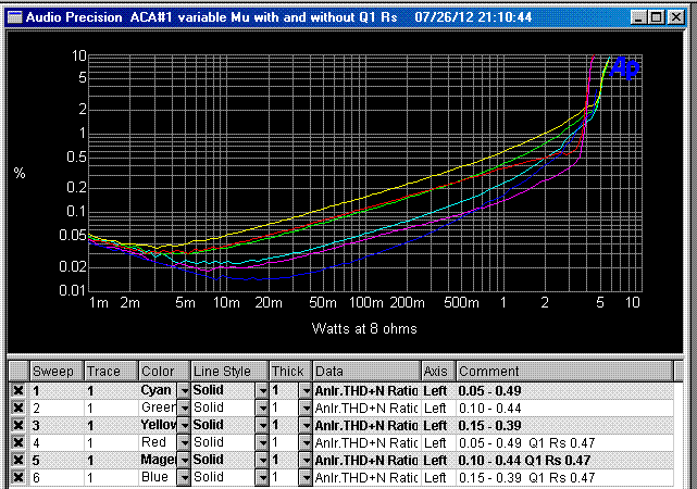

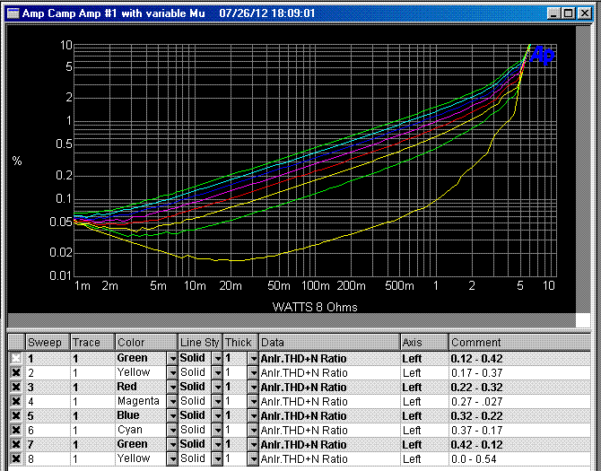

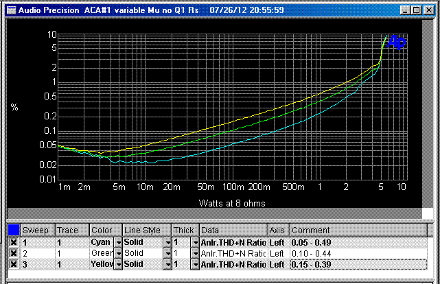

That was in reference to a question about R1, R2, R3, R4 and their ratios. (I'll just refer to them as R1 and R3.) I made a resistor string with a 0.12 ohm on each end and six 0.05 ohm resistors in between. Total resistance 0.54 ohms. The first attachment shows distortion plots. The comments are the two resistor values in order R1, R3. The surprising thing was that the lowest distortion was when R1 was zero! Looking at the analyzer output though, there was a lot of 3rd and higher harmonics. At any other position the distortion is a nice sinewave at 2x the frequency up to about 4 watts. (I didn't try R3 = 0.0 ohms.)
To investigate this I re-arranged the resistors so that all the 0.05 ohmers were on the Q2 source end and plotted three more curves in the second attachment. The third attachment is the same as the second but with three more curves with the 0.47 ohm resistor between the Q1 source and ground.
