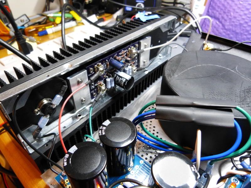

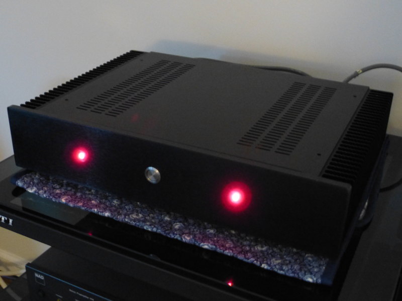

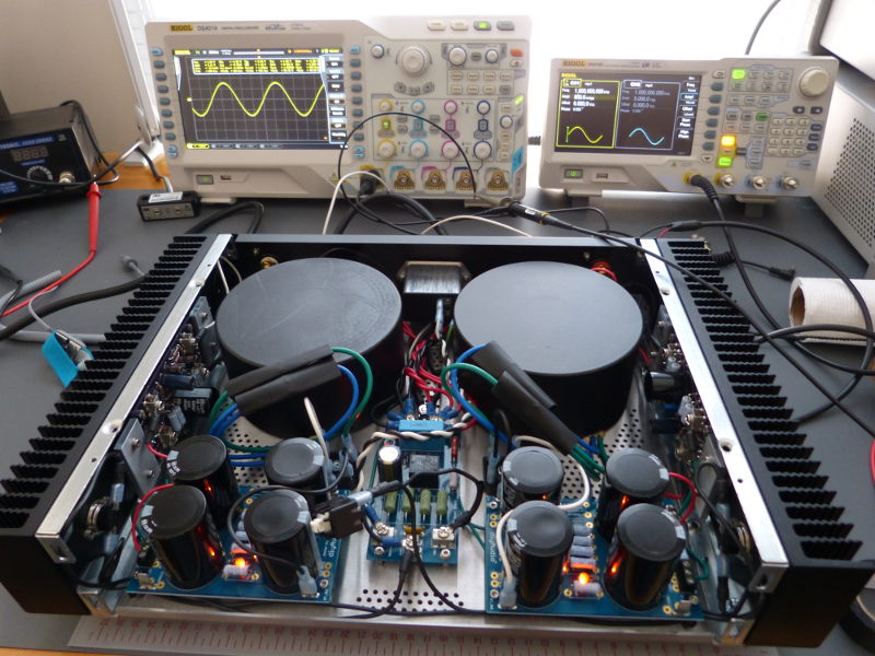

Late to the party but...
Not sure if I should post here or in the general amp pictures thread, but this is pretty ACA specific so here goes...
Here's my version of the ACA based on a custom PCB that orients the FETs differently. Dual mono, 200VA 15V Anteks (this combo produces exactly 19.0V) and shields with diyaudio soft start and CRC filter boards with 15KuF caps. Standard Vishay 35A potted rectifiers. All deployed in a modified ModuShop 2U chassis with 10mm front panel, 300mmX40mm heatsinks.
I modeled the entire chassis and all components in Solidworks and then had the front and rear panels and heatsinks machined. I also designed a thicker base plate to help take the weight of the transformers and had it manufactured in small quantity. I think this baseplate will fit any of ModuShop's 300mm deep chassis but I know for sure it will fit the 2U. The parts are literally a swap.
How does it sound / work?
I'm most impressed with the high end. I have to say I'm hearing details in my music I hadn't heard before and I also find it far less fatiguing to listen to this amp with my nearfield monitors vs. my commercial NAD 2200 (BJT from the 80's). Hard to explain, actually, but it sounds amazing.
Heatsinks run roughly 109F at their hottest spot around Q1. Around 105-107F elsewhere. Each PCB draws 1.4A as verified by my bench supply during early testing / biasing. Soft start works like a charm...no dimming lights on startup. Kill-A-Watt shows 0.75A max peak on start with 0.65A @ 110VAC running.
Nelson, thanks so much for everything you contribute to DIY and for inspiring me to build this! You rock!
