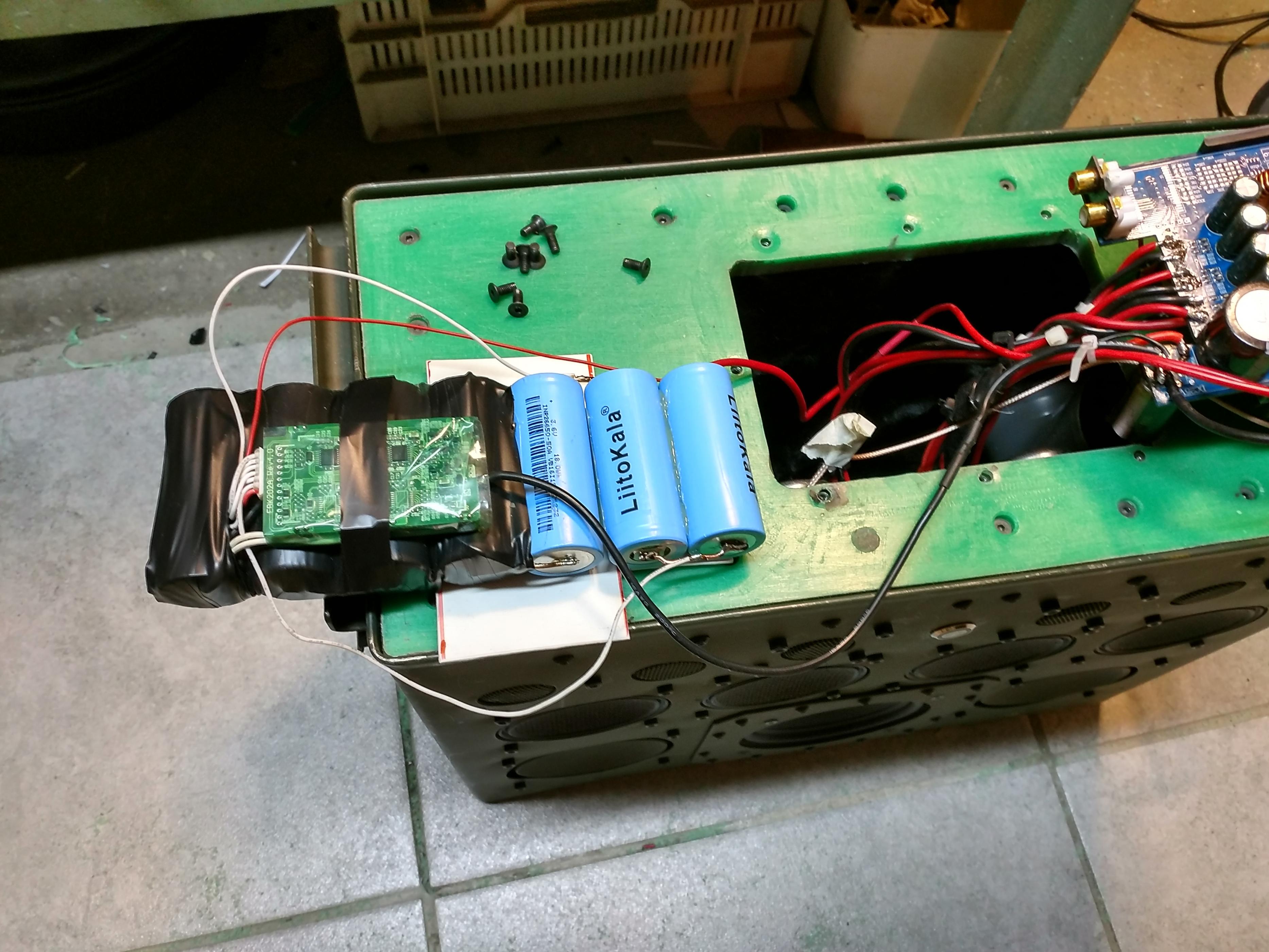

That is a sweet battery pack too. I also forgot to mention that I need to add protection to mine. I already killed one of my cells by leaving it on all night... argh!

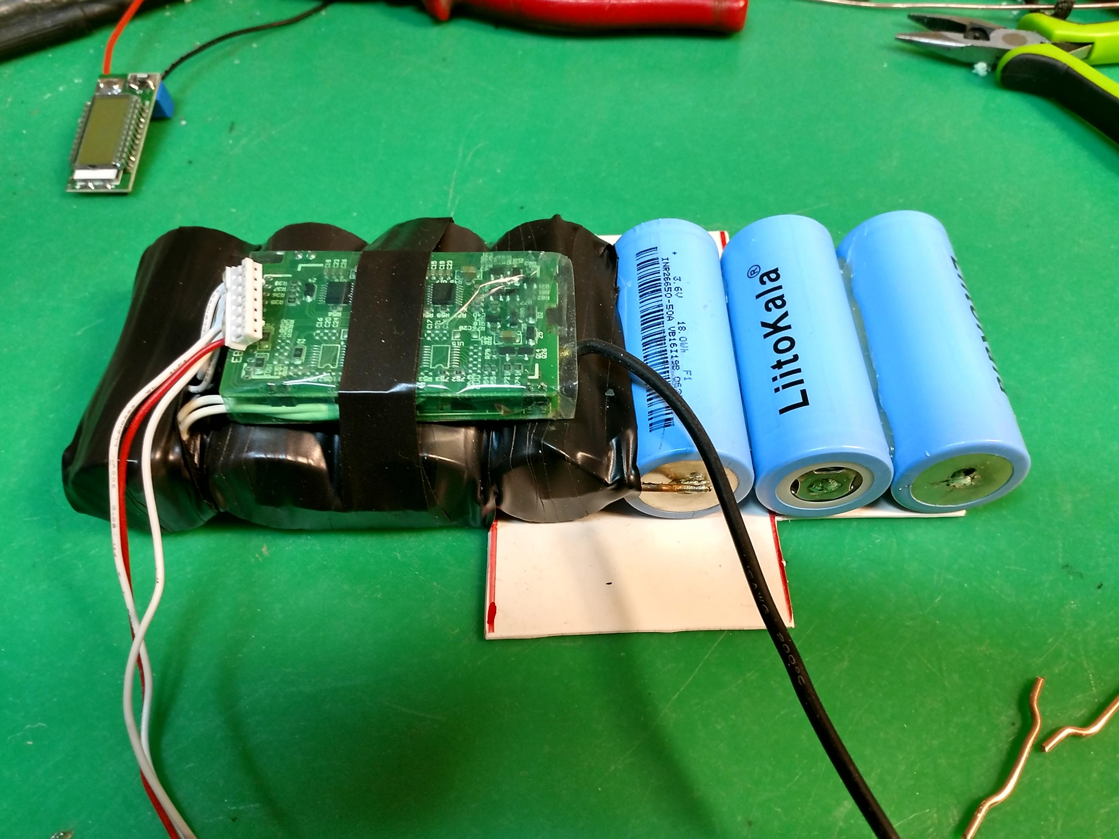

Just a quick update, this is the all new 29,4v , 5ah battery made of liitokala 26650's . After I tested it, it was all warped in black electrical tape , the white plastic piece at the bottom is a lighter mounting bracket that screws down to back wall inside the speaker.

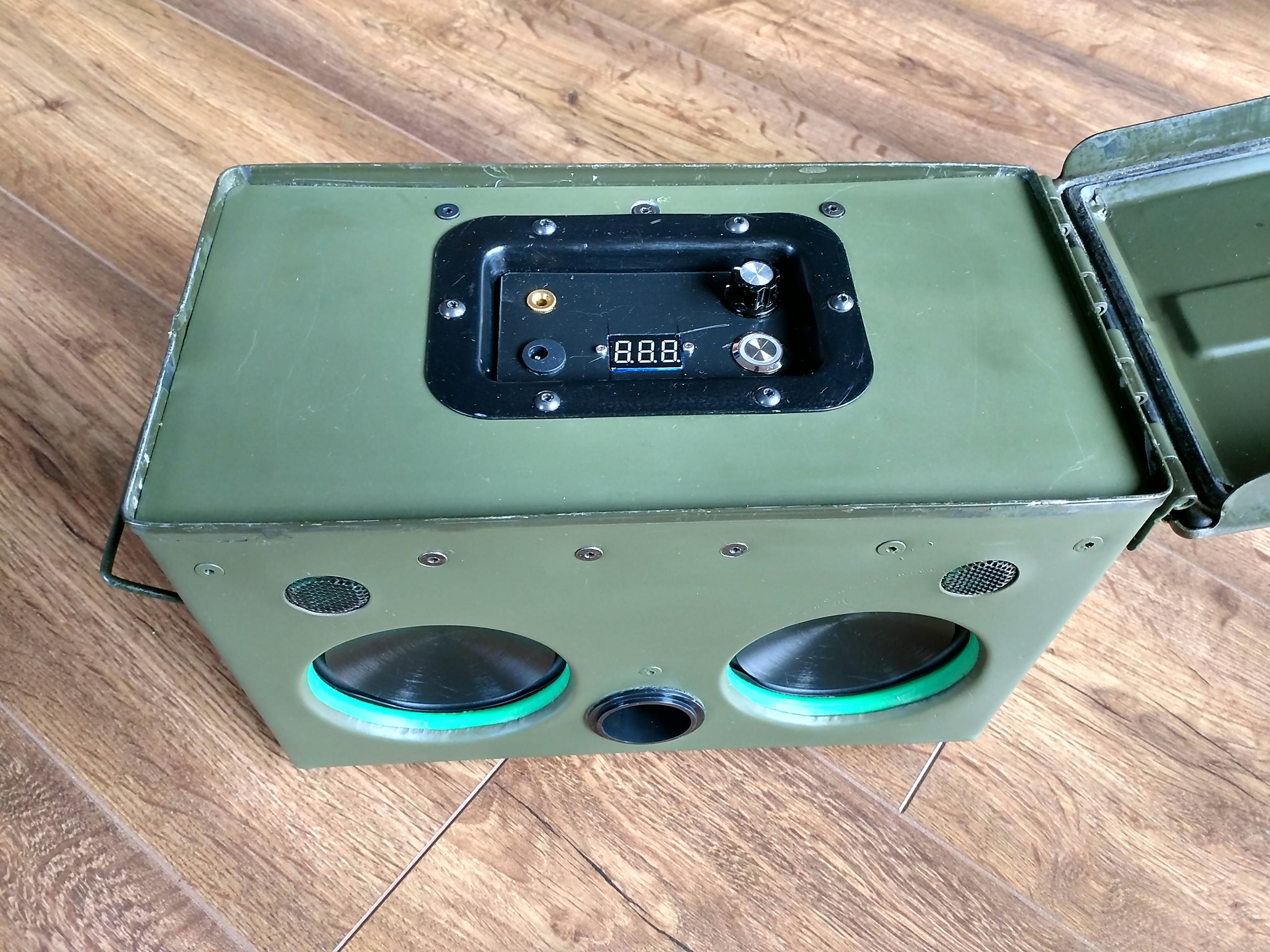

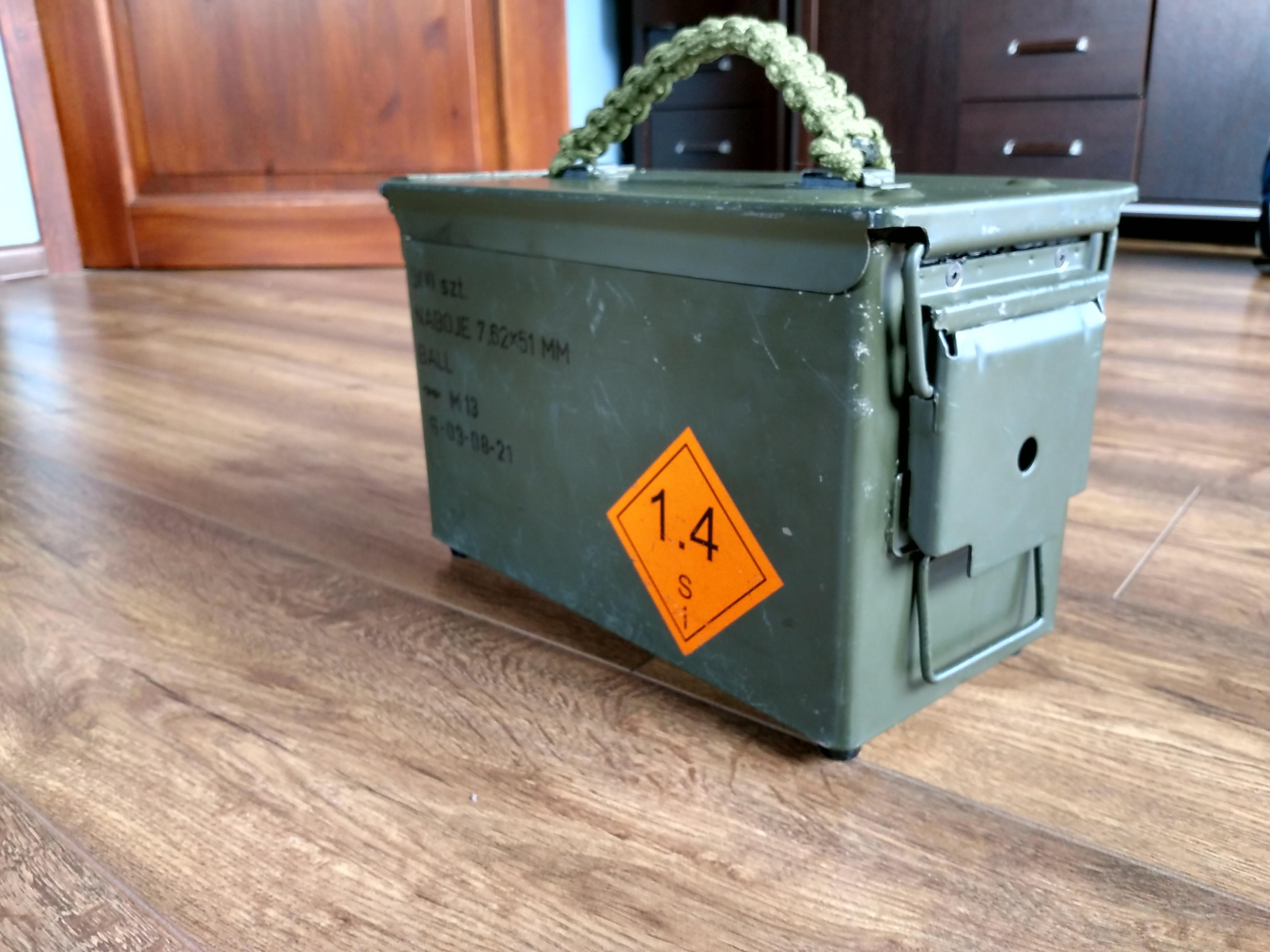

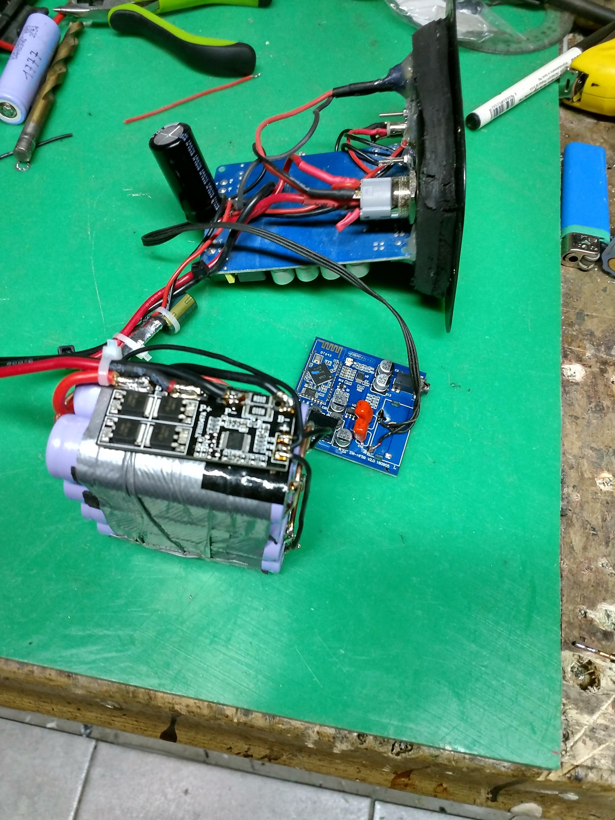

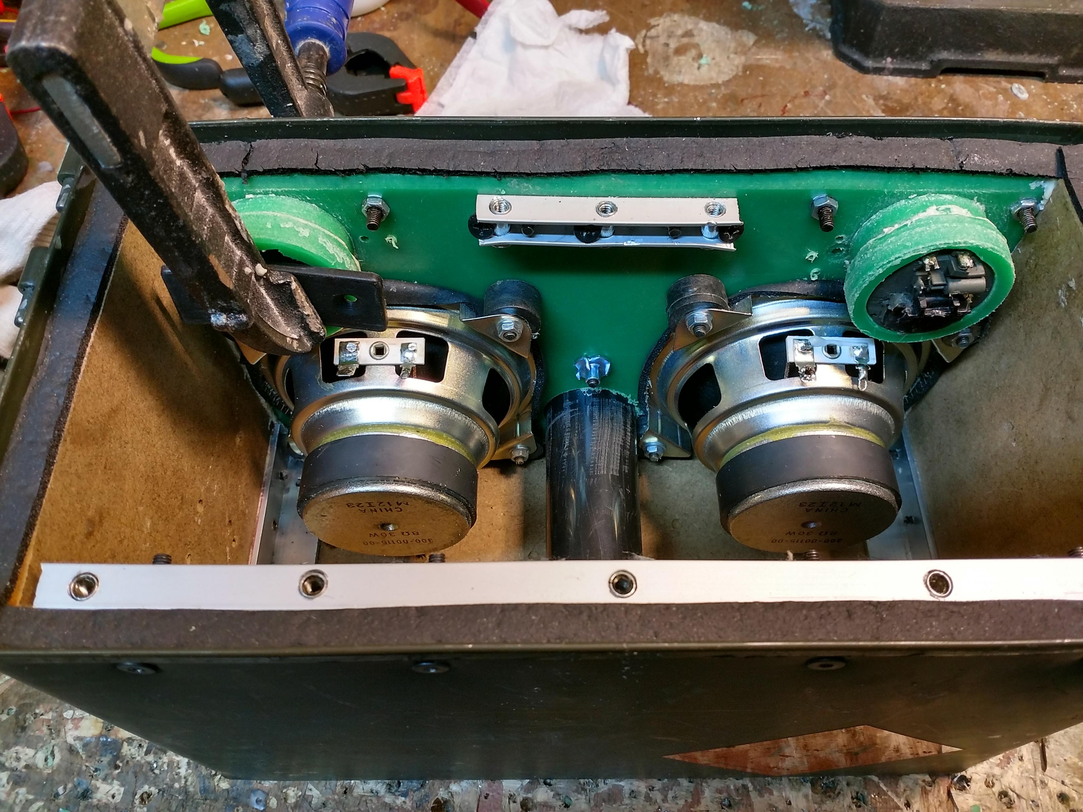

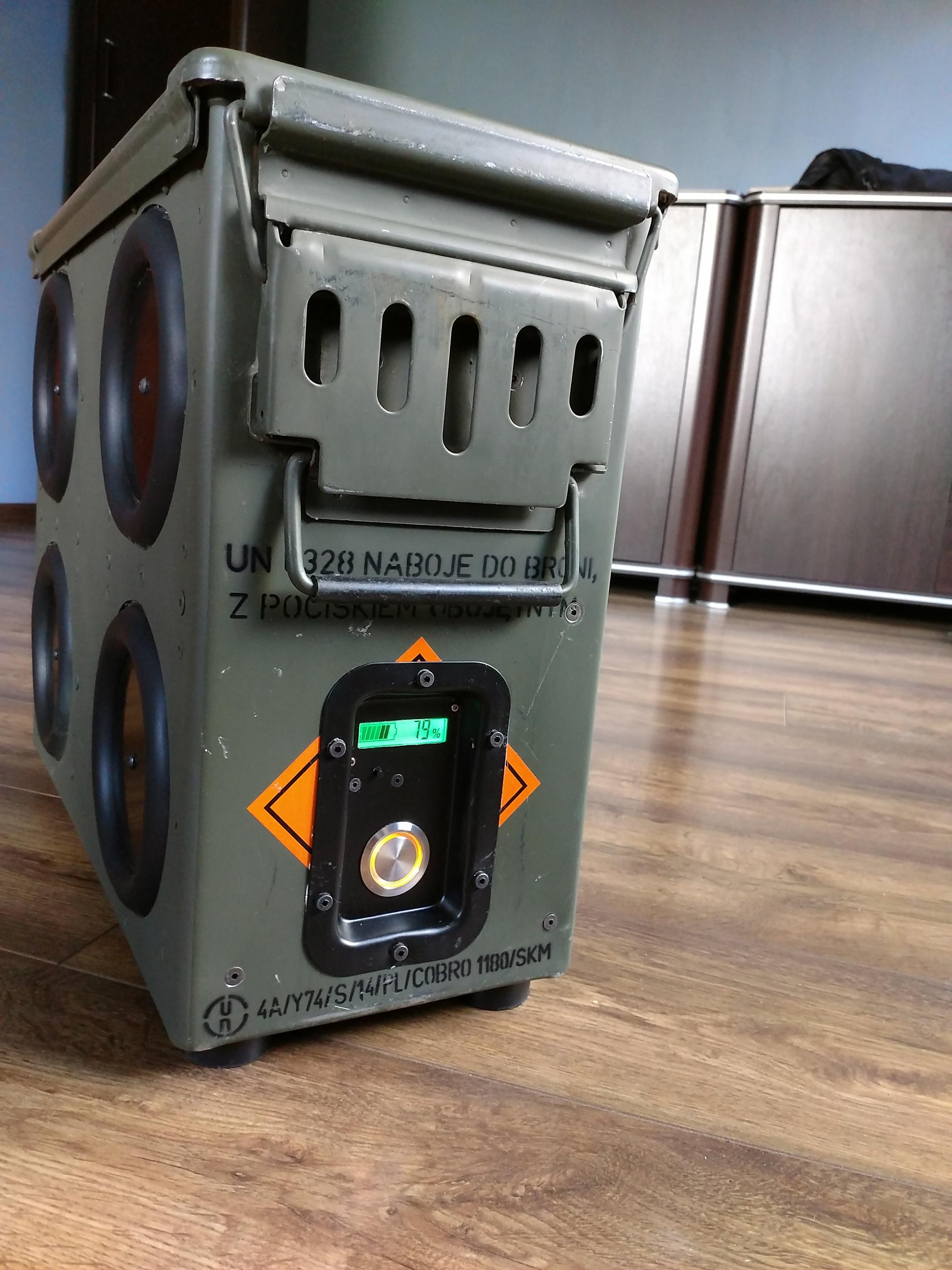

I've got one more small ammo box to share , it's probably last I will ever make. This time there are no coaxial speakers involved because person who ordered this box doesn't like te coaxial speaker look , so I've come up with something like this.
Specs:
TDA 7498 Sanwu blue board
16,8v , 4s battery made of samsung icr18650's
Bluetooth 4.2 CSR64215 Sanwu
Silk sof dome tweeters -ebay find
Phillips woofers -ebay find

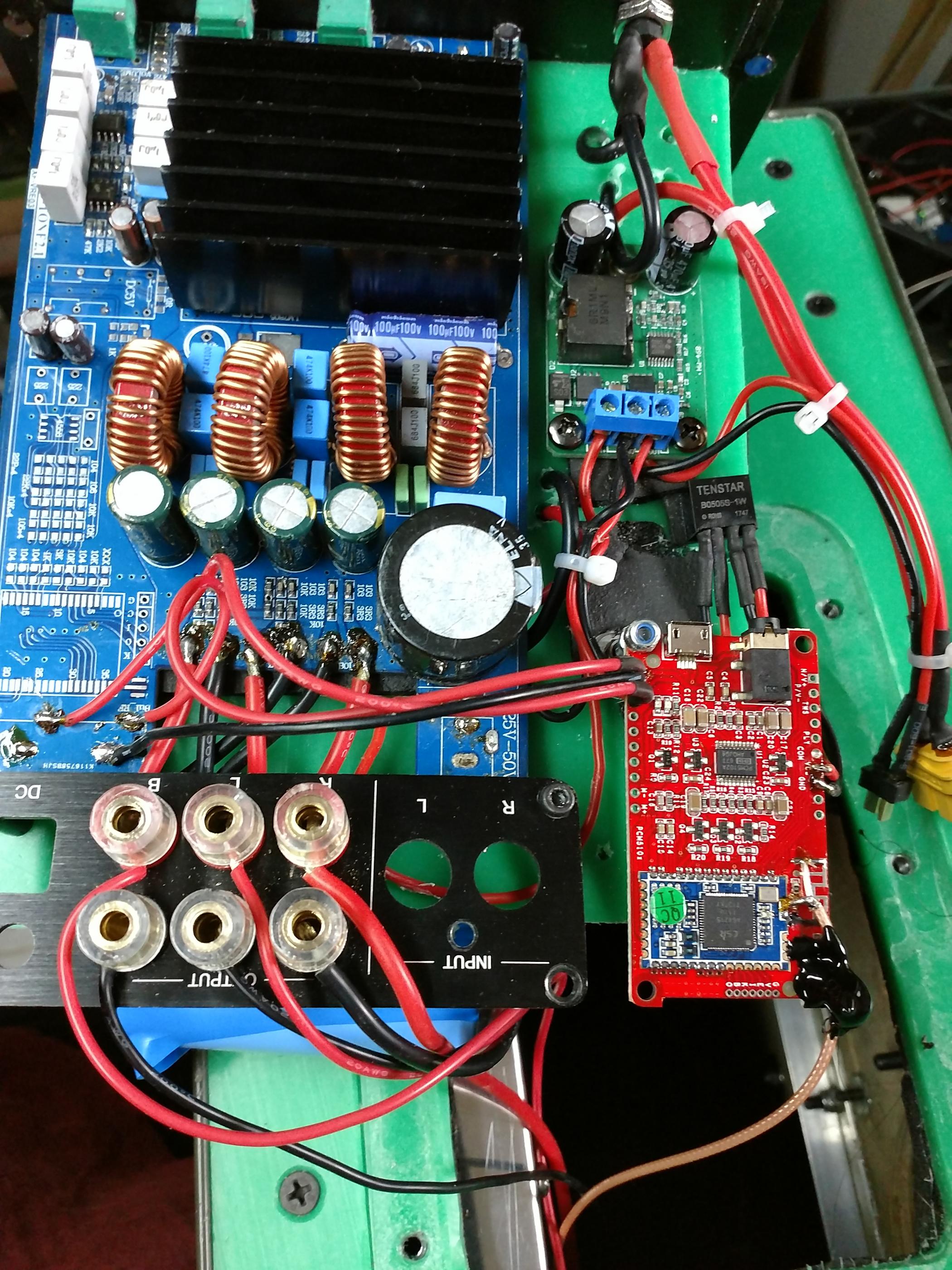

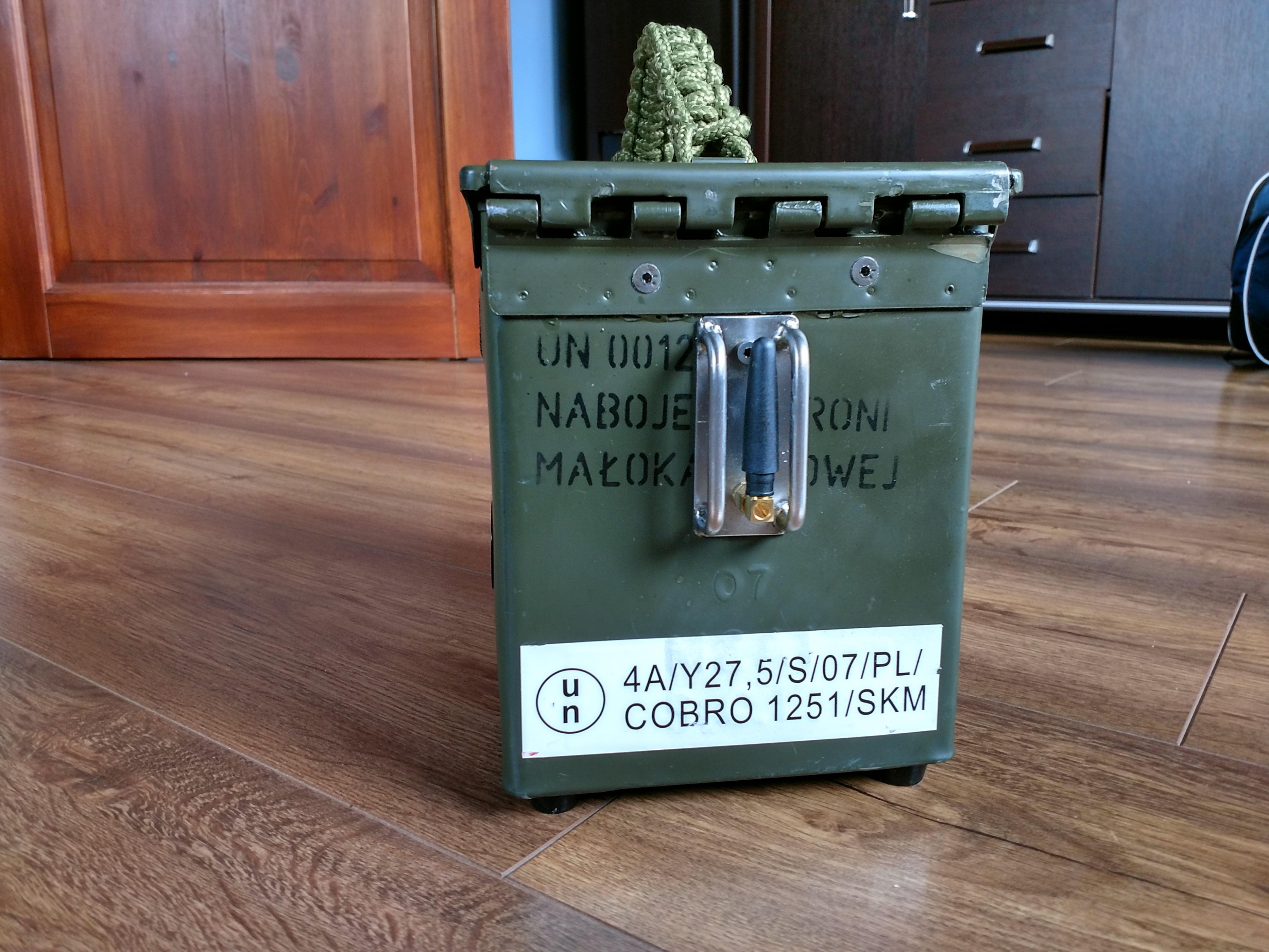

Very cool! Again I like the flared speaker openings! And the BT antenna guard is very nice.
I'm curious how you fed the BT module? Isn't that 5V?
Come on! You gotta keep making them! LOL

BT module gets 5V from step-down DC converter it's zip-tied to main power cables , it's visible in the photo this blue Sanwu board has it's own DC-DC isolated converter so it limits the ground loop noise effect from step down converter.
Board has it's own pdigital output for antenna .
Sanwu BT : HIFI Bluetooth 4.2 Stereo Audio Receiver Box CSR64215 Digital Amplifier Board Z09 Drop ship-in Amplifier from Consumer Electronics on Aliexpress.com | Alibaba Group

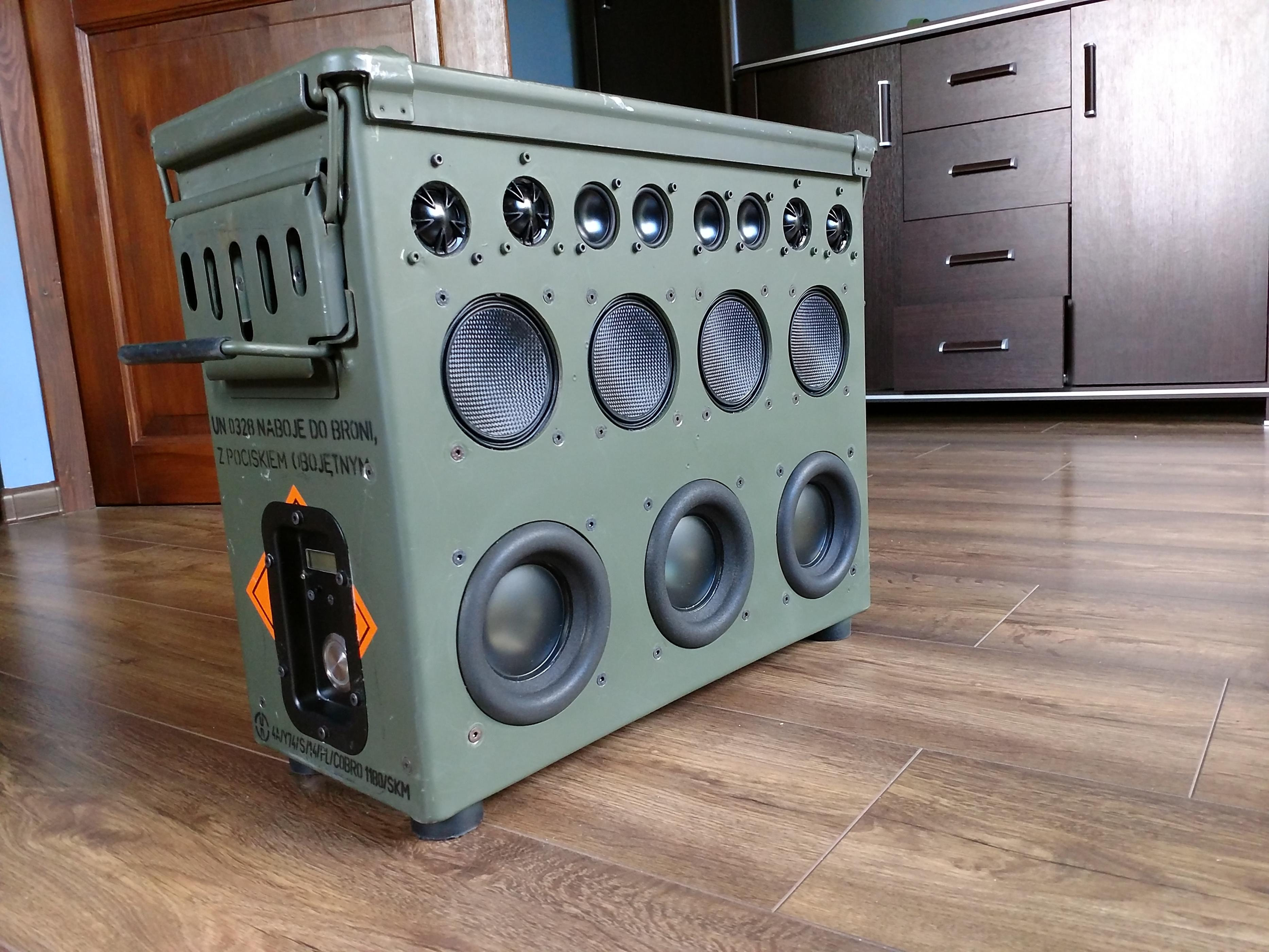

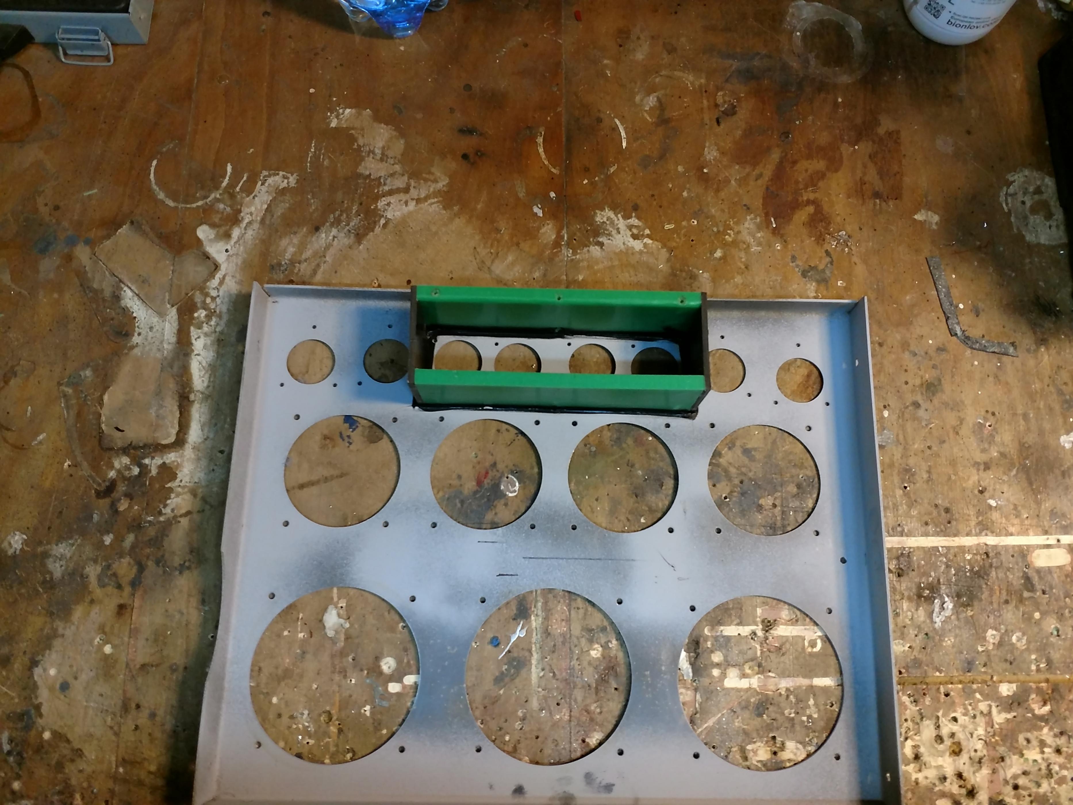

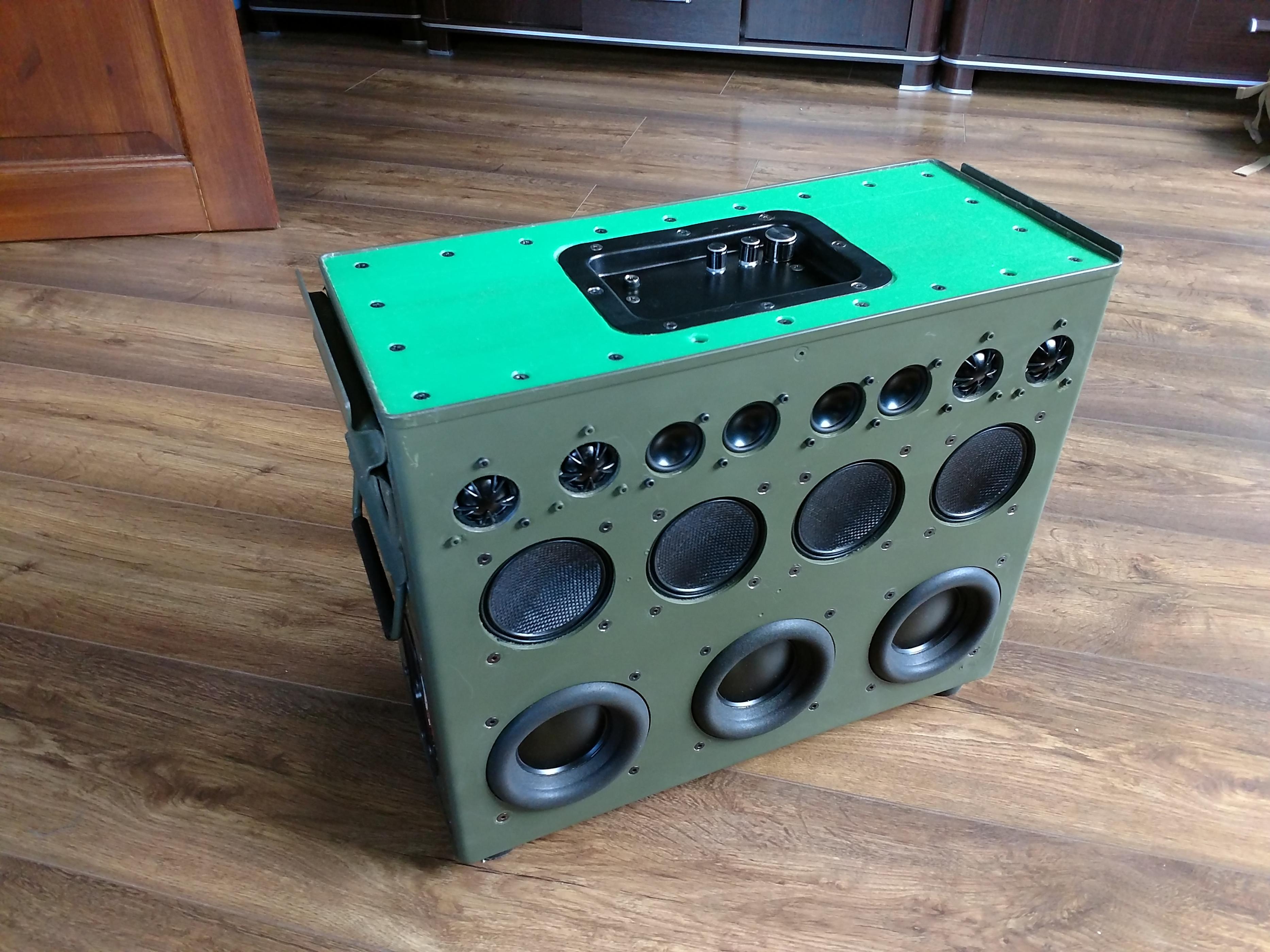

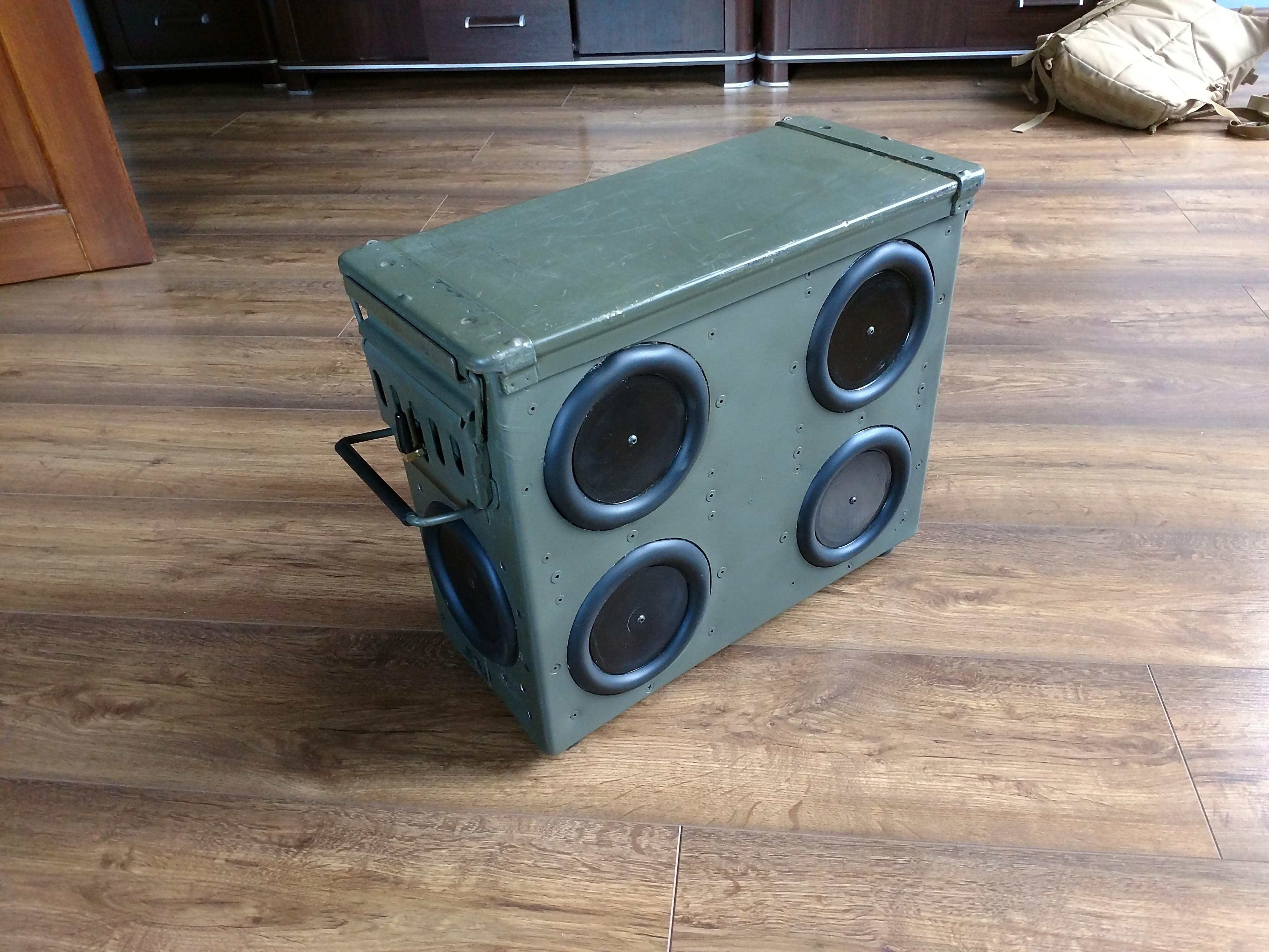

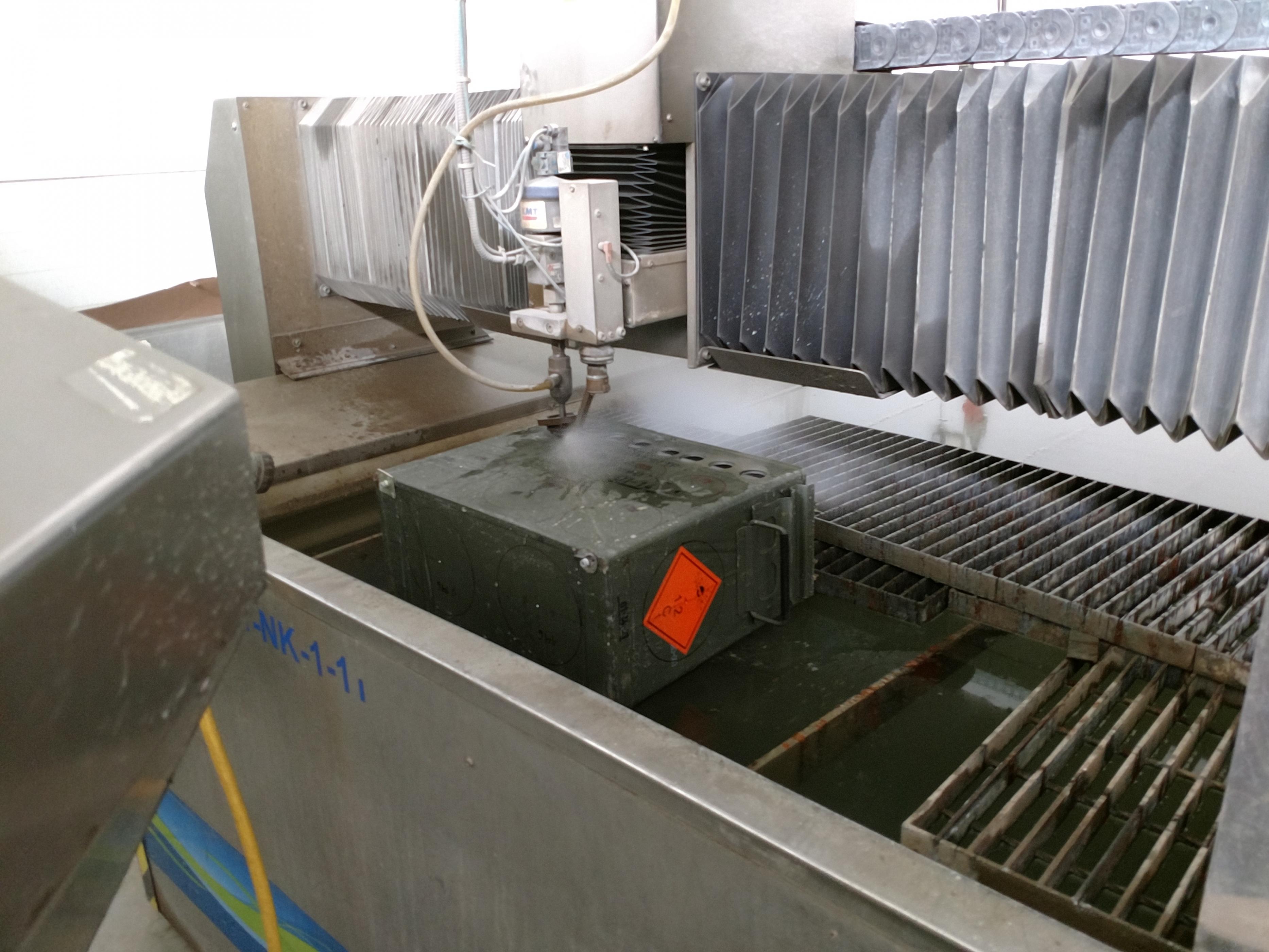

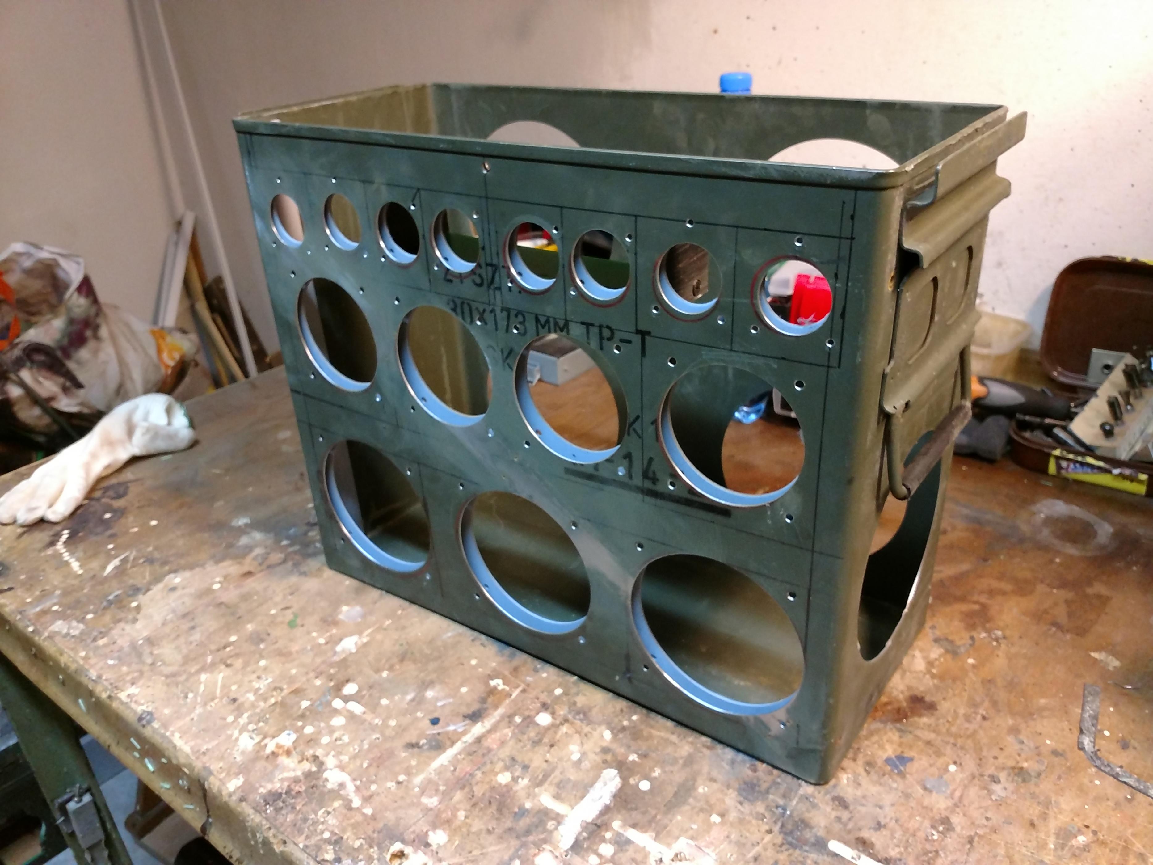

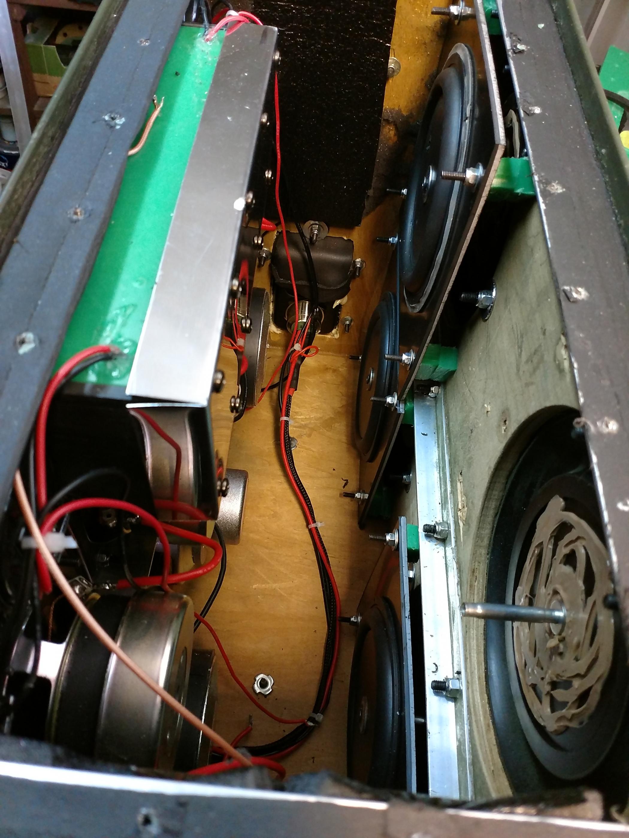

So there is one more box I would like to share , once again it's made of largest ammo box I could find. In terms of internal construction its made of hybrid 2mm steel sheet and reinforced 10mm plywood box. Speaker wise there are four , 2inch fender soft dome neo tweeters , four 2ich aluminium mid deivers , four 3,5 inch sony carbon woofers and three 5ich bose richbass woofers. Whole thing is powered by 29,4V lipo with bms and tas5613 amplifier with csra64215 and PCM5102A DAC bluetooth module combo. On the back and left side you can find five passive radiators, 146 mm outer diameter each.
Sound wise this one definitelly beats previous one , base is deep, punchy and over all very satisfying , highs and mids are quite decent also definitely more present and defined than previous one.Only If You stay below 70% volume altough over all it sound great there is one fatal flaw to the construction of the speakers , the pasive rads surface area is to small and you can't realy crank the volume all the way.
