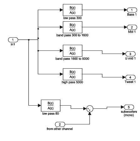

In brief the plan is
tweeters: 5kHz and up, spaced such that a 1 sample delay can be used in a RACE like filter (no strongly audible response artifacts). For my listening distance the spacing is 40cm (i.e. both 20cm from the centre)
upper mid: 2kHz to 5kHz spaced 4 times as much, again the filter need not have any strong artifacts
mid: 300Hz to 2 KHz: spaced 9 times as much as tweeters
bass: no ambiophonic effect applied below 300 Hz (described later).
The filters were generated using MATLAB following the recipe hinted at at ambiophonics.org. In the first approach (which is quite good but not perfect) the "crossovers" applied to the speakers were put in the simulation. This leads, as might be expected, to some peaks and notches - some refinement work is needed.
The impulse response from MATLAB was entered into the stereo-convolver Foobar2000 DSP plugin.
So the RACE filters, done with a "loss" factor of 0.7 (also tried 0.85 for the Mid), had delays of 1,4,and 9 samples for the 3 bands (they don't need to be integer values, but it worked out that way).
The shocking thing is that this works tolerably well on 9/10 recordings, excellently on many, and sounds bad only on a few (that are usually not that good in stereo either). How is that possible when the tweeter for each channel is 60cm from the upper mid that is in turn 1m further out?
A large number of measurements shows quite a reasonable overall sound field throughout a wide spot near the middle of the room (where I listen). Nothing very remarkable about the peaks and troughs compared to the usual stereo case (differ in detail, but not really when taken as an ensemble - without statistical analysis!)

PC with Foobar 2000, stereo_convolver and crossover plugins. Output via Echo Gina 3g.
Channels and processing:-
Analog 1 and 2 go to Behringer ultradrive which sets the crossovers (and minimal EQ) for B,M and T. Analog 3 and 4 drives the UM amplifier. Digital 1 (mono) drives two subs via a home made DAC and a parametric EQ. The subs see the same signal, but one has a low pass, gain and phase adjust.

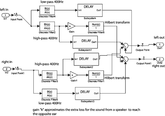

More ramblings: doing it "properly" now
I eventually got time to digest "Optimal Source Distribution for Virtual Acoustic Imaging, T. Takeuchi and P. A. Nelson, ISVR Technical Report No 288 February 2000" and made up the filter to do OSD correctly as per the original idea of those authors.
In very brief summary, the required transfer functions are Li to Lo = Ri to Ro = 1 (Li = left in etc.), Li to Ro = Ri to Lo = -i*g. Here i is the complex unit and g is an amplitude scaling factor to account for the left ear hearing the right speaker a little quieter than it does the left speaker.
Even with the animations at ISVR, I didn't find it all that easy to see exactly how this works, compared to RACE, which is why I hesitated to try it out.
Implementing the 90-degree (i) phase shift, i.e. a Hilbert transform, was done using a 151 tap FIR filter generated by the remez function in MATLAB (using the fdatool). The lower and upper limits (for the target function) were 100 Hz and 19kHz. The lower 1dB point came out about 200 Hz. These parameters were found as a result of trial and error - I did not want the filter to be too long, but felt that it would need to fit to better than 1dB over the important range.
A Simulink diagram, used to generate the 2x2 impulses for the Foobar2000 Stereo Convolver contained the following:
4th order low and high pass at 200 Hz, low passed signals are fed straight through to the output summation, high pass signals go through the OSD matrix.
The OSD matrix is as follows:
Li to Lo (etc.): simple delay of half the Hilbert FIR filter length.
-Li to Ro (etc.): gain factor g followed by the FIR filter.
The outputs of low-pass, delay, and FIR, were then summed for each channel.
This also works! It is much easier to generate than the approximate RACE version I reported earlier (which needs quite careful choice of some parameters: I was a bit lucky first time round with it as it could have worked much less well with different crossover frequencies etc.).
The only adjustable parameters in the correct method are g and the LF cutoff (which is not all that critical, I think). I tried g = 0.95 and g = 0.85, independent of frequency. I think the former is better (but am at an early stage in evaluation). The truth is g should depend on frequency so I need to find a reasonable HRTF model to study to find a good choice of g. Suggestions gratefully received!
The speaker setup is (so far) exactly as described earlier (the positions are probably not optimum for the chosen crossover frequencies, but they are not far off).
Ken

Looking back I realise my description of how the speakers are set up is not all that clear. I'll try to adda photo later and here is a schematic diagram.
The crossovers are shown notionally, the sub and umid ones are done in Foobar2000 crossover (including delay correction for both, and there is parametric EQ and some other filtering on the multiple subs). The other 3 bands are done in a Behringer ultradrive box, along with a few parametric tweeks - the basic filters are about 4th order but of course it is not as simple as that.
The sketch shows the simplified idea, for 1 channel and the subwoofers.
Ken
Ken
