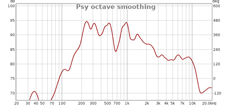

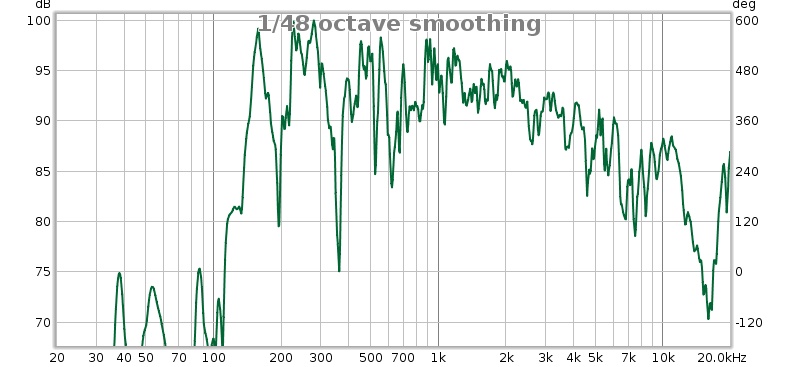

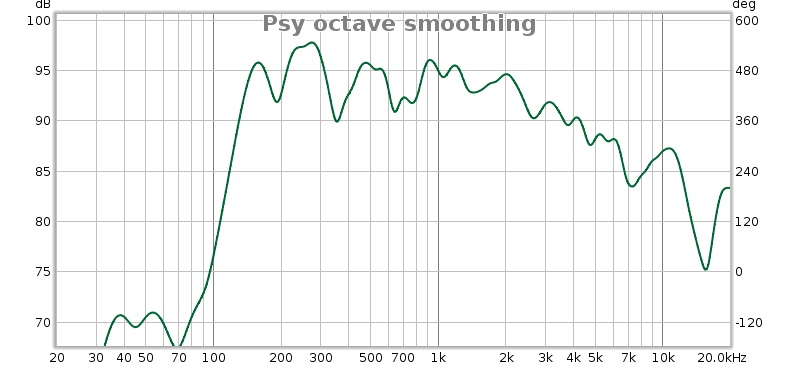

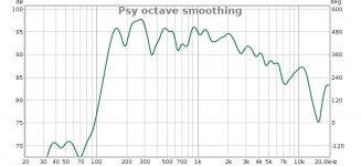

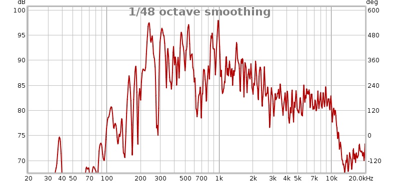

I did some measurements in room with UMIK and REW. The red line is listening position (psychoacoustic smoothing and raw) and the green line is near field top driver (0.5 m distance). I guess it confirms my impression of a non-agressive sound with the treble roll off.
These little boxes are just awesome to try different omnidirectional-like arrangements. I must definitely try also the 4 tweeter Sonab/Carlsson OA style speaker setup (placed around a top firing woofer) with them.

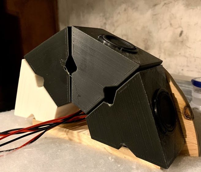

Today I finally did a quick and dirty test. I placed the ambient speakers to temporary stands. The effect is interesting and the speakers definitely add ambience. Now, without them, the sound seems a bit too dry, it is addictive. I have to play around with the level and also frequency limitations on the ambient speakers. I am really happy with the result.
Joined 2008

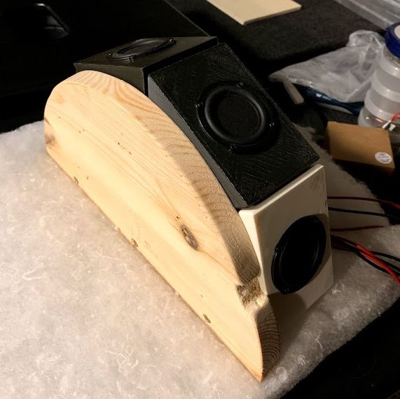

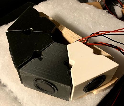

I made more permanent stands - as these will be placed behind the MF/HF section on top of a midbass horn. I used a leftover piece from a 12" speaker baffle cut out and a piece of 48 x 19 mm plank:)
