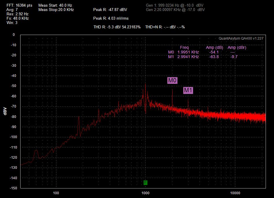

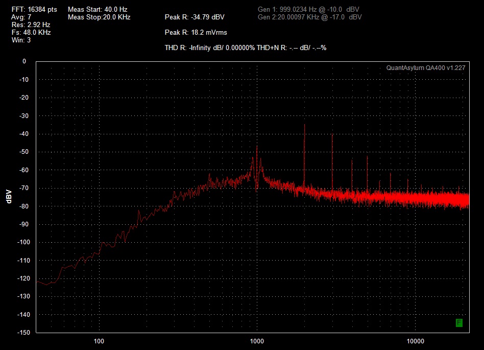

I had time this morning to install the Luna NSL-32 optocoupler and test it. Long story short, I reinstalled the CLM-8500.
Before installing the Luna I tested the 3501 analyzer with both the 3501 osc in loopback and the 339A oscillator. Before starting I went back in and set up the 2H cals for the 3501 oscillator using the QA400, this helped a lot. I had set this up a few months ago and it was < .0006% after I set it up back then. I knew that it had drifted some over the past months, today it was sitting at .00078%. After tuning the oscillator I was able to get the 3501A readings to .00058% in loopback. I then setup the notch filter again and now I'm getting down to .00051% (+/- .00001%) in loopback on the 3501. The 339A osc when measured on the 3501 analyzer actually degraded just a bit after I optimized the notch for the 3501 oscillator. The 339A oscillator is now measuring about .0004%. These readings are all at 1kHz, with the 400HP and 30kHz LP filters active and the 3501 osc level pot on the 0dB setting and the volume pot maxed out (1.2V out).
So after all the tweaking and tuning I installed the new Luna optocoupler. The best I could achieve with the Luna in place was .0008% when measuring the 3501 osc. The 339A osc only measured slightly better at .0007% with the luna optocoupler. I tried retuning the notch again but nothing would bring the distortion readings down to their original levels. After reinstalling the CLM8500 I was able to tune the measurements right back to their original levels.
I've included a few screen grabs of the QA400 showing the 3501 distortion residual. The first is the 3501 osc before I retuned it, the second pic is after retuning the 2H and notch. I'm able to get the 3501 oscillator's 2H down to < -50dB when tuning but within 10 min or so it drifts back up 3 - 4 dB to the level shown in the after tuning picture. For comparison I also included a picture of the 339A oscillator. You can see that the 3H is still a big problem with the 3501 oscillator.

I spent some more time today investigating the 3501 tuning in more depth. What I found is that part of the problem is that reinstalling the upper cover after tuning causes the oscillator's 2nd harmonic to jump up by about +10dB or more in my 3501. I believe this was part of the tuning drift that I was seeing. What I had to do to get around this is to lift the cover and slide it to the left just far enough to be able to access the osc 2H trim pots V2009/V2010. Doing this leaves the cover in close proximity to the upper board and minimizes the shift in 2H when the cover is put in place.
Doing the adjustment in this manner yielded a much better tuning of the 2H. See the attached picture. Compare this picture to the middle pic in post #30.
The other problem I have is heat related. The 2H drifts by about +10 - 15dB within about 10 min or so after the upper cover is reinstalled. If I remove the upper cover and let the heat dissipate for a few minutes and then reinstall the cover the 2H is right back where it was after the tuning. The largest amount of heat inside of my 3501 is coming from the transformer which was moved in the later production units inside of the main box. I will have to investigate either cutting a hole in the rear panel and installing a 50mm cooling fan or moving the transformer to an external enclosure. You folks with the early prod models with an external transformer housing are lucky in this regard. I;m thinking an ext transformer enclosure is probably the route I need to go.
