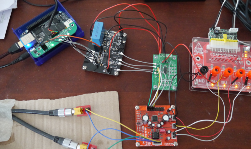

my temporary setup with a BBB
My temporary setup with the AKL-S03b with BeagleBone Black. I have re-purposed a OTTO-II as a u.fl converter while waiting for my custom u.fl board. DAC board is DIYINHK AK4490. No DSD output, that is waiting for the supercape to be finished.
Very nice there. I wonder the connector under P9, is for what purpose?My temporary setup with the AKL-S03b with BeagleBone Black. I have re-purposed a OTTO-II as a u.fl converter while waiting for my custom u.fl board. DAC board is DIYINHK AK4490. No DSD output, that is waiting for the supercape to be finished.
Your BBB adaptor does not seem from Acko, any detail is appreciated.

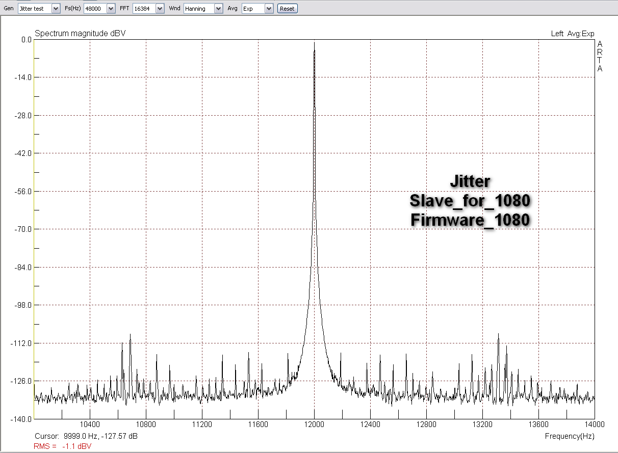

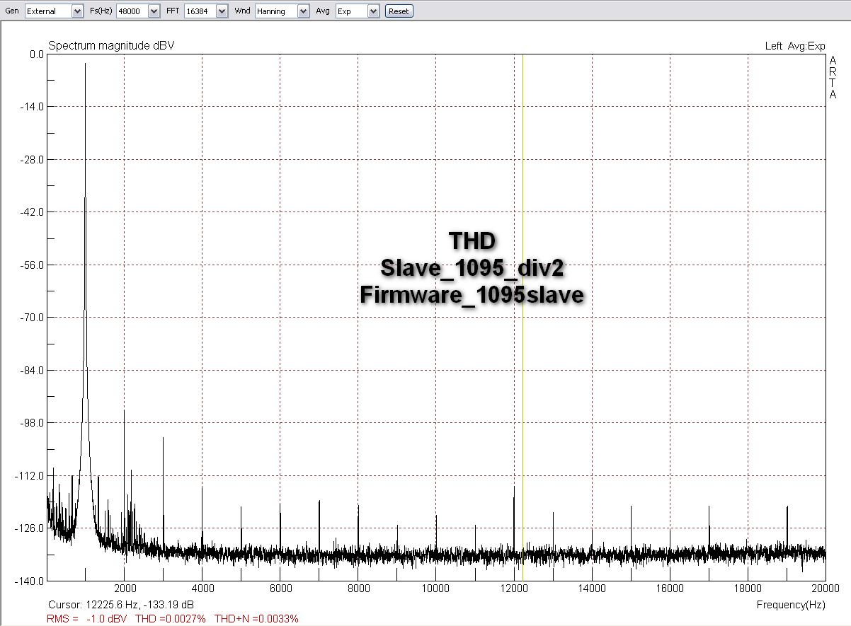

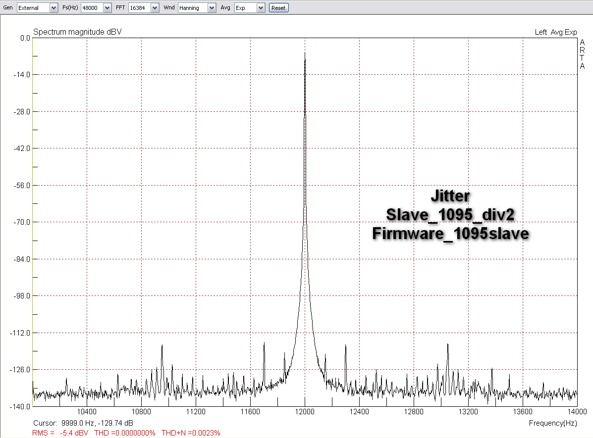

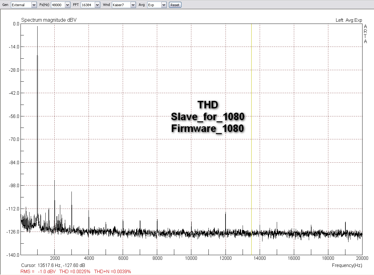

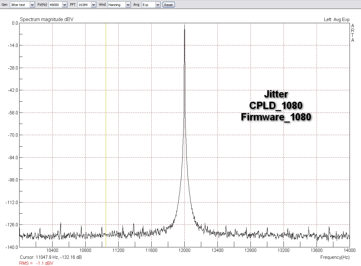

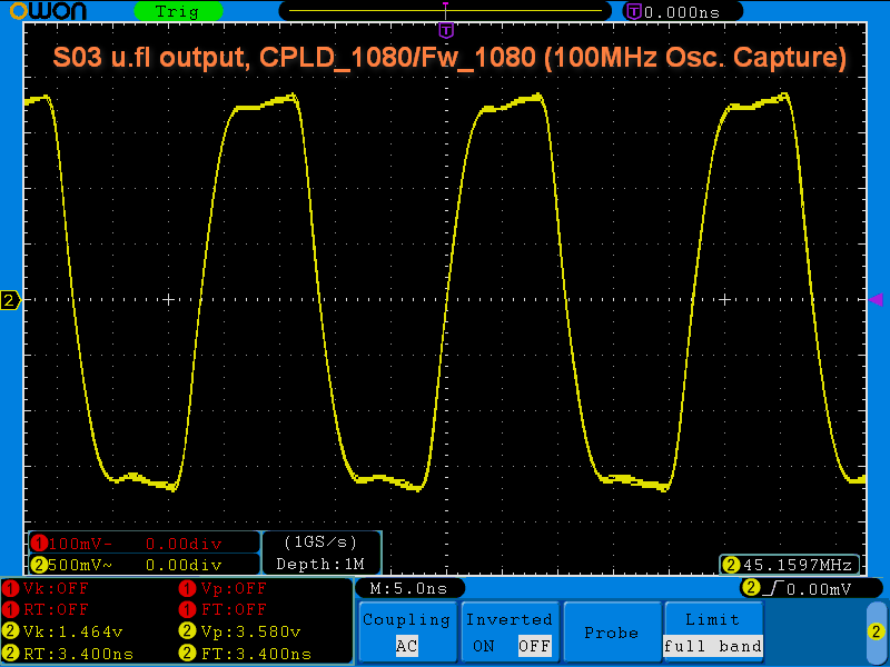

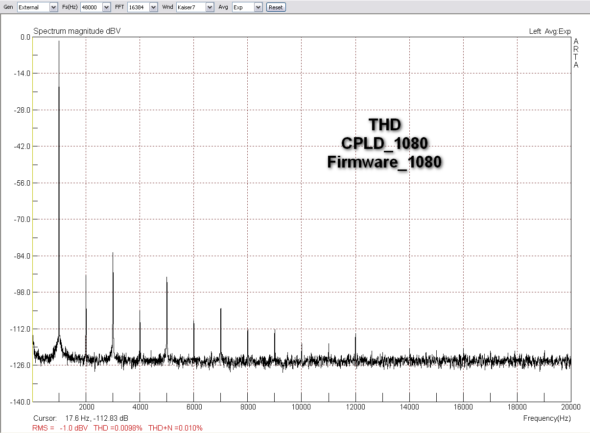

Amanero Issues
Hi to all and I am sorry for my "poor" english...
I have a concern if the Amanero plays well with the S03. I see that there are many issues! It seems that the fw of amanero doesn't work well at any circumstances.
I have some FFT captures, specially jitter and thd measures with 3 fw setup:
CPLD_1080,
Slave_for_1080,
Slave_1095_div2.
The measuring jitter and the thd is the total amanero+S03+9023 based dac.
The Amanero was directly joined with S03, the S03 to dac by u.fl cables.
At the S03 board have bypassed all the dividers (X2/X4)
Prescaler Setup where required by fw.
From what I saw, the jitter at the two slave fw modes is significant bigger than the normal 1080 fw. The noise floor at the Slave_1095 is the best btw them.
The same results are seems and at the THD measures. The low noise floor has demonstrated with the Slave_1095 fw, but the pattern isn't well.
Also, I saw that the mclk at the two slave fw modes change the frequency btw 45+/49+ clocks normally, in opposite at the CPLD_1080 that only the 45+ clock works at all sampling frequencies (see the captures, the first is on amanero clck, the second at the S03 turbo mckl u.fl - the oscilloscope capturing was at the 100MHz)
I will appreciate too much, if there is any suggestion about these or any different measuring procedure.
CPLD_1080,
Slave_for_1080,
Slave_1095_div2.
Thanks, the connector next to P9 is actually the serial connector (J1) connected to a serial to USB cable. This way I can see the console messages while booting the BBB and interact if necessary.Very nice there. I wonder the connector under P9, is for what purpose?
The BBB adapter is actually from Acko (BBB-UFL) maybe it's just another/newer version.

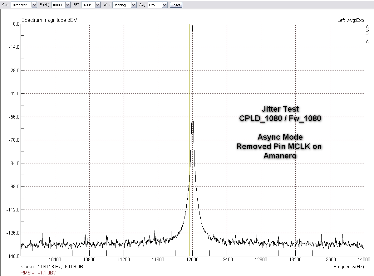

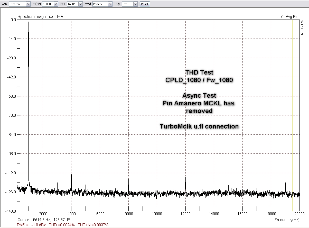

Here is another setup test.
The master clock pin has removed from amanero interface.
Now the amanero generates well with the own clocks (24+/25+)the frequencies, but the master clock doesn't carried to S03.
The i2s bus connection btw S03 and 9023 based dac done with all u.fl and turbo master clock (45+ clock) as Async mode.
Now, the thd measuring test is better but the noise floor isn't at level of Slave_1095.
