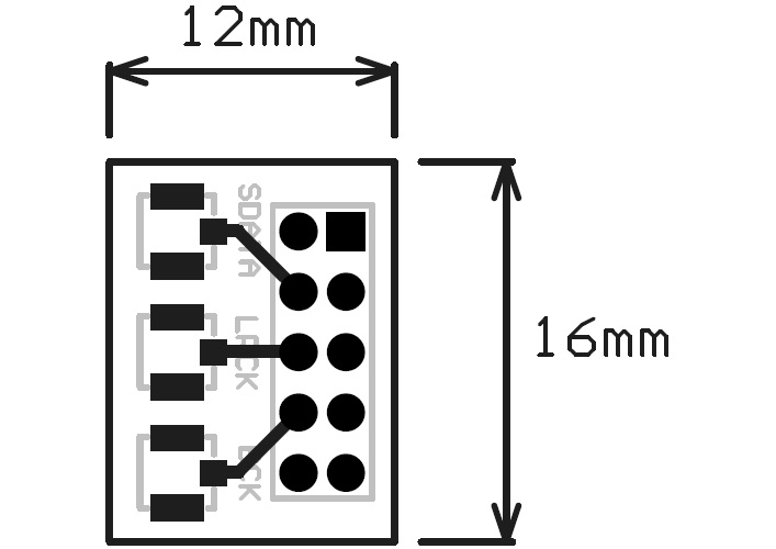

To DDDAC owner(s), wonder if there is any interest in that little pcb adaptor, conversion from u.fl to DDDAC i2s header? Please see attached photo.
I have personally seek Acko's kind assistance with this adaptor since I heard nothing from Iancanada after little over a week. As pest as I can be, I also asked if he can come up with a similar pcb adapter for BBB to S03 u.fl while we are waiting for the SuperCape? Haven't heard from him on the BBB, yet?

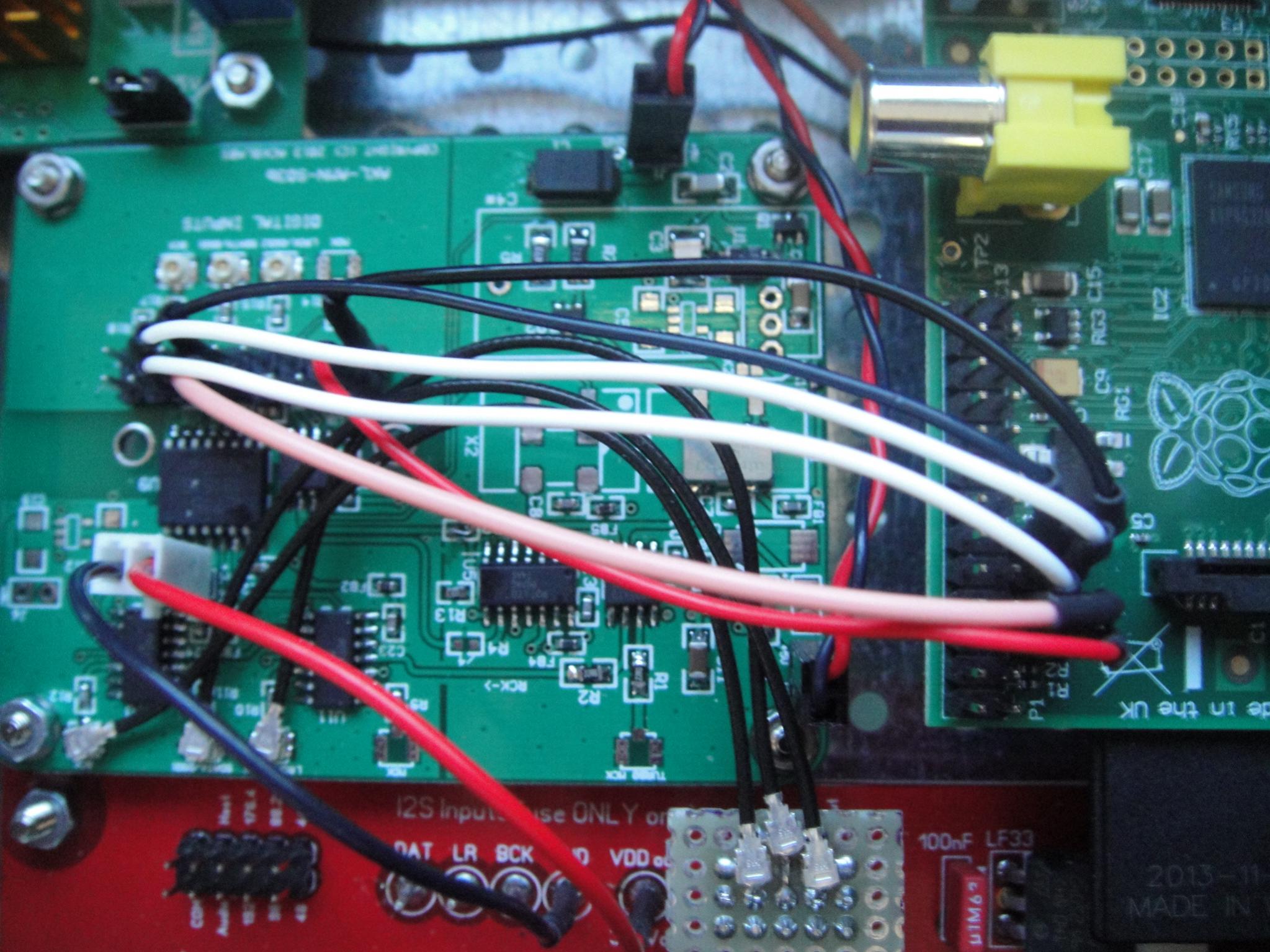

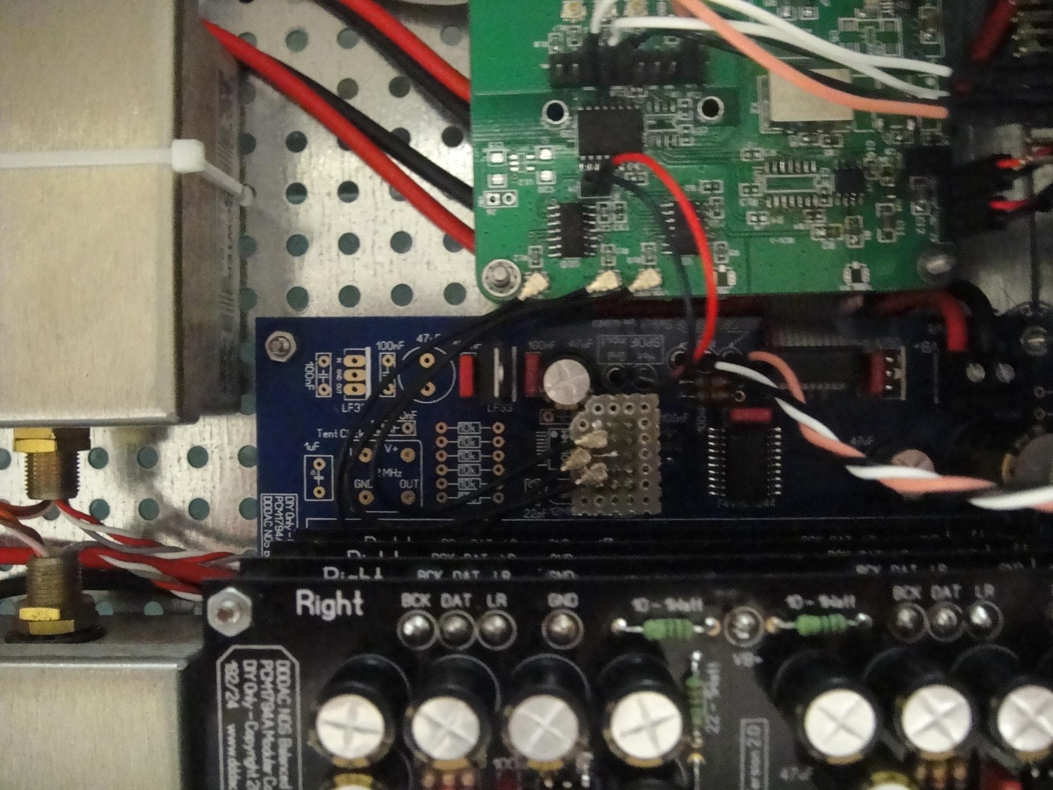

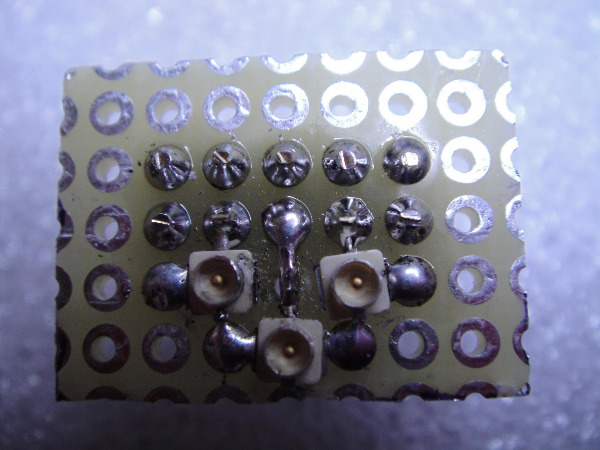

Hi Chan,
Is true that the S03 board needs a sort of adapter to connect with the DDDAC.
I solved the problem with a small piece of prototype board, one 10 pin female and 3 U.FL connectors. With a little patience you can have your adapter ready to play
I hope this can help you and the others DDDAC owner(s).

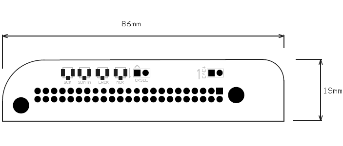

Also, BBB-UFL adapter wired to pins as shown. Mounts on P9 connector of BBB. Only a few samples will be made at this stage

You are welcome Chanh. Just give a try, are few $ of parts and the worse that can happen is that don't transfer the I2S data from the S03 to the DDDAC, so no music playing .
Don't worry, no way to kill the DAC through this adapter rolleyes: well, unless you send the 5V instead of the I2S signals )

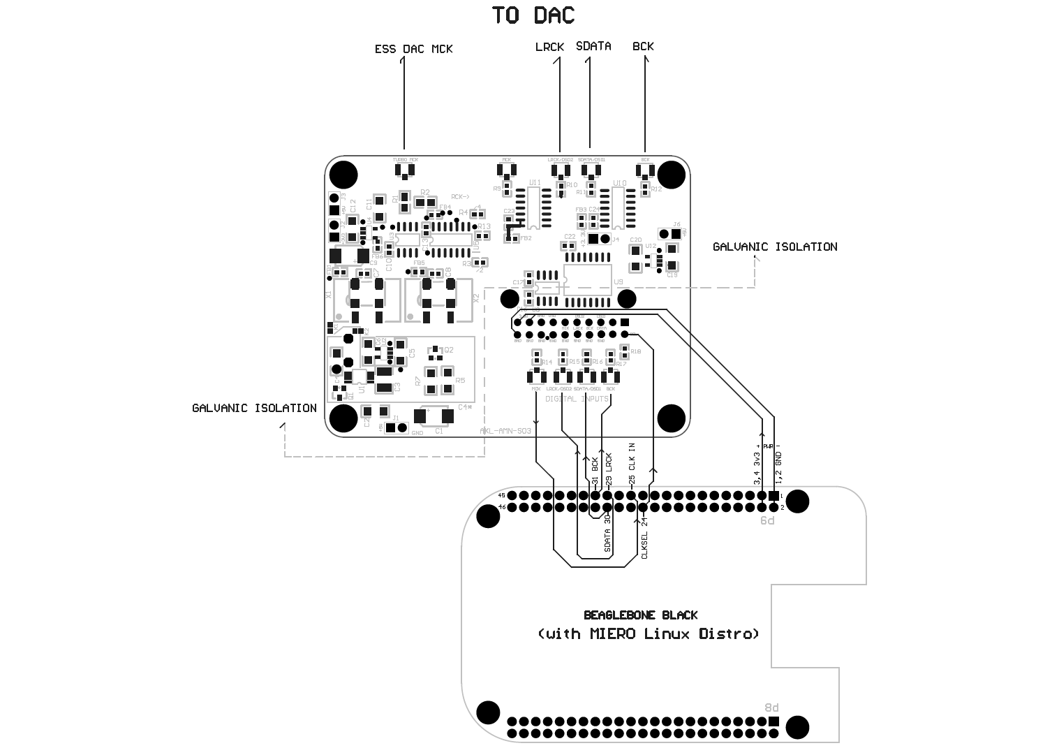

As the BBB interface board could prevent the use of other pin outs on P9 it would be neat useful, especially as there is plenty of space, if the board offered pads for off board power (P9.9) and reset (P9.10) switches.
I know the power button function requires a momentary action switch across P9.9 and ground, not sure about the reset function without referencing the BBB manual.

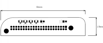

BBB-UFL board
supplied as empty boards only ($15 each). UFL connectors can be mounted upon request at cost. Pin pads of the BBB P9 connector are replicated and you can connect header pins as required to access the relevant signals.
