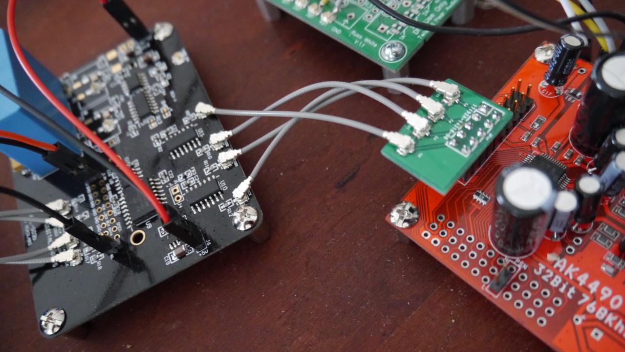

These are all good, thanks! Commercial designs tend to obscure the concept a bit, so tubes and transformers aside here is something simplified:
The S03 has fairly strong outputs and should be able to drive passive filters directly. Choose cut-off frequency (say, @50/100KHz) to recover the baseband audio and remove the DSD carrier which starts from 2.8MHz DSD64 - fairly spaced apart so a simple LPF will do as shown.
There will be a dc offset of ~1.6V from averaging the unipolar switching and should be blocked using a coupling cap. Usually the Buffer/Amp has one at the input so this taken care off - but don't forget to mute at power on/off !!!
For steeper roll-off. cascaded filters and its associated buffers should be used. I think this is what is done by the triode filters of the Lampizator and the digital filters of ESS DACs, etc
Simply duplicate for the other channel... and that is it!

Just FYI... DSD has significant ultrasonic noise and the "Scarlet Book" specification is for a 3rd-order LPF at 50KHz. So yes, cascaded filters would be useful, and I'd probably go with 4th-order LPF at 50KHz just to be safe.

Yes, that was Doede's thinking too it seems. Keep it as simple as possible and use the dsd signal to modulate a mossfet and create the output signal.For I while I was convinced that DSD did not require a processing unit to decode in order to render the modulating signal. Yet every other manufacturer indicated otherwise or somehow entangled with their proprietary techniques. This contradicts with the physical nature of DSD which is essentially Pulse Density Modulation, similar to PWM used in switch-mode PSU and motor drives.
That side of things seems to work very nice if you find the right components, so the real challenge is filtering the noise. I believe Doede was proposing to use an averaging filter for this.

Any way, We did both DSD and PCM. Tests were carried out on a tweaked BSE with Lundalh output transformers and linear ps. I guess the observations are purely personal taste. Btw, when doing the shoot out, AK4490 to my ears was a more engaging than ES9018 in term of overall SQ. May be Lintweaker would share his thoughts between the two?
