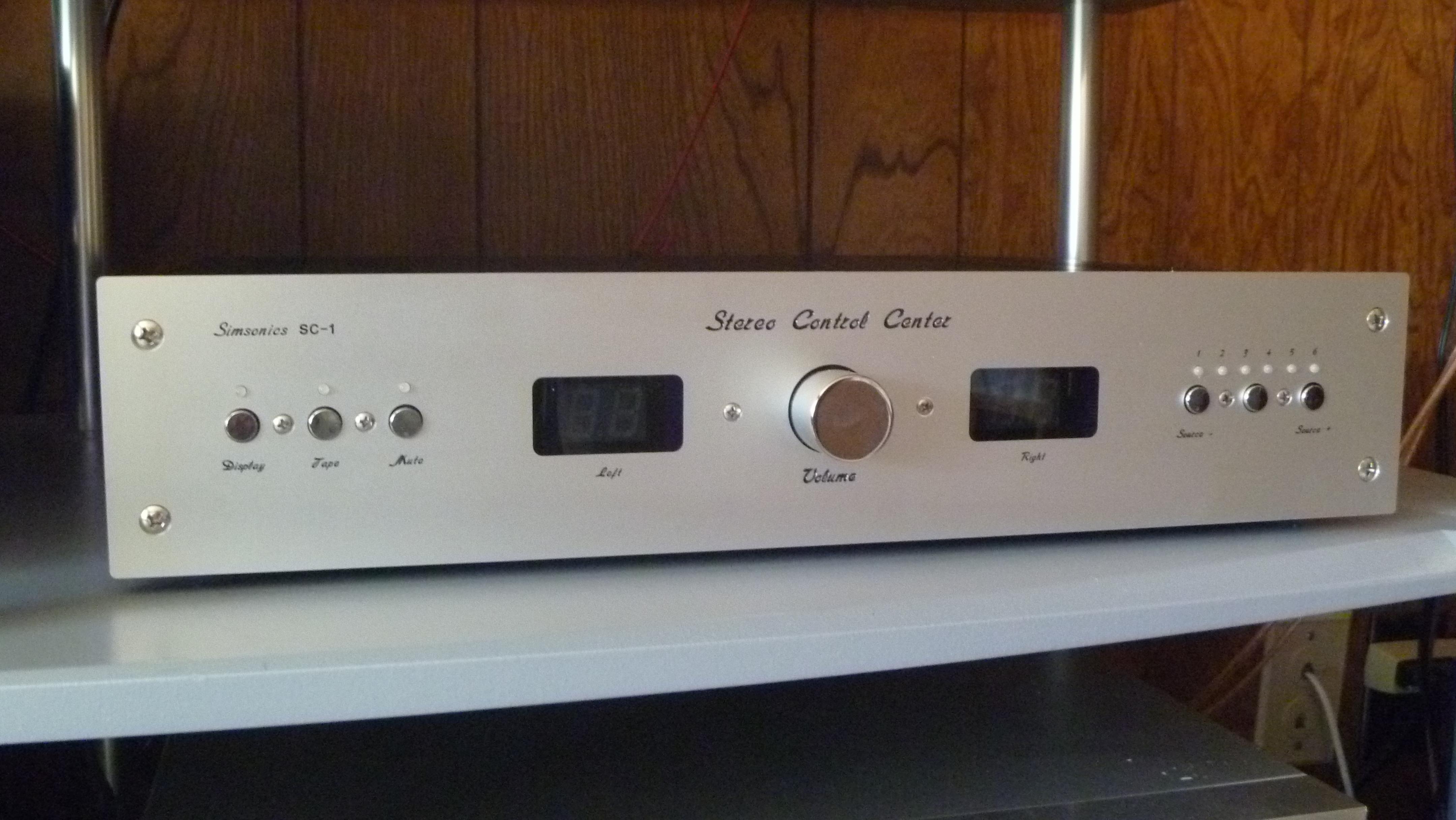

Yes, I agree but I listen to my system a lot and I've never wanted to crank it past the -20 point. Usually I'm a few dB below that. If I find myself wanting more someday I have no problem building a pre-amp. There's plenty of room inside my current passive-pre to add a gain stage.
cheers
