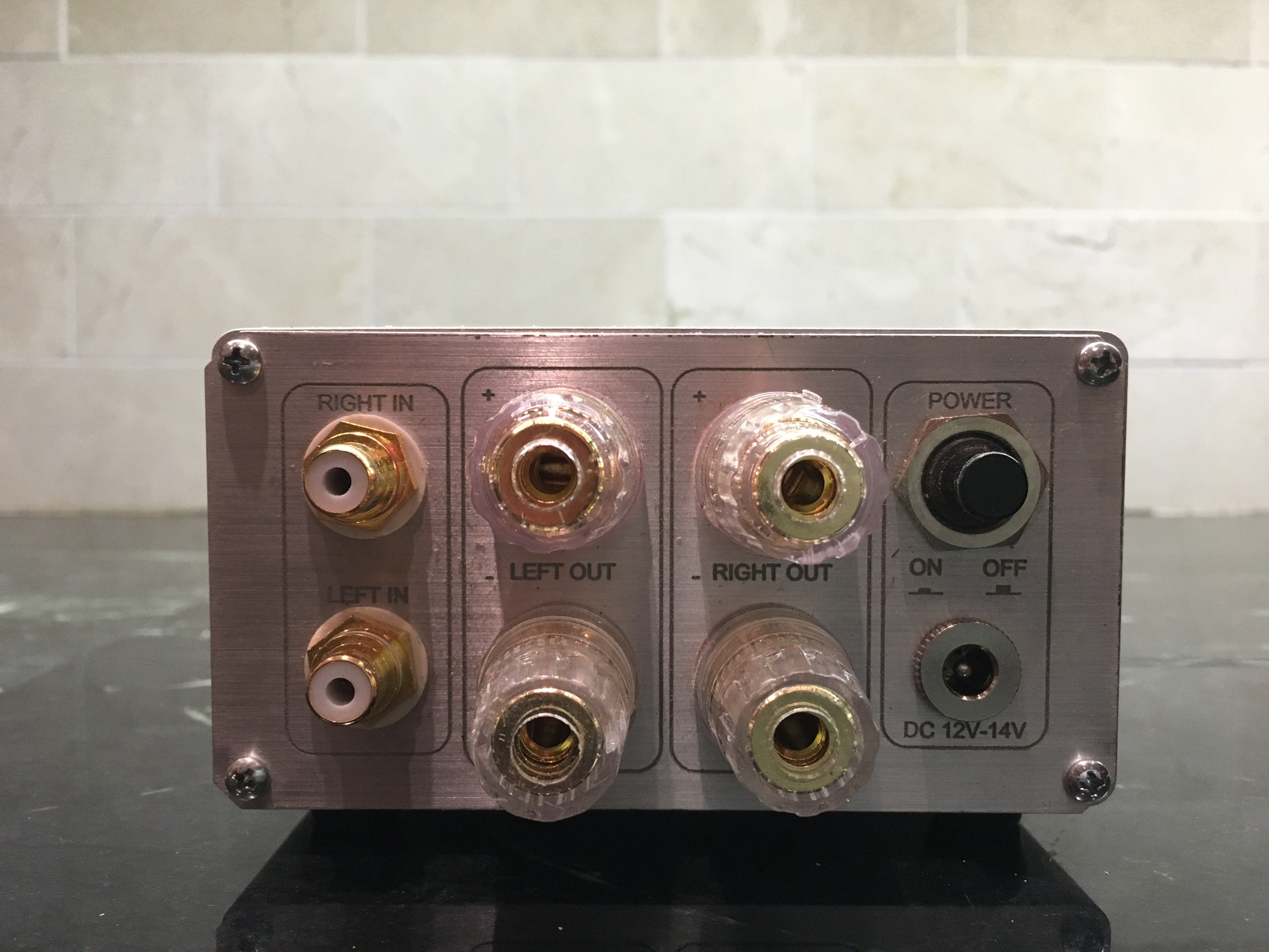

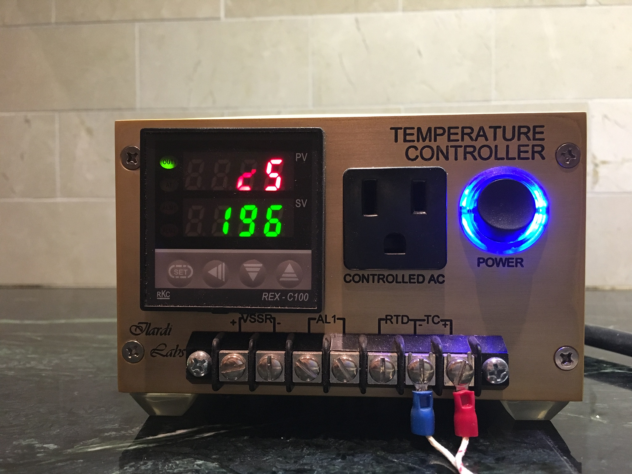

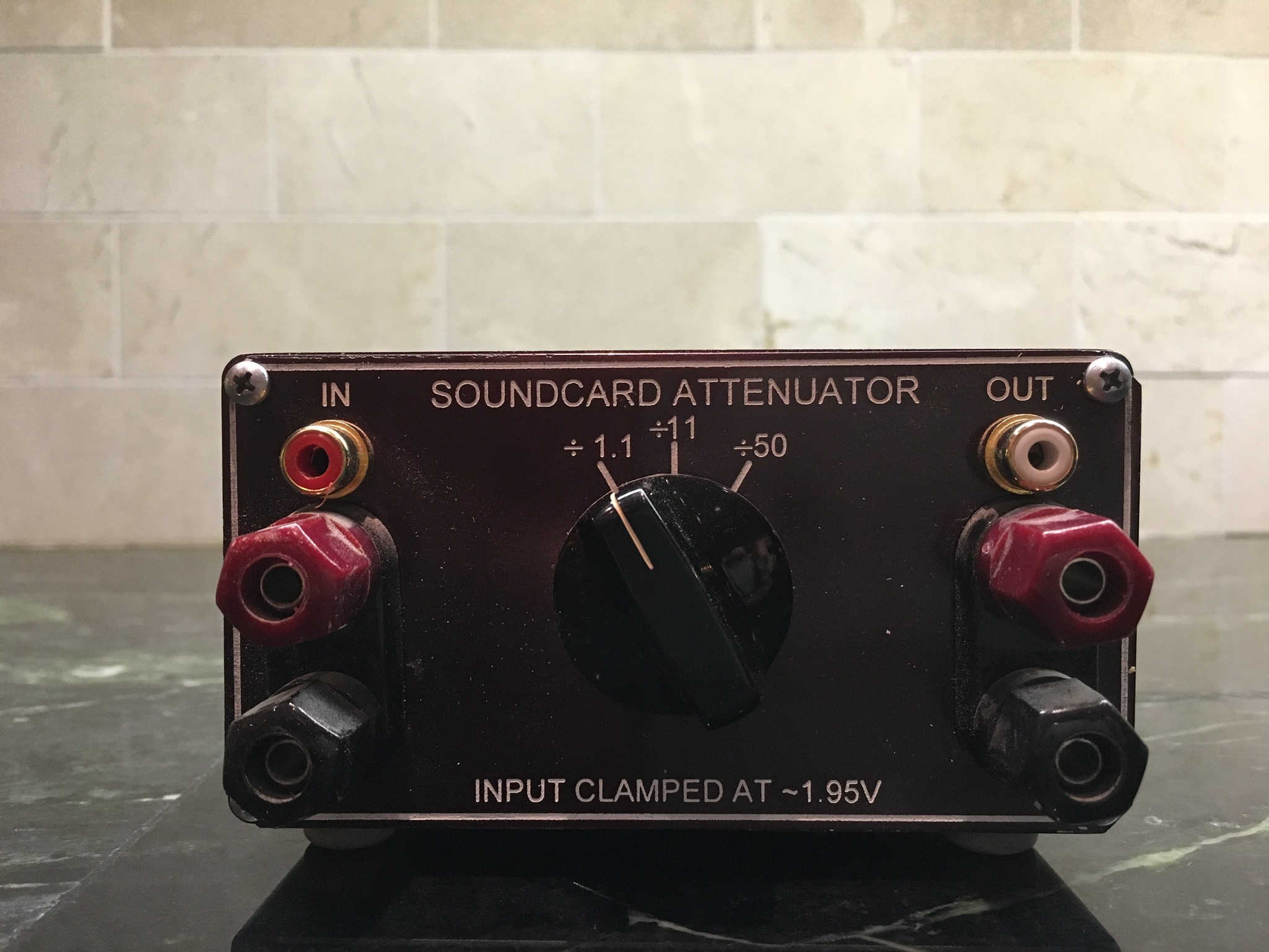

And here are some photos of the results.
That is pretty impressive, and not what i was expecting. The diy etched work ive seen previously has had much more of a, umm, "steam punk" (for want of a better description) look about it, whilst yours looks more like a print.
As i say, impressive work. It looks way better than the lasertran DIY option, the frustration of which was what finally pushed me toward cnc...
