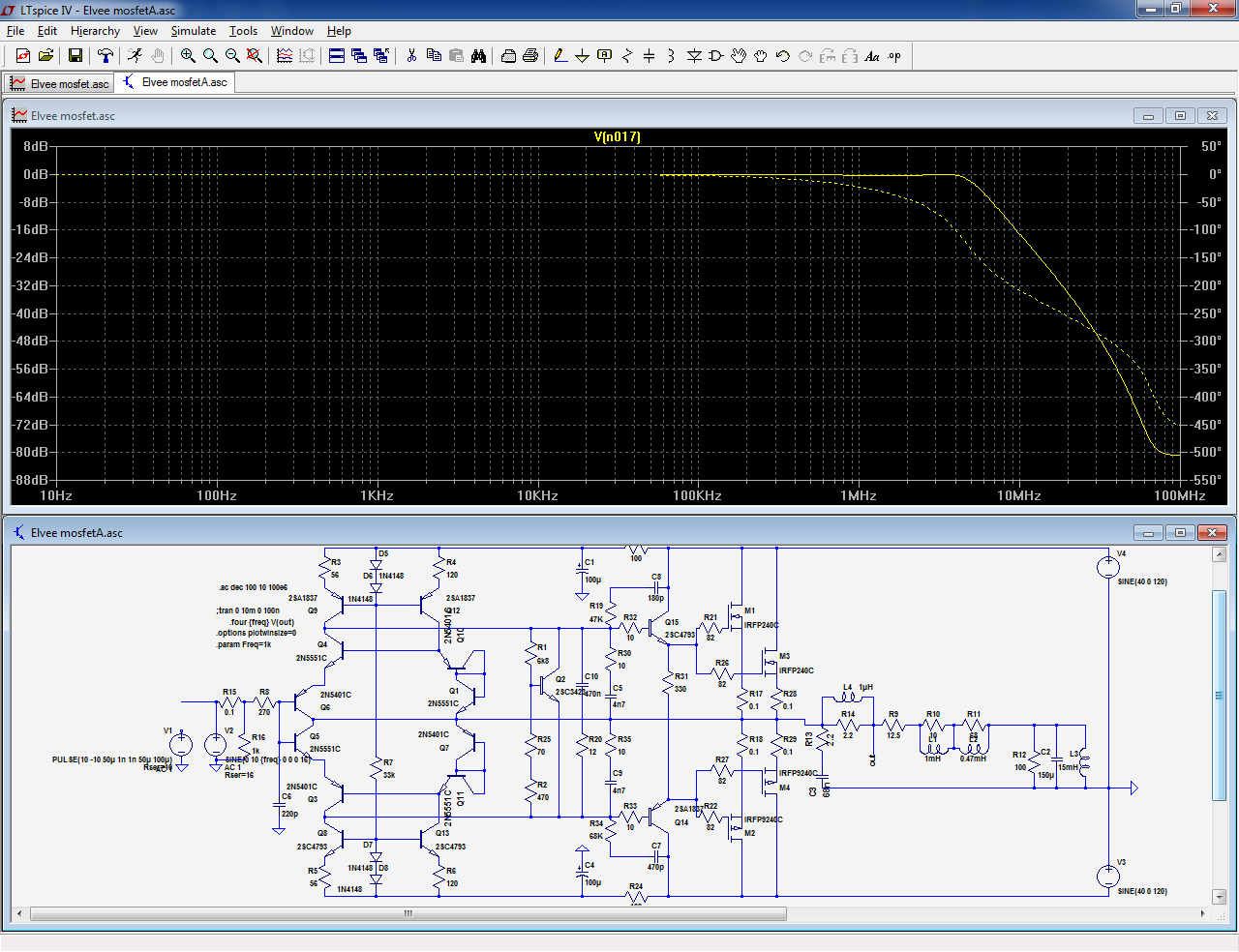

Well Bas, you went from one extreme to the other, and in doing so you took a huge challenge: your initial buffers were rather simple and rustic affairs, but this series of circuits are monsters of performance and also very demanding, since there are no free lunches in engineering.
As if this wasn't enough, you chose one of the simmed-only versions, and you modded it to improve its performance....
You must love difficulty :D
Here are some first leads: the regular compensation has been disabled and changed to output-referenced shunt, and the gate stoppers have been reduced.
This result in a nice, flat FR response and no oscillations. Of course, everything has to be carefully evaluated, because there might be negative effects.
Regarding construction, it is also quite demanding: I don't use PCB's, I only build on perfboard, and this leaves a lot of room to change something that was overlooked at the initial stage. With PCB's, things are less flexible, and you could end up with a number of tentative versions before arriving at a satisfactory one.
  • Elvee mosfetA.asc

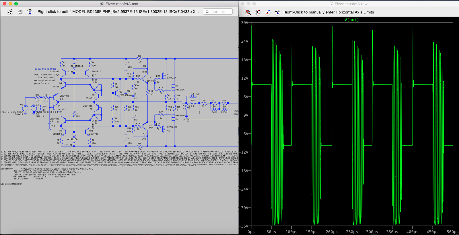

I ran some simulations, but I get a massive overshoot and lots of oscillations now. Guess I'm doing something wrong. Can you see what?
By the way. The load is modelled after the speaker it will be driving. However, it should/must be able to drive 4 Ohms with ease. I also intend to use the buffer on Fender cabinets, which sometimes go as low as 2.7 Ohms. As far as I can see, this buffer works with every load you throw at it.

We will try a step by step approach: there are many issues to be addressed as you have discovered, and before you even think of laying-out something physical, all has to be spotlessly clean and well-behaved under any sim scenario you throw at it.
These are difficult topologies, and small signal stability doesn't guarantee stability under all circumstances.
Good point is: once you have successfully tackled all the issues, this buffer is like a rock. It will perfectly drive 0.1 ohm loads if you ask him to (except the transistors will be destroyed in ms, but that's another problem)
I second that: one step at the time. Most obviously it's stability that needs to be addressed. I can stop the oscillations, at the cost of 20% overshoot. What is acceptable? I suppose large overshoot can kill the output devices (large currents)...

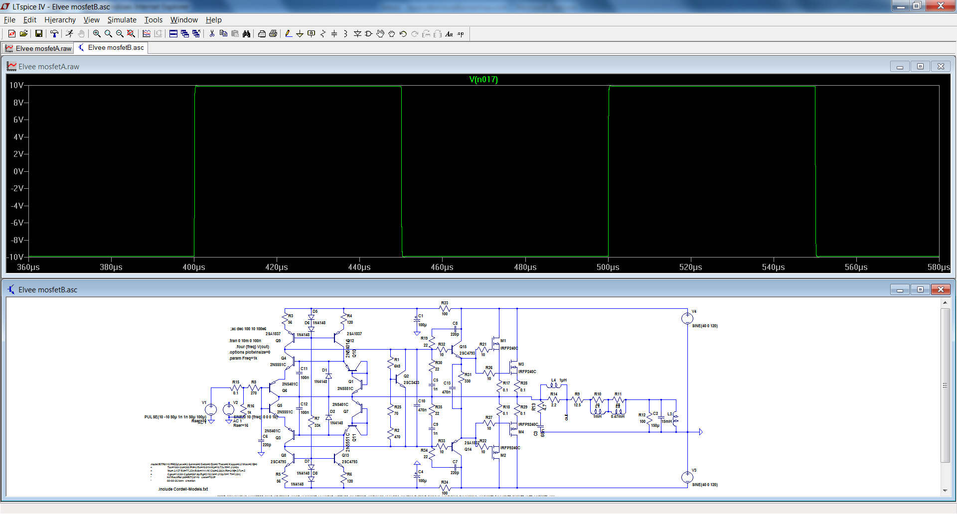

  • Elvee mosfetB.asc

Forgot to post the latest work on the schematic. I can't find a better optimum between speed/high freq response, distortion and stability...
Personally, I prefer B: no overshoot, no bump in the FR and linearity 0.15ppm against 0.68ppm, but tastes and colors...
With 680 ohm input resistor instead of 330, the figure increases to 0.77ppm, which is still acceptable I think.
A 1K pot would add 250 ohm at most.
Anyway, it is probably not very useful to dissect the sim in fine details : reality will be different.
At this stage, you have to give it a good shake in sim, be sure that nothing breaks loose, latches up or oscillates, even under extreme conditions.
Once you have built a first prototype, you can see where the discrepancies between sim and reality are, try to make them converge, and then only finely optimize the sim.

Thanks for your answers Elvee. I later realized I made some mistakes when simulating the thermal behaviour of the buffer. The biggest one was that I simulated that all transistors and diodes would rise in temperature to the same extend. This of course isn't true. The diodes in the CCS's probably won't rise 15 °C for example.
So I made a new sim but I still don't seem to fully understand how to simulate and predict thermal behaviour of the mosfet buffer. Here is what I did:
- I fixed all temperatures except for the bias transistor, drivers and output devices;
- I tested three bias transistors: BD139, 2SC3423 and IRF510. They are always on the main heatsink with the output devices;
- I simulated two temperatures for the bias Q, drivers and outputs (25 and 40 °C);
- I simulated with a fixed temperature (separate heatsinks; I assume temperature stays fairly stable when they are on separate heatsinks) for the drivers and with variable temp (when mounted on the main heatsink.
My findings are that with all bias Q's the bias current rises when the drivers are mounted on the main heatsink. This to me seems like a good recipe for thermal runaway.
With the drivers mounted on separate heatsinks and fixed to a temperature of 35 °C (with the assumption their temperature stays pretty stable) and the BD139 or 2SC3423 as bias Q's, the bias still goes up 10 mA with temperature. Only with the IRF510 the bias goes down with temperature if the drivers are mounted on a separate heatsink.
I could thus conclude that I need separate heatsinks for the drivers and should use a mosfet as bias Q, but I'd like to have my findings confirmed. I just don't have the experience with mosfets or triple emitter followers to know from experience what will happen.
Anyhow, I designed a PCB (prototype off course) with the drivers on the main heatsink. That was prior to the most recent simulations. It is however possible to point out some obvious mistakes if there are any.
  • Elvee Buffer mosfet.pdf
Never mind Elvee, I made a mistake that heavily influenced the results. I simply forgot to make the temp of the bias Q variable and left it fixed instead (not on purpose off course). After I corrected this, the bias behaved as expected: overcompensation! This can be corrected by adding a emitter degeneration resistor or diode (as per Bob Cordell's suggestion; no thermal coupling) to the bias Q which I did. I also tried to further linearise the Vgs multiplier without adding another transistor. As a result bias now drops around 10 mA when going from 25 to 40 °C with the bias Q, drivers and output devices on the same heatsink. This with a 0.4 °C/K heatsink, an idle bias current of 200 mA and +/- 50 V rail in mind. If I'm not mistaken that would mean 16 °C rise of the heatsink at idle around where it would stabilize. Attached is a new sim with the aforementioned Vgs multiplier.
  • Elvee mosfetD.asc
