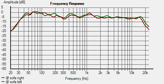

With the stock (large) ports they don't go down very low. If the ports are better tuned, you can get almost another octave. In room response of mine has an F3 in the 30s. I'll dig up a response curve for you later today, after work.
But an F3 circa 50 Hz is common. These are not what I would call a "Supersub".

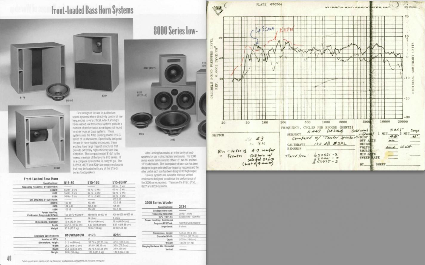

The first plot is a factory measured 2pi space response: http://www.lansingheritage.org/images/altec/specs/components/515g/page3.jpg

Depending on the driver loaded, 50,55,60 Hz according to the old spec sheet.With the stock (large) ports they don't go down very low. If the ports are better tuned, you can get almost another octave. In room response of mine has an F3 in the 30s. I'll dig up a response curve for you later today, after work.
The Klipsch measurement must have been using the 515-8GHP, it drops like a rock below 60 Hz.

If you want to properly integrate a sub with an A7 you are going to need to measure the specific A7, or you will just be guessing what it's response actually is.
The in room response of your pair of A7 will likely be different from any response you find posted on the web.
