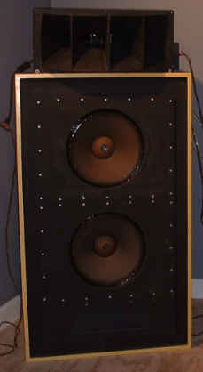

altec 415C
note flannel/felt dot on cone
18714
18714
Re: altec 415C
Also note the cone pulling away from the cloth surround.
tomtt said:note flannel/felt dot on cone
Cal Weldon said:I see only a shadow. Where do you see the separation?
That's exactly why the shadow is there. You can clearly see it halfway down both sides of the driver.

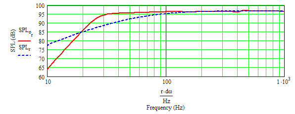

Greets!
The M19 is right at 9.427333209 ft^3 tuned to ~35 Hz, so how tall you want it would determine the width, depth. Note that to tune it to ~Fs requires a ~3.5" diameter x 2" long vent.
Anyway, it's probably too small and how much output impedance your amp has will determine how much over-sized it needs to be to tune it down around Fs, so if you don't know it, then all I can recommend is a cab size guaranteed to be big enough to allow some tuning flexibility and then you may need to adjust tuning for best performance in-room:
H = 46"
W = 33"
D = 24"
zdriver = 15.5"
zport = 40"
port = 6" diameter x 0.75" baffle thickness or 3" x 9.43" if rectangular
All dims are inside (i.d.) and recommend covering the top, one side and rear with 1" acoustic fiberglass down at least half way and add more down lower as required. Note the sim assumes a typical SET's ~2.5 ohms output impedance on the 8 ohm tap.
GM

Greets!
You're welcome!
Correct, after deducting out the space required for bracing and the driver it's ~20 ft^3 net. It takes a big cab to go low with a large, short vent like the 416 requires when driven with enough series resistance or low DF amp to raise its effective Qes, Qts a high percentage. If you don't use a large enough cab it will sound 'bloated'/'flabby'/'muddy' like any other under-damped alignment.
The vent's 2" internal diameter is way too small to tune a big cab to a low Fb, so you'll need at least seven of them/cab to meet the 3" minimum length for one flare and ten/cab to use both flares, so that's a lot of holes to cut/$$ to me when I can just cut just one big hole. With this many vents though, you could 'ring' the driver with them like Thuras did for his original reflex cab patent, which BTW was what the Jensen/Onken alignments are based on: http://www.google.com/patents?id=MS1bAAAAEBAJ&pg=PP1&dq=1869178
GM
