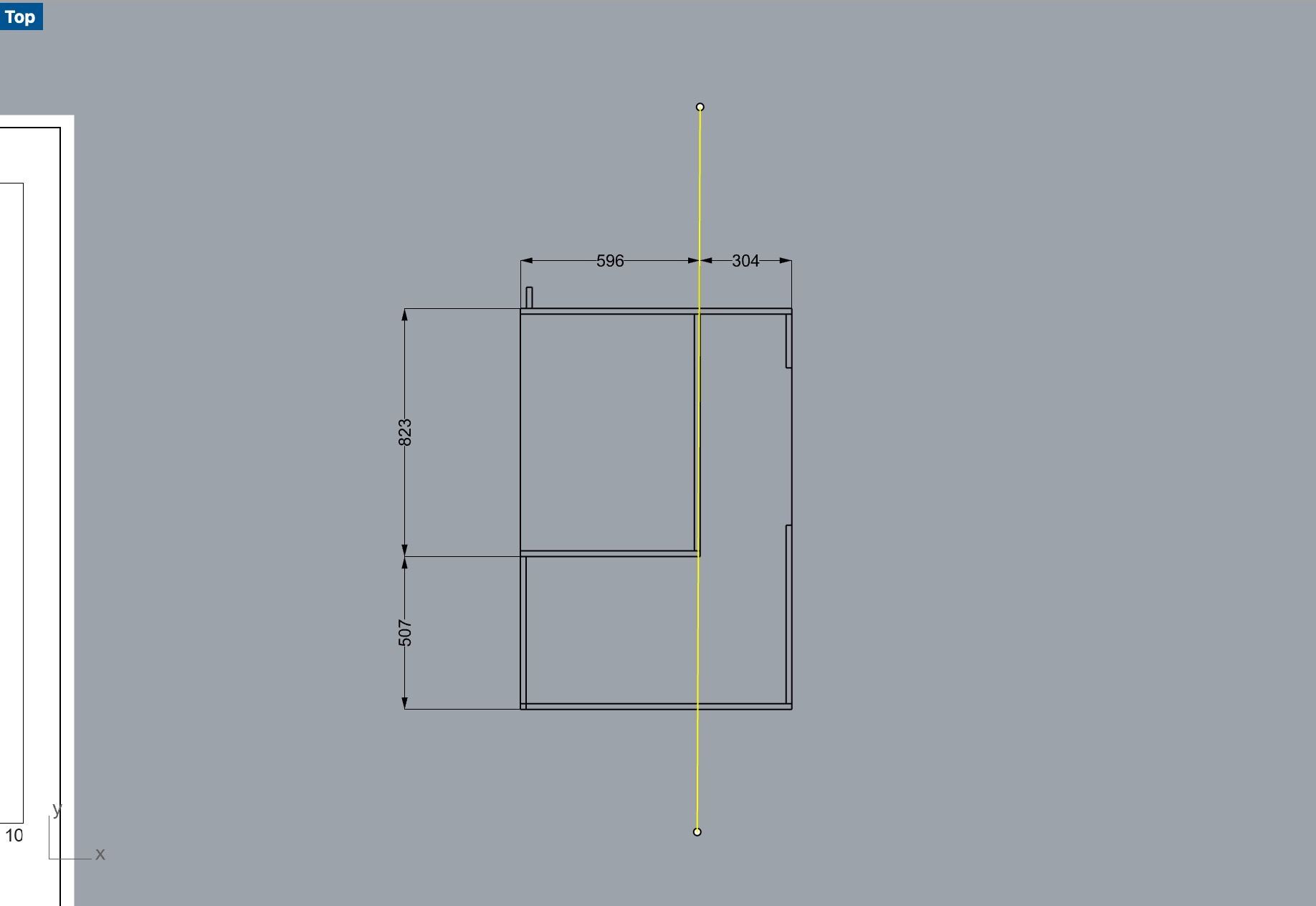

I’m trying to find the blueprints of the original H110 cabinet on net, without any luck…
Does anyone have the plans for the H110 cabinet?
It is an early model of the Altec A5, REF: attached screenshot.
Considering building one.

TTBOMK none exist, though attached were done from an original and FWIW having measured one and
lived' with one as an A6 (less riser) at my high school, its basic dimensions are spot on to my sketch, so should perform the same except for the fact that the originals were made from some really cheap packing crate plywood, so 'colored' the performance somewhat depending on the soundtrack, SPL in a nearfield app.

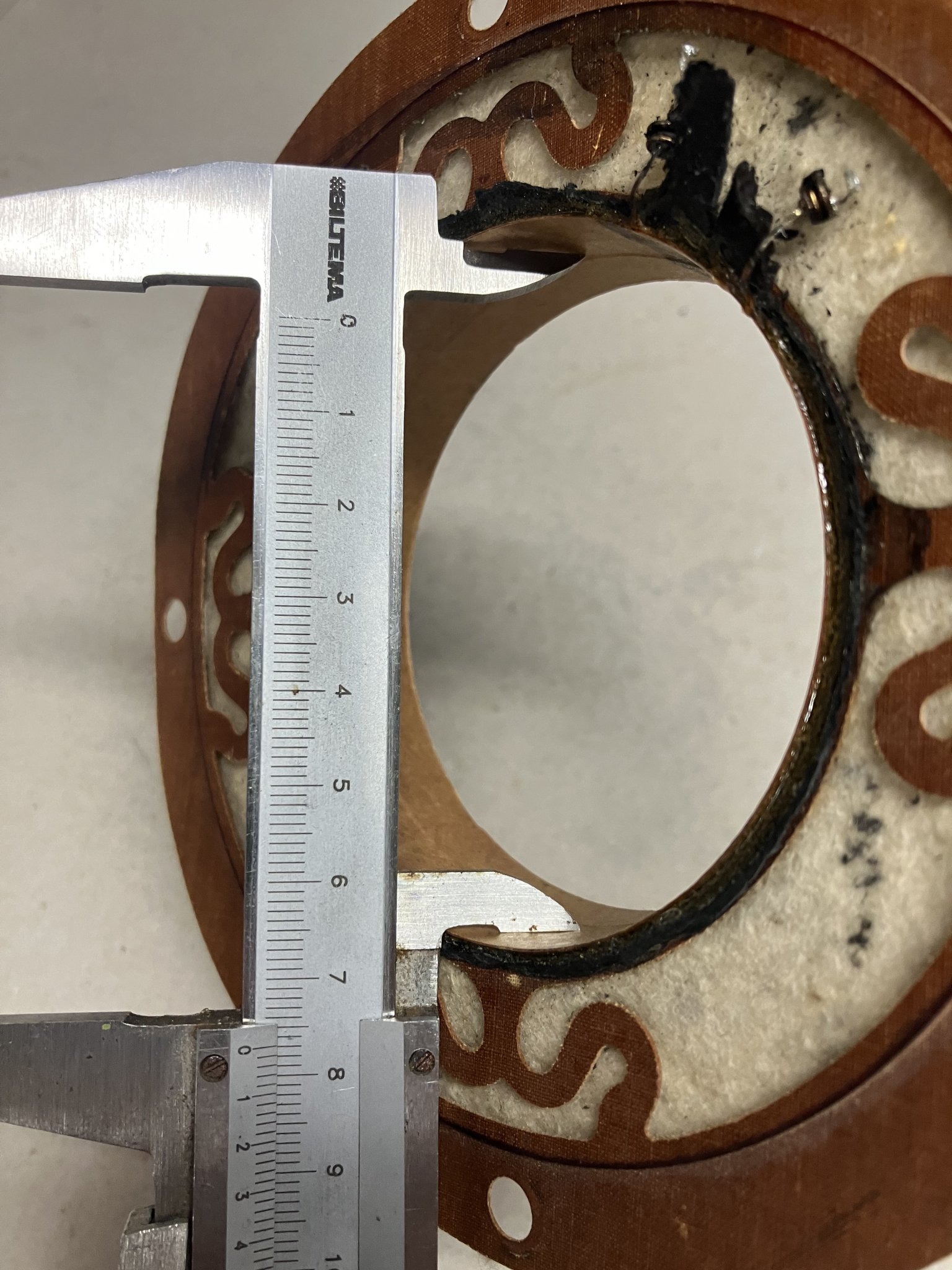

The cone of my 515 RWB was in such a state that it was not salvageable. It had tears along the basket.
I have the original coil + an after marked paper cone w. correct pressing; bought on eBay.
I have started taking off the last paper cone remains on top of the cardboard cylinder to which the 20 ohm coil is attached.
The phenolic spider I will leave be.
I will need to attach the aftermarket paper cone to the coil.
Q1: I had a bit too much heat on the soldering iron when detaching the two coil wires…needed to take away a lot of epoxy. they now look a bit thin, see attached photo: will I manage to salvage the coil? Should I overlap the two wires with the tinsel leads a bit more than normal?
Q2: It looks like the paper cone, originally, was entered to the cardboard cylinder before the phenolic spider.
I do not want to tamper too much with the spider; is there a possibility to attached the new cone to the top of the coil/cardboard cylinder; if the surface has been grinded down properly? I’m using a Dremel Multitool.

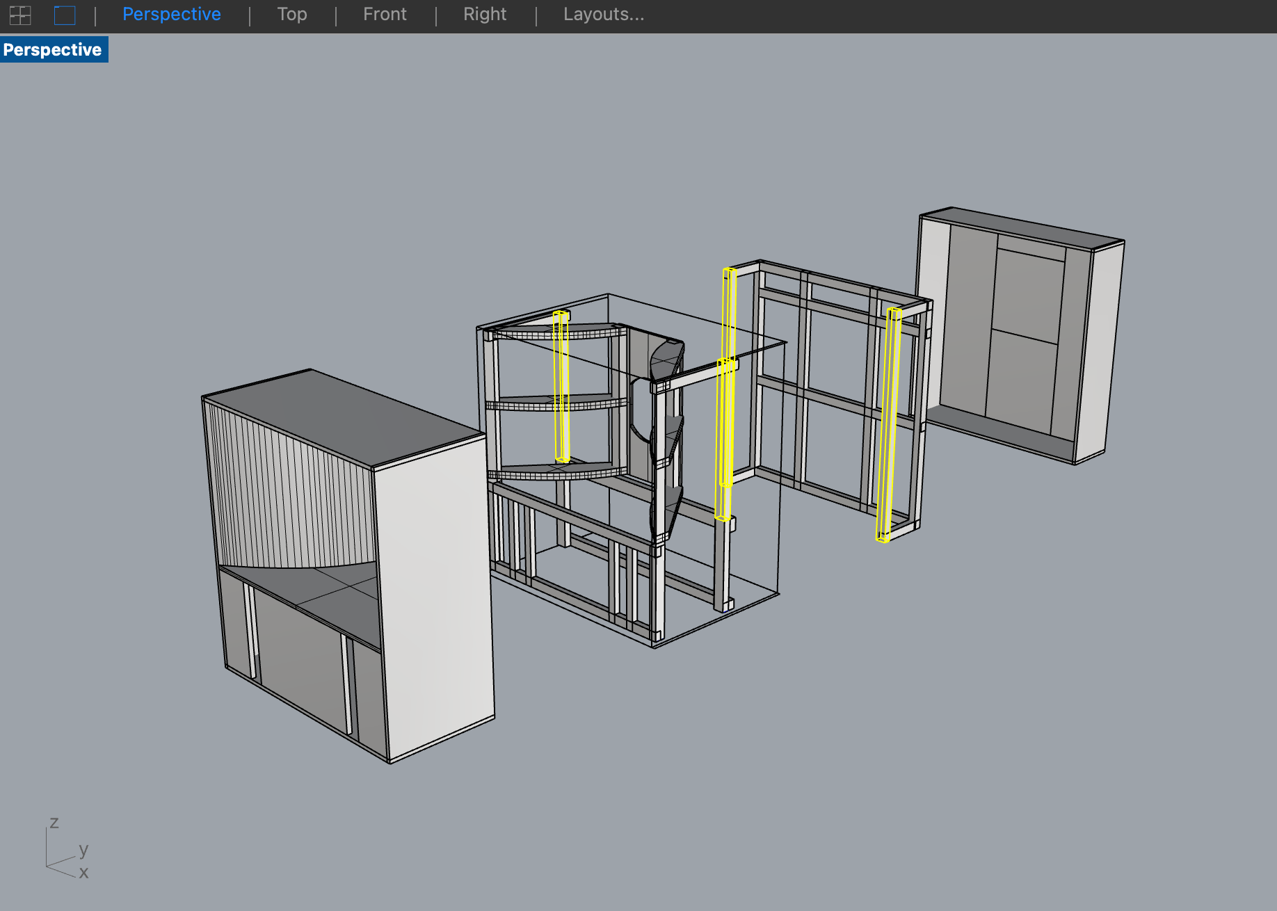

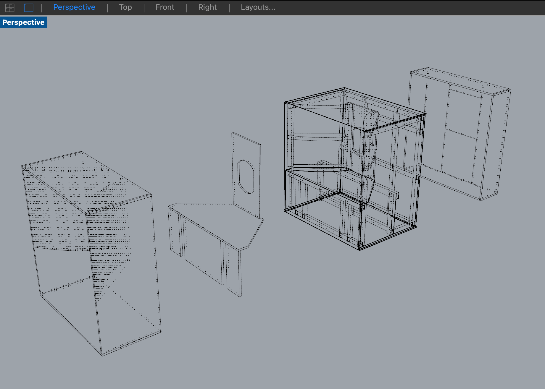

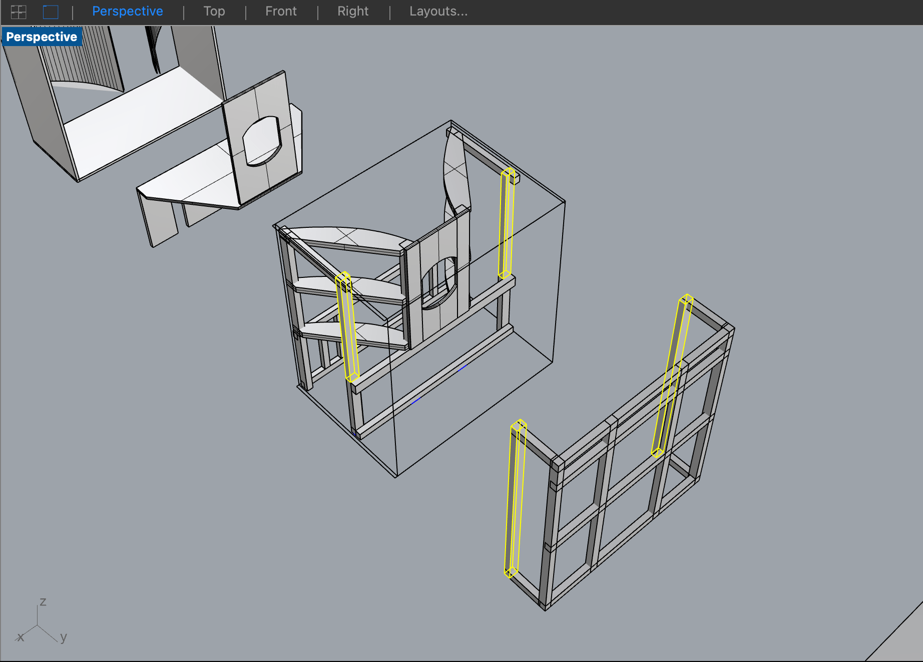

The thing is that if I was to build the H110 I will need to build it in two separate parts… the cabinet will need to be cut in two, vertically… and then reassembled in my living room. If not I will not manage to get it through my front door… oh man… haha…
If this is not doable, I will build the A5x, much more easy going this cabinet.

When I built my first Altec system (A7-500) in '64 with 3/4" marine grade no void plywood, the manufacturing plant I worked at used what appeared to be the same $%^&* quality pine packing crate plywood as the H110, but then Ga. Pacific used Ga. pine, so assume that whatever the cheap trees used in California shipping was in the mid 1940's.
edit: Sure, no problem, we did it using gasketed 'ship lap' joints to create inexpensive movable concert, trade show arrays.
