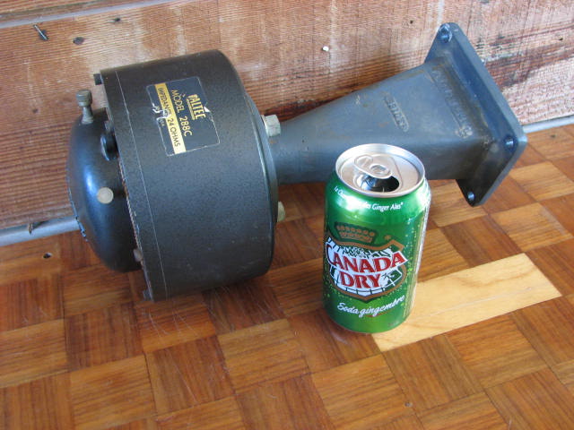

The 1803 is quite large in comparison with the 15 series. I run mine with 288C's.
I'm not too concerned about the bass extension as they aren't for critical listening and they are coupled with the big boxes for bass. Here you see the 828's when they were a two way. Standard beer mugs for relativity.

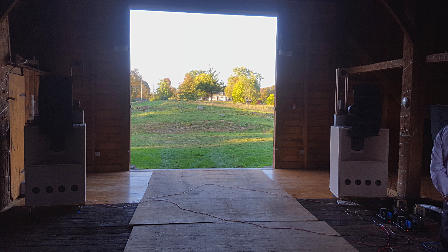

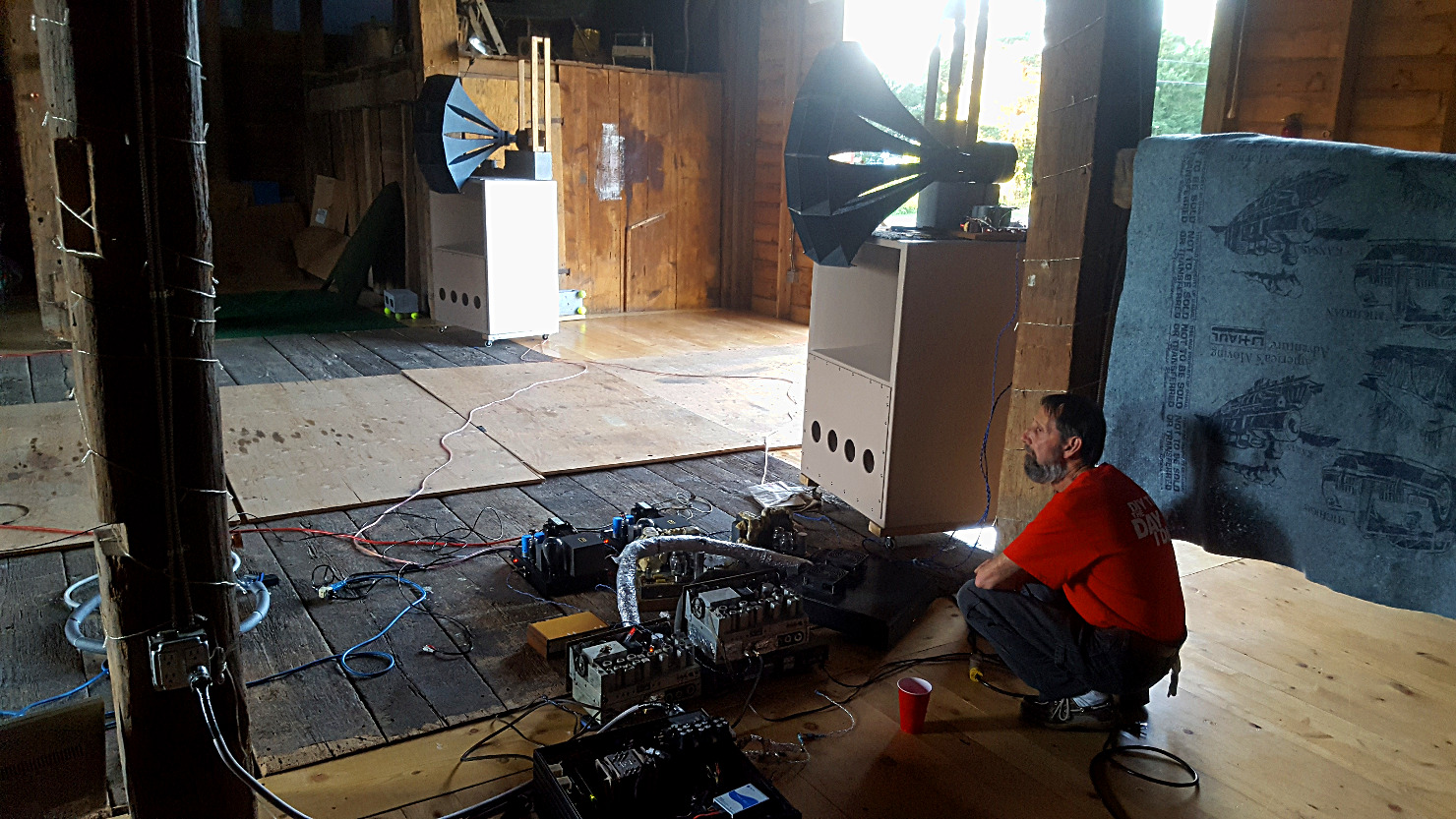

What I did is pure heresy.
Here's a partial list/rundown. From memory. It's over 20 years now.
- Move to a 300Hz horn
- this permits reasonable flatness overall, and improves the upper mids (takes them off the 15" driver
- Use an elliptic LP filter for the LF driver, 1st order for the (non-Altec) HF driver
- The elliptic LP is designed to precisely counteract the rise in amplitude of the front loaded LF driver, flattening the response with a <3dB rise between 150Hz and rolloff
- rolloff to the HF horn measures like a cliff
- stiffened all walls by outer lamination
- stiffened interior with struts
- stiffened horn flare with very hard "concrete-like" poured in compound
- replaced LF driver throat piece with something substantive (not cheesy plywood)
- used highly absorptive wall treatment on all interior walls (it's dead in there)
- changed out "reflex" opening for sealed ports - simulated and tested, ample area.
- used modern JBL 15" equivalent to the "Paragon" driver, permitting actual 35Hz tuning.
- necessary to biamp now, higher power amp on the bottom, and can now nice tube SE or other amp without ANY attenuator between the amp and speaker on the HF!!
Obviously, this is no longer a true "Altec".
But it solves or resolves a number of real problems that the original design has for our applications.
It's not really good for PA use like this.
Advantages:
- true LF tuning, pretty darn flat to 35Hz. (awesome in a large space like that barn!!)
- able to use full sensitivity of HF driver, can use much lower power amps than stock; aka 109dB/1w/1m typically, not 100db/1w/1m
- LF speaker can handle more power than the Altec designs
- no midrange or midbass "blow through" from the "reflex" opening
- much much cleaner midbass than stock
Disadvantages:
- heretical
- takes WAY too many hours to pull this off - not going to do THAT again!
_-_-bear
PS. Imho, it is impossible to get "bass" out of the stock drivers given the cabinet volume. Run the simulations.
So, forget about low bass, that's the conclusion I drew, and moved to a different driver and the above solutions.
Advantages:
Disadvantages:
- heretical
_-_-bear
