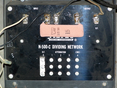

Cal, suggest you might want to do some serious looking at the "native" response of the 288 series. Non-flat. The standard EQ schemes are not sucessful imho. [/B]
I am hoping these help somewhat. (see pic) I can go from there.
Regardless, try turning the horns 90 degrees! [/B]
Don't worry, I'll be able to see them from all angles as I walk around. I don't live in a big enough house for these to be an inside pet. They will be singing in the breeze only.
