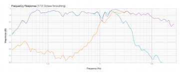

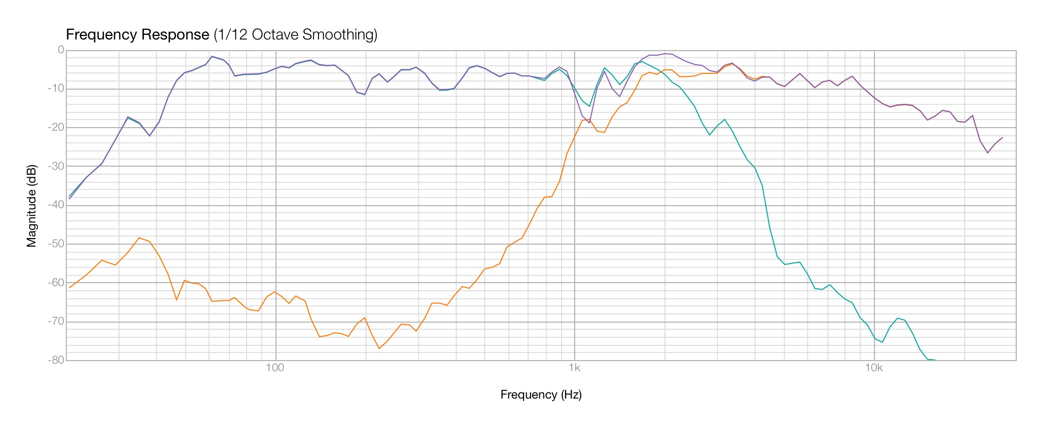

Here we go. Measurements were taken with 1 meter distance microphone to baffel so there is some room interaction. All three measurements include the crossover.
Nicely presented charts.
Wise if kaputt also did measurements at some other points in the room, esp where he/she sits. That's my reference point because it takes the room into account.
Anybody ever ask themselves, "Why must the woofer and the tweeter have the same crossover frequency?" You might ask that question after looking at the kaputt's data.

There already is some room interaction in there, as I wrote. As the topic was crossovers it would be preferable to have graphs without room reflections.
I'll do a response graph with the microphone in my listening postion (which is more of an area, as I'm quite casual about it ) as I guess there is some value to it in regards of connecting my data to subjective sound impressions I gave.
They don't and picking a lowpass with a lower cutoff frequency would have dealt with that bump at 2k. But after all it's so little that I don't care. Changing the graph's smoothing to 1/6 octave fixes that nicely anyways
I changed the 7uF cap in the low pass filter to 9.2uF which flattened the 2k bump.
I'm undecided if I like it better with or without the bump or if I can even tell the difference...
