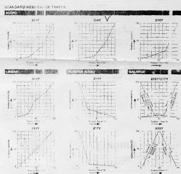

I'm doing this from memory, but best I can recall is that looking at the data sheets that show the taper graphically the "log" tapers pretty much conform to what Rod claims. In fact, the only gaph I recall that looked like a real log curve was some sort of digital pot.

Here you are, the graphs for Nobel. Sorry for bad copy, but I got it by fax.
Those curves are actually pretty accurate. I went through 60 detented mono pots (36 positions). They all measured very close and actually there was no problem matching them in pairs, with less than 0.5db error on each consequentive detent position. I was matching them using signal generator and true dB meter, making readings every 5 steps and noting the value. I did that for Amp-1 implementation.
