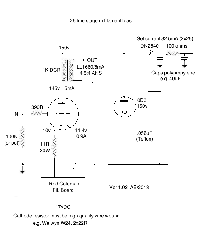

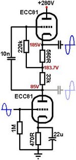

One case for ECC81 mu-follower, other case for #26 preamp, mu follower driving headphones 300 ohms, #26 preamp driving SS 100k input impedance
Wich resistor value is necessary for 2nd pic?
Too load at max volume? Then perhaps you can lower the gain of the first stage. Easiest way is to remove the cathode resistor... Or use a simple cathode follower. Have you seen somewhere these three parts (preamplifier, volume control, power amplifier) recommended together?
