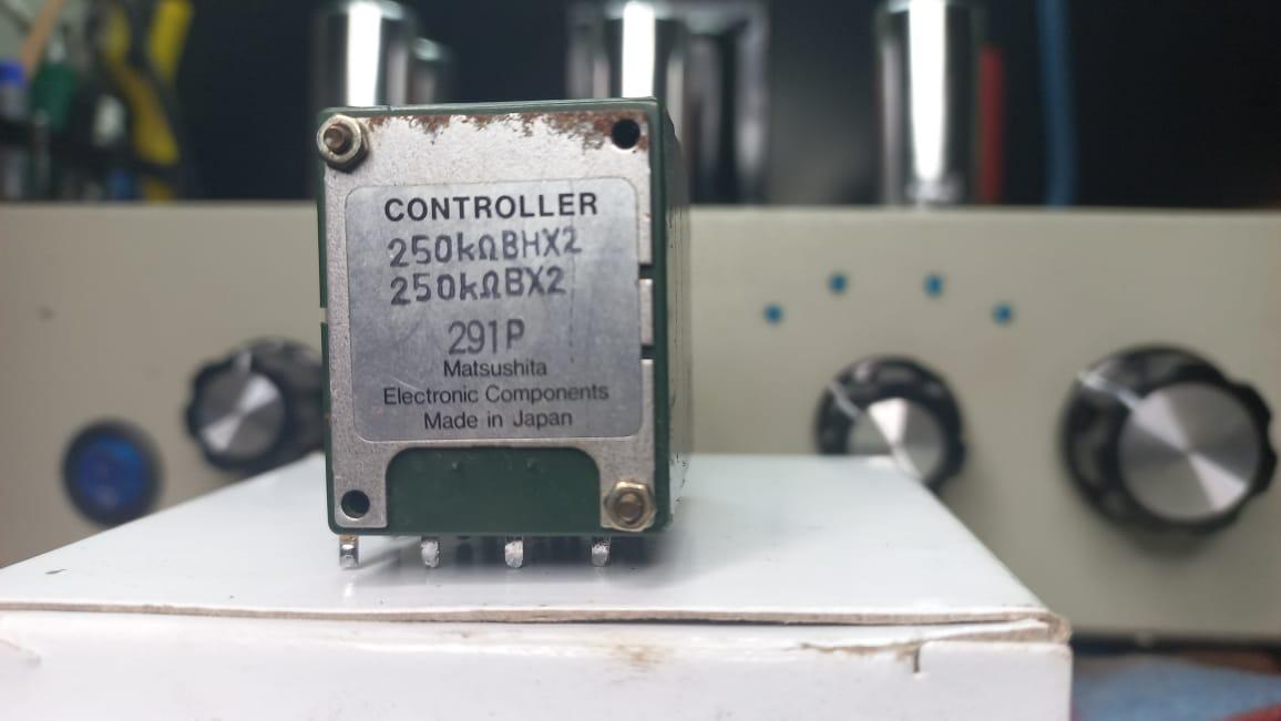

Hello to all, I am new in this forum and you can call me as rafik. The reason for my contact is that I am looking for a part of the NEC AUA 8300E amplifier, specifically the VR201 pot, part number 41950295. Please, if anyone has it or can suggest where to get it, I will be very grateful.
I look forward to your positive reply. Many greetings.
Thanks in advance to everyone.

Is this a concentric volume and balance pot with loudness taps? Could be hard to find except from the OEM, but have you tried to open and clean your existing pot? I would recommend Caig D5 to clean the contact surfaces and a light grease for the bearing surfaces.

Hello Chris, I apologize for responding recently to your interesting recommendations. I really appreciate your help.
Yes, I disassembled the pot and it was full of grease and dirt. With the cleaning I managed to get 243k ohms in the last two gaps. But in the first gap I couldn't get 0 ohms in its initial position and in the final only 238k. In the second gap I get 0.32 ohms and also 238k. These last two gaps work in reverse right?
One question please, would you know what the tolerance of this pot is?
Thank you very much for your help, you are very kind.
