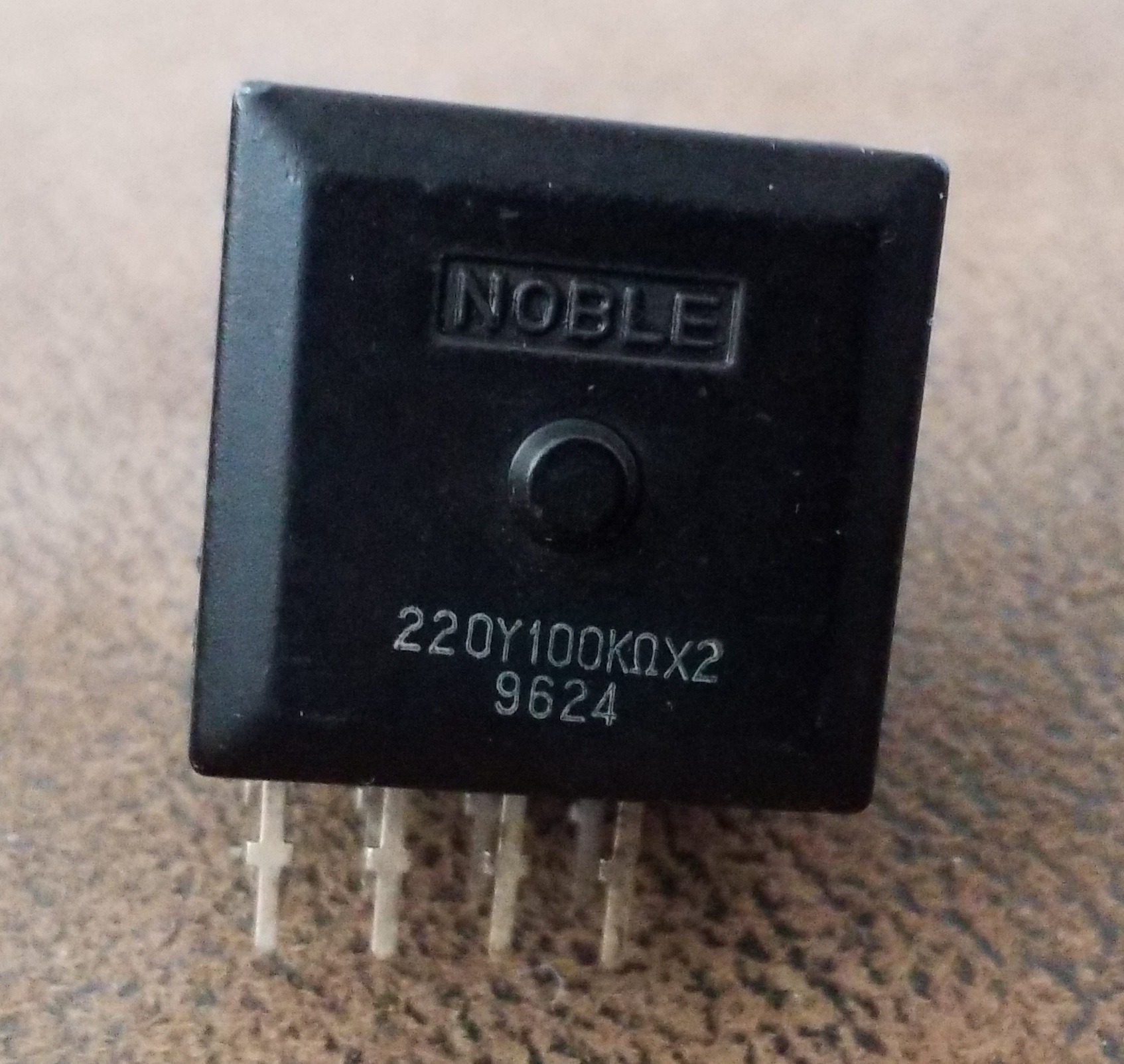

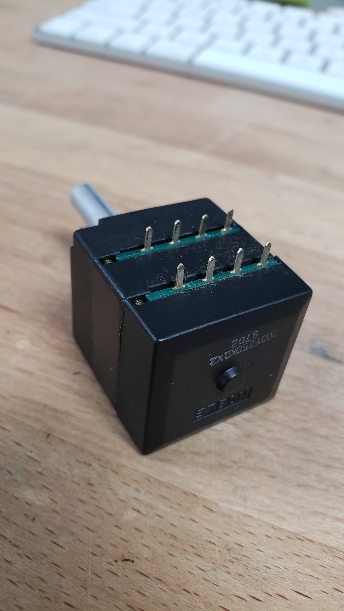

Hi, can you please tell me what kind of pot this Noble AP25 is ie. volume, balance, etc? When I measure both sections, they don't behave like a standard volume pot. I cant find any specs on line for it either. It was sold to me as a stereo volume pot with loudness tap pins, but it doesn't behave that way at all.
@chrisng Each deck of the pot does the exact opposite of the other. On the first deck, the resistance between the center wiper pin and the far CW pin stays close to zero ohms until the wiper is centered (12 o'clock), only then it starts to increase and goes to 100k in reference to the CCW pin. The second deck does the exact opposite, starting with 100k at full CW, going to zero ohms at wiper center (12 o'clock) position and remains at zero ohms for the remaining rotation all the way to CCW. This is why it behaves like it's a stereo balance pot. The 4th pins don't do anything and aren't connected at all.
