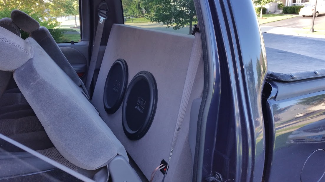

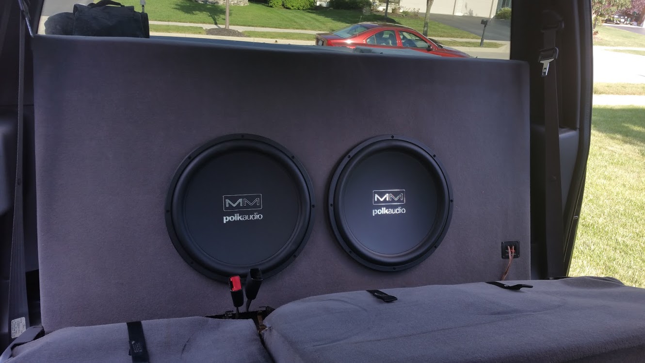

You guys got me missing my truck. I had 2 of those MM1540DVC's in it.
