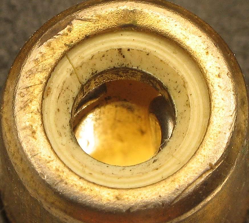

You can't go by the way the connections look on the board. Desolder the connections (add new solder, desolder and resolder). If one of the posts is broken (a common problem on some jacks), it will be obvious when you heat the connection.
If the solder connections aren't the problem, the contacts are probably loose inside the jack. These jacks use wire to contact the center conductor of the RCA plug. The wire is wrapped around the center of the connector. You need to bend the wire inward (towards the center of the hole) where it turns 90°. If you bend the free end inward, it may get pushed back into the center and cause problems. This is easier to do with the jacks off of the board.
the connectors on the inside were a little loose but ultimately it turned out to be a broken solder joint.It looked good but the second I unsoldered a few of the other connections this one just pretty much fell through the board.Thanks for your help Perry. Another valuable lesson learned.
