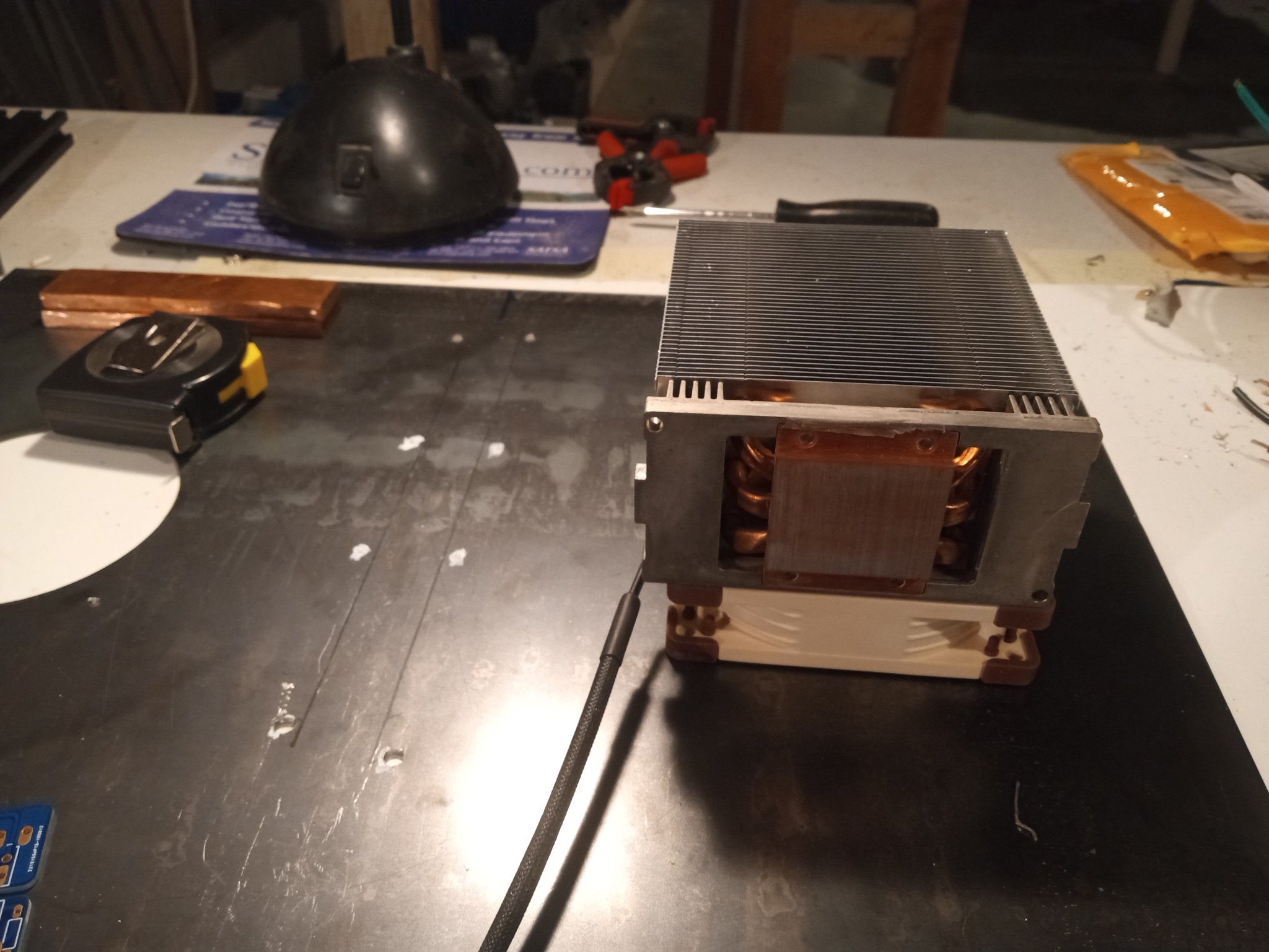

Making a bit of progress on my dual mono setup. I have mounted the CPU heatsinks onto the Noctua F9 fans. Just for grins I hooked up the fans and gave them a listen. They are very quiet, even at high speed. I now need to attach some Mfets to the cpu heatsinks. I have a lot of Molex minifit sockets and receptacles I would like to use up, so have a couple of questions:

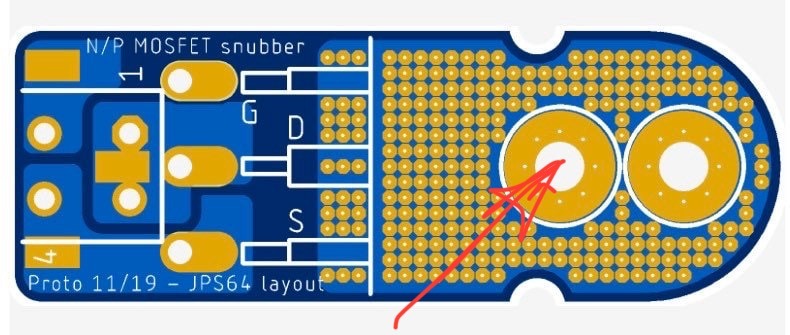

Are you asking if it’s ok to install both the gate stopper resistor on the main PCB and on the snubber board? No, not a problem. Really not much difference between 100ohm vs 200ohm on the gate stoppers.
The snubber boards that look like a tombstone were meant to act also as the mosfet clamp washer. They are 2mm thick and very stiff. Use them above the mosfet and the M3 bolt should canon the snubber down with the MOSFET underneath it.
Line up the hole on the MOSFET with the hole indicated in red here and that lets you use it as a clamp washer.
You can solder wires as flying leads to the rectangular pads or to the holes. I find that there is less strain on the wires if they lay flat along axis with snubber.

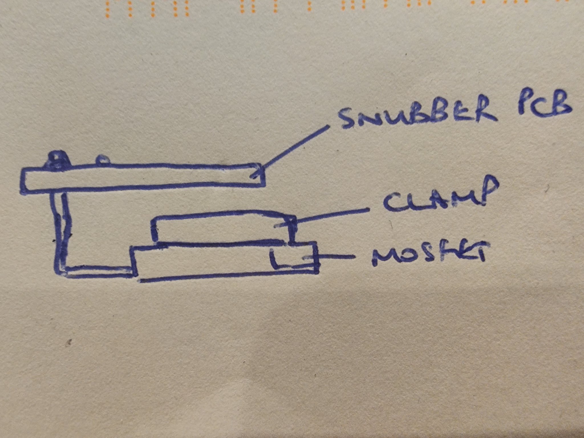

Myles it sounds like you will do things how I am and here is my suggestion. Sorry I don't have a photo yet as I haven't actually got the snubbers in place yet. Ongoing job. Minimise the gap between the clamp and the mosfet. Insulate against shorts if needed. And like X said id have the wires running along the axis of the PCB, not in the holes at 90degrees.

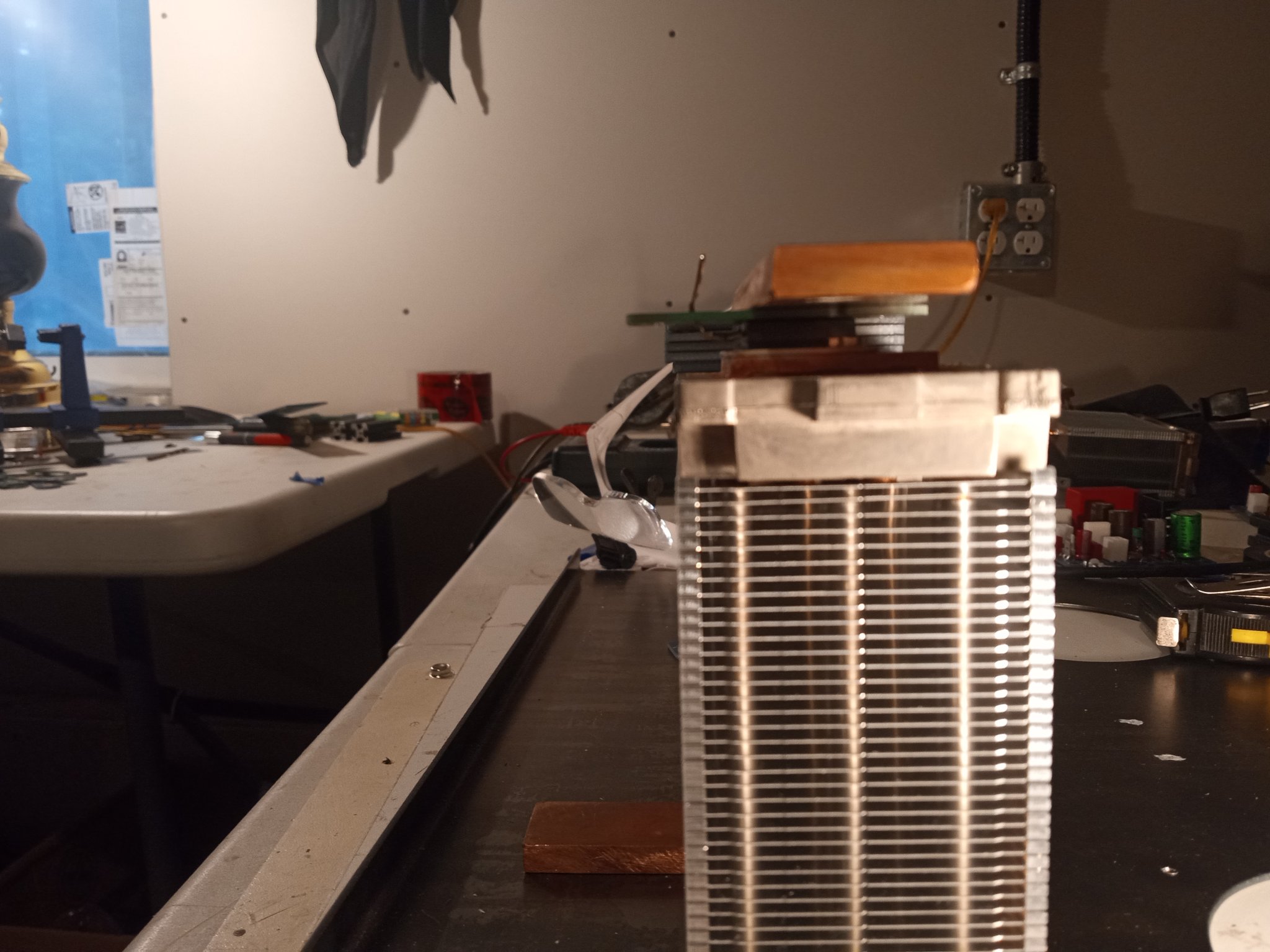

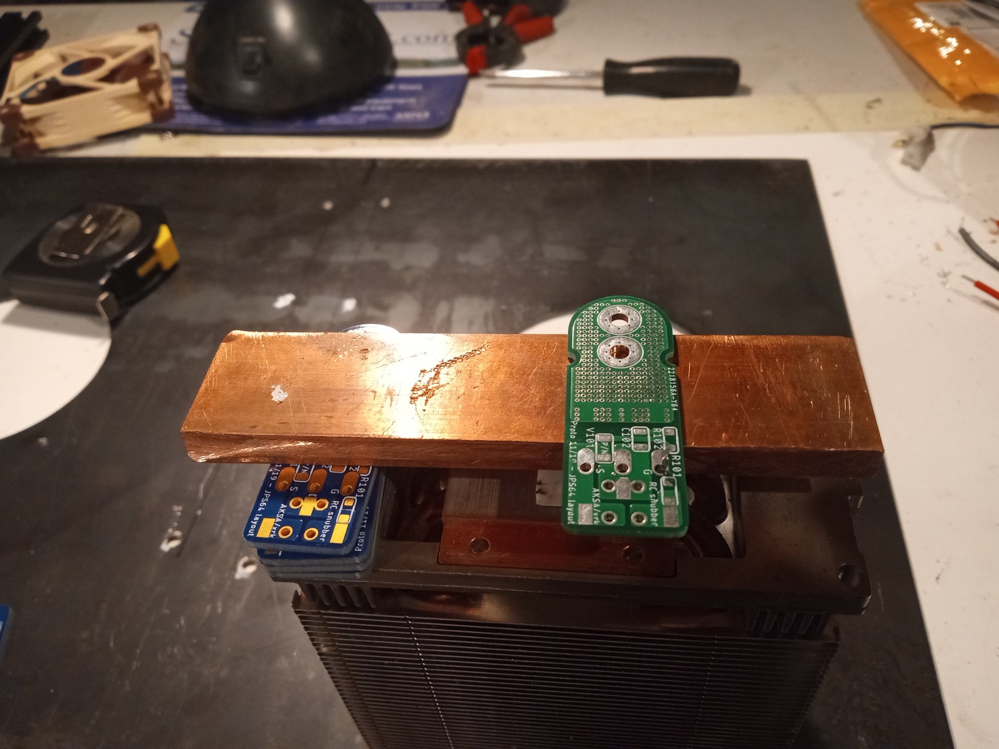

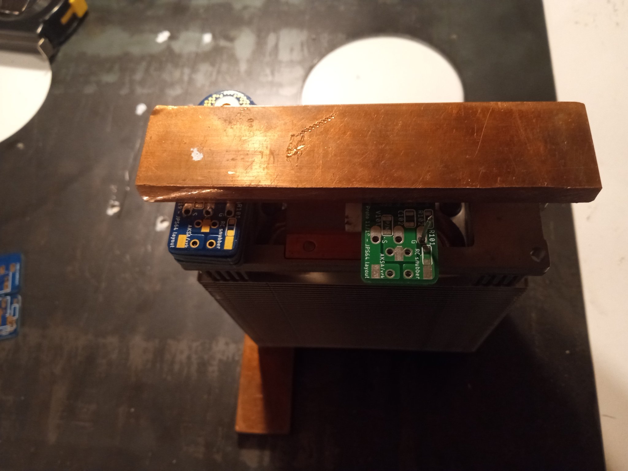

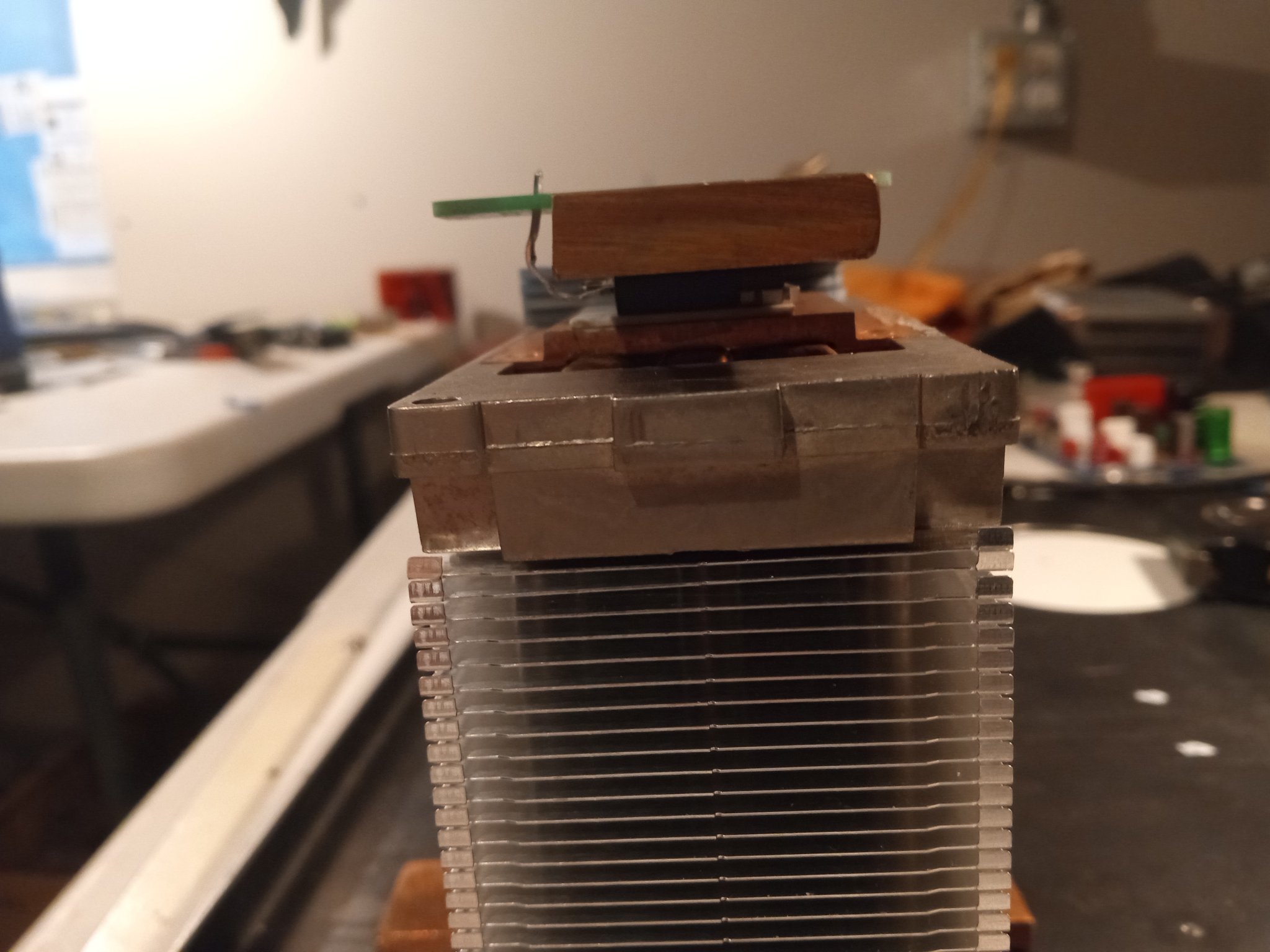

Thanks Jim for the info. In an effort to show what I am working with, please see the attached mock up's of my layout and your layout. Focus on where the Mfet is, as there are other snubber boards used, just to level things. Image from left is the fan/hs layout, next is Jim's top view, next is Jim's end view where the clamp is against the Mfet and snubber board on top.
Below is a top view and end view of my mounting procedure with snubber board against the Mfet and clamp on top.
I am not sure which way to go: Using Jim's layout the Mfet legs stick up thru the snubber board with no problem. Tapping the copper to hold the snubber board could be a problem. I may be able to attach a spring type clip to hold the snubber board in position.
Using Myles's layout the Mfet legs stick up thru the snubber board with no problem also. It may have a potential problem with having enough clamp down force to ensure Mfet and snubber board do not move around. The copper clamp I will use weighs a fair bit on its own, so clamping force applied may be minimal.
Comments and suggestions are welcome.
MM

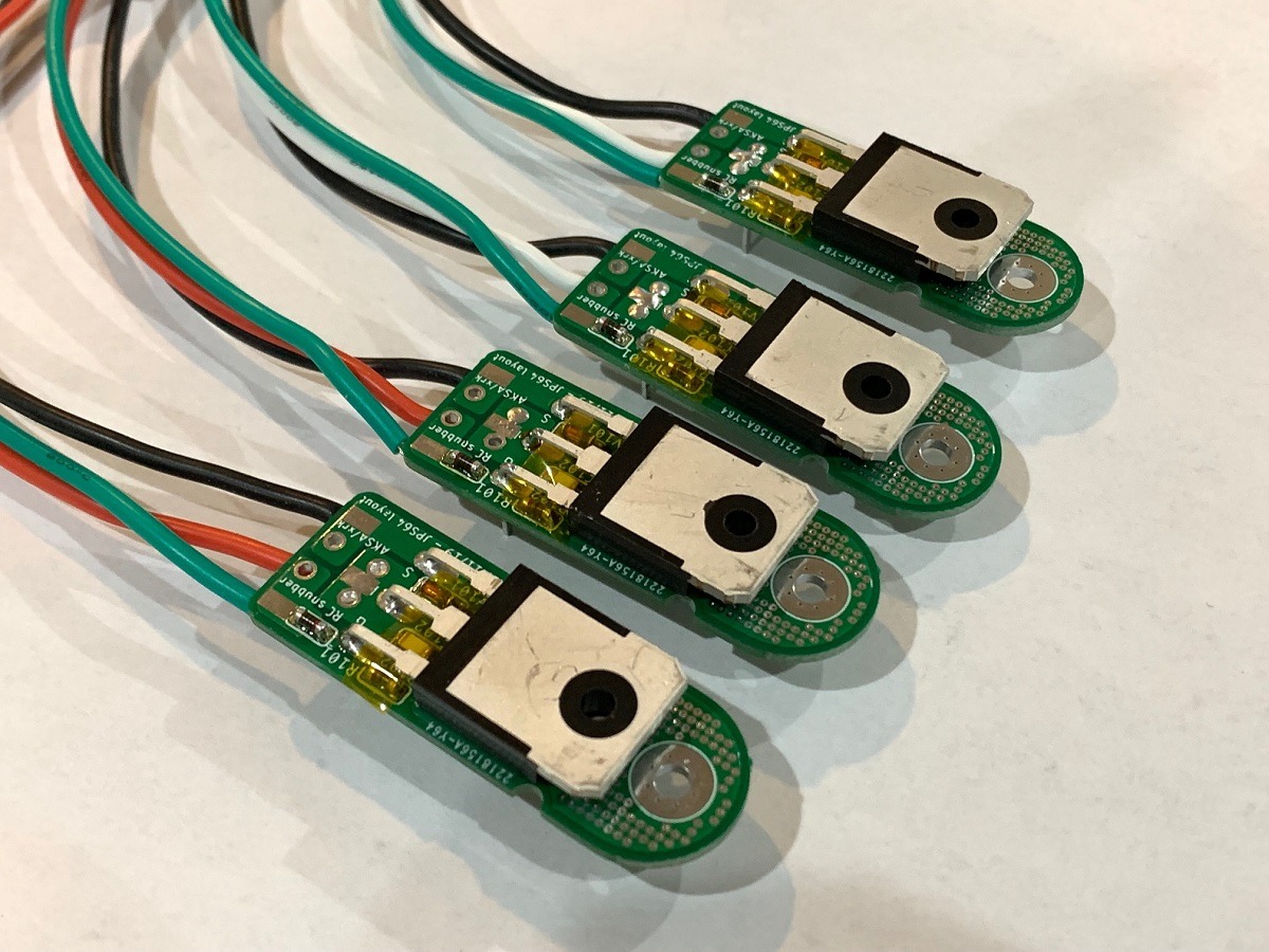

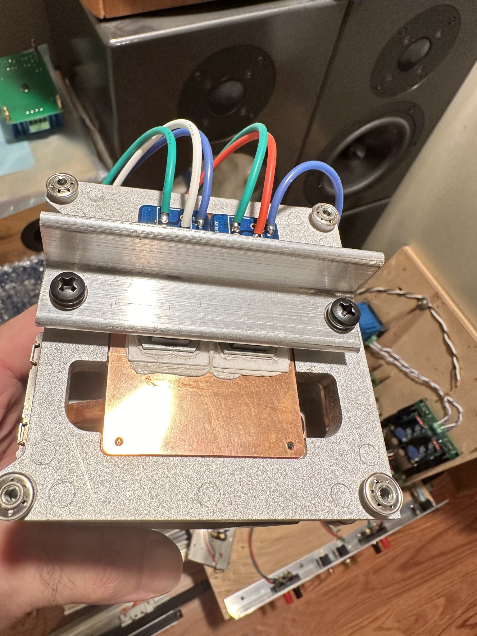

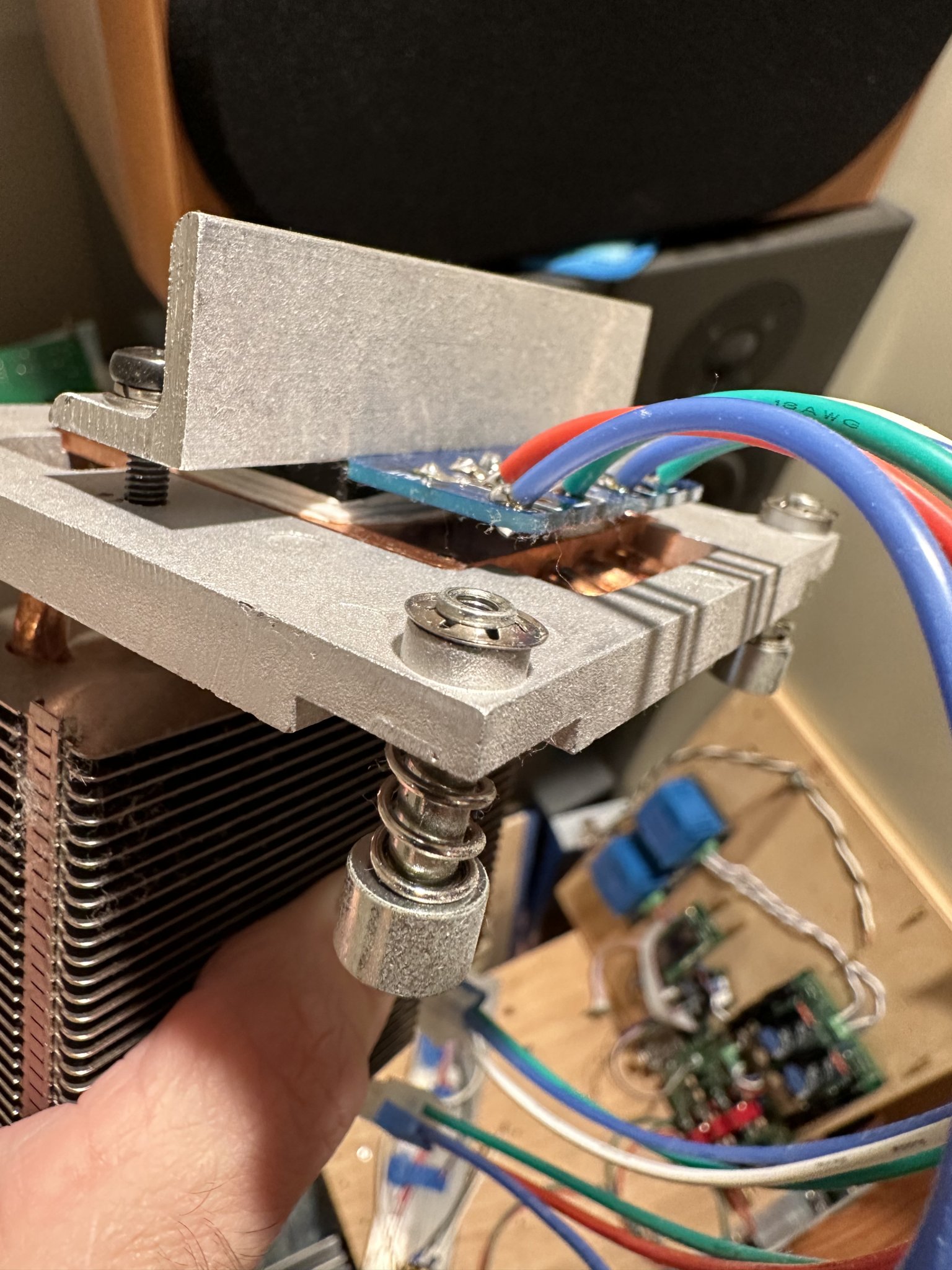

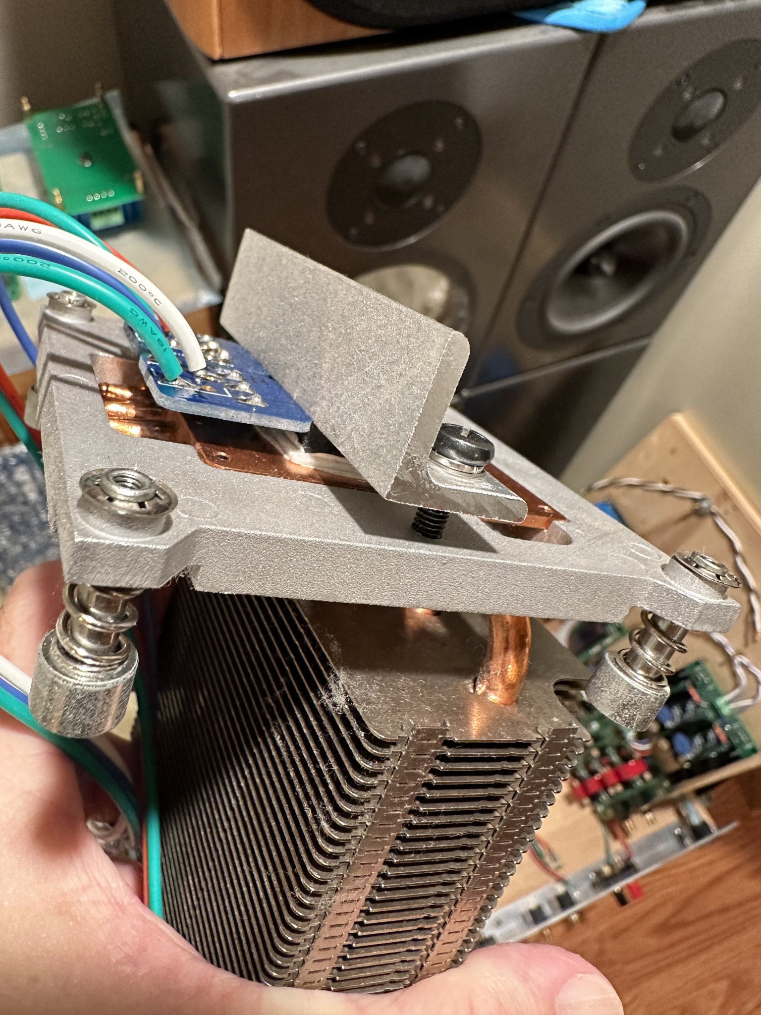

I believe you’re overthinking this setup Myles.
Forget the copper bullion as a clamp. Aluminum angle won’t bend, drill and tap M4 holes in the aluminum base for the clamp fasteners.
Use the little blue boards and solder the snubber components directly to the legs.

Joined 2010
Hi Vunce,
Thanks for the info. I know you are a big proponent of the angled aluminum. The piece of copper I have is 1/4" thick and about an inch wide. Over the width of the heatsink, I do not expect any significant bending. I will drill the copper and drill/tap the aluminum. I need to use up inventory I have rather than buying more, but, just in case the copper does not work , please remind me of the dimensions of the angled aluminium, especially the thickness.;)
I do like the idea of attaching the blue helper boards to the Mfet legs and I happen to have some of these in my inventory. From your photo's I gather that the resistors, caps, diode, are soldered on the bottom of blue boards ?.
Since my heat sinks will be laying horizontal, the Mfets will be mounted vertically. I plan to use Molex connectors / cabling. This brings a choice of mounting the Mfets / blue boards facing upward or downward. Any advantage cabling / strain wise for either mounting direction (ie: wires hanging downward or wires on a slight incline to the amp boards. ?
Thanks for the help always, sorry to ask so much
Myles
