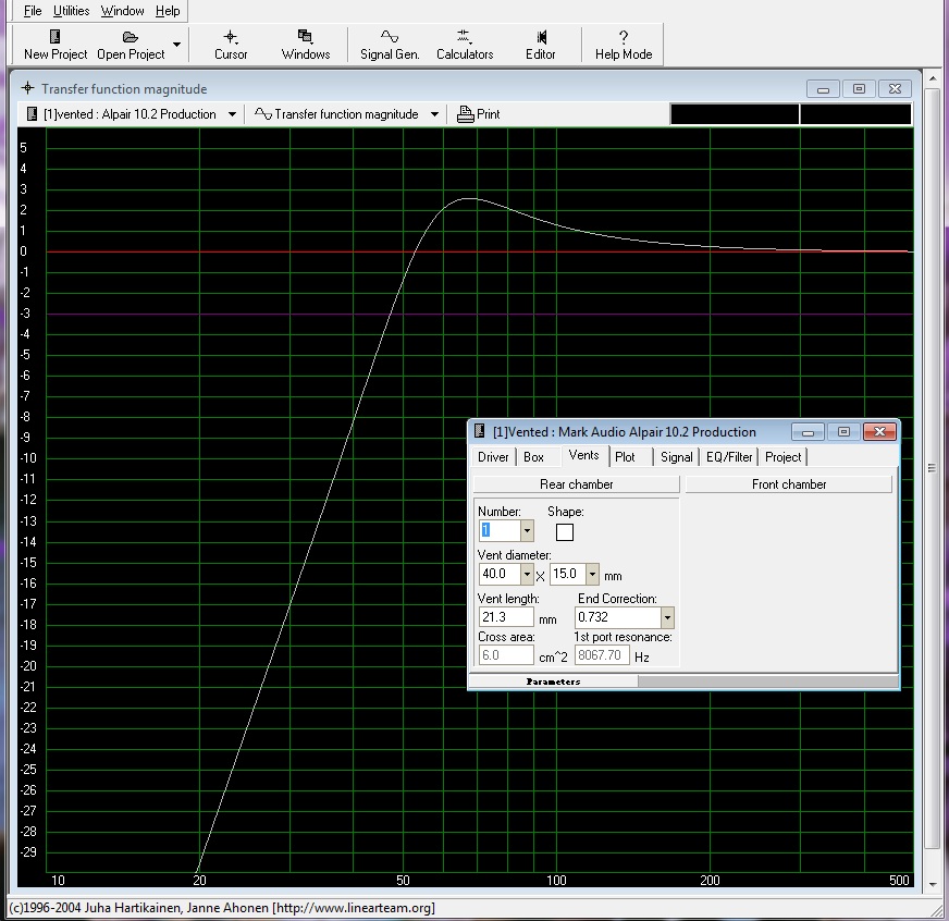

May be the total volume of CGR Mar-Ken 10.2 is less than BR box, but it looks larger because of this wide front panel and it is not fits very well with the speaker stands I have
How's this?
SSP Mar-Ken10.2
dave
Hi guys. I am online again. Firstly to Jeff: yes, a get near the same results from WinISD. Then I rearrange port (two ports: H*W*D = 15 * 63 * 140 mm each). The things become better but not even close to the Mar-Ken A7.
Now to Dave: Yes !!!, This is exactly what I was looking for, but can't find. Dave, can I use this design - is it freeware or I should donate something ? Please, tell me - this is perfect fit with my speaker stands and perfectly fits in my room! Thank you Dave and Jeff. Andrej
