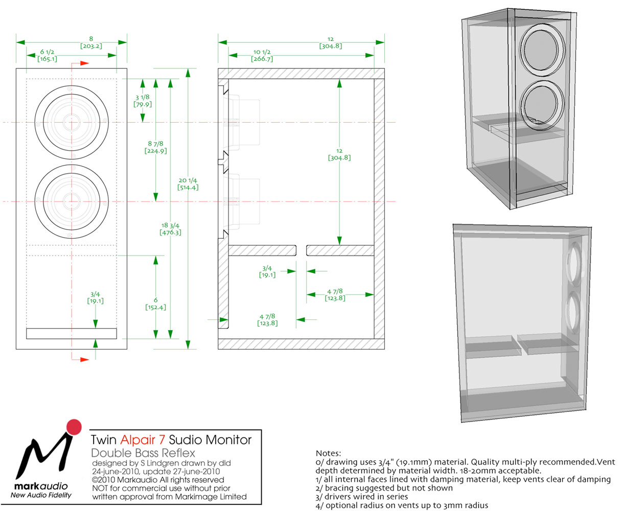

Hi Guys,
Scott and Dave have kindly burnt the midnight oil to make a full drawing of this Twin. I'd recommend following this more accurate drawing rather than the initial sketch based plans.
Cheers
Mark.
Cheers
Mark.

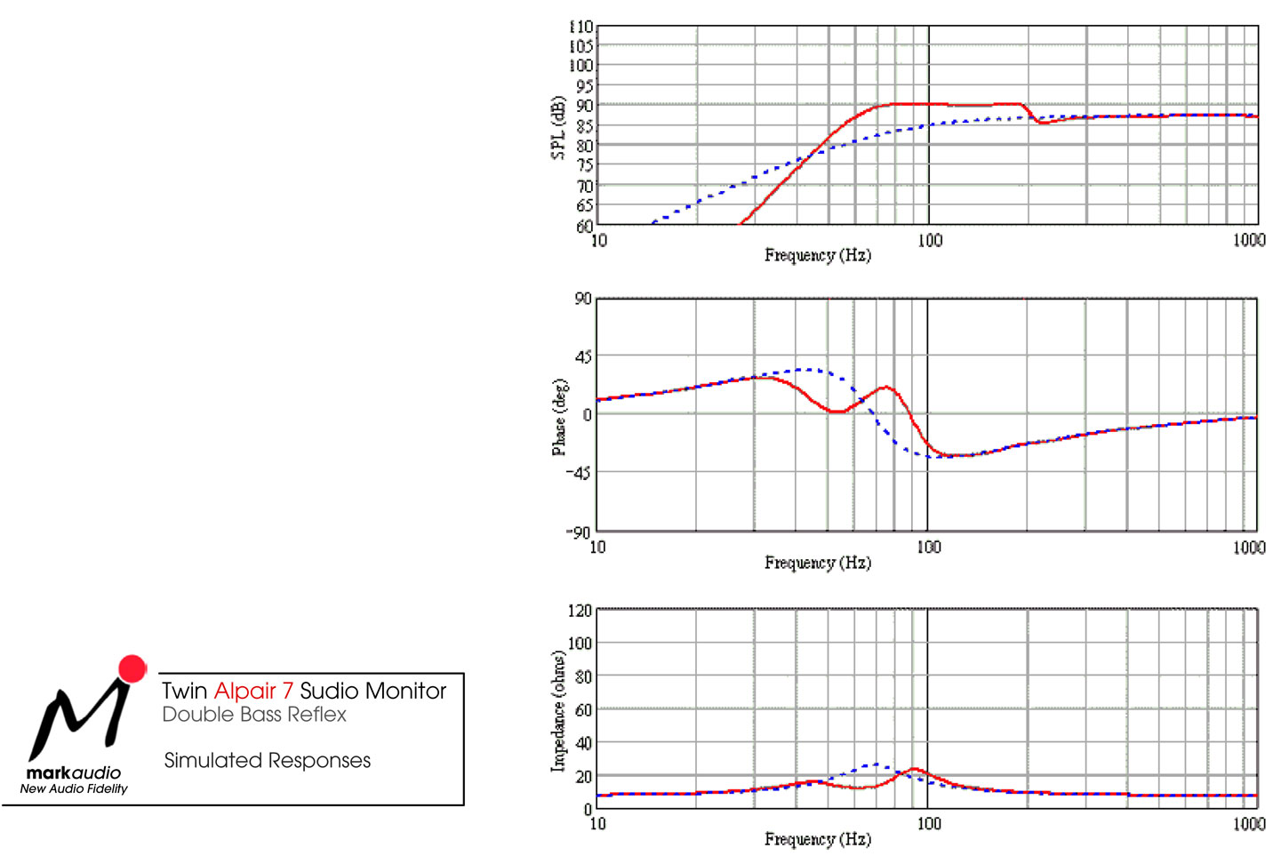

thanks Mark. What is the frequency range for this build?Hi Guys,
Cheers
Mark.
Hi Apt,
From memory, should achieve 40Hz ish to 30-kHz but Scott is the the best fella to answer this. Could be one more reason why it might be useful to experiment with the damping (removable rear panel). Again, Scott is the better fella to ask.
Mark.
What about the alpair 12?
Hi Apt,
From my memory, similar low end and running to +20-kHz.

Hi Guys,
An up-dated version of the Alpair 7 Twin Studio plan can now be down-loaded from Post No.20 on this thread:
http://www.diyaudio.com/forums/markaudio/169016-alpair-7-twin-driver-studio-monitor-plan-2.html
Please ignore and/or revise all previous sketch drawn plans in favour of this download.
Mark.
Mark.
