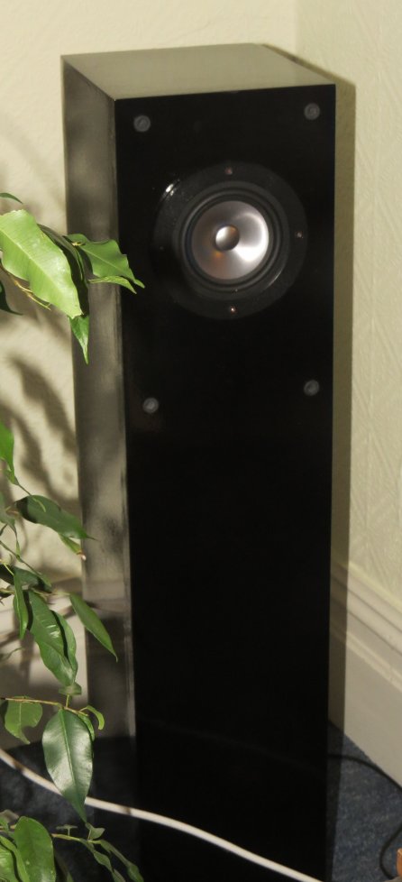

Regarding the enclosure, there is a decent volume and depth behind the driver. When it was made, I positioned an internal panel/brace close to the rear in such a way as to reflect sound down into the cabinet and away from the driver cone as much as possible. Listening tests at the time confirmed that this made a very noticeable improvement in clarity. I am a little surprised that I do not see similar arrangements occasionally in other people's designs as it worked excellently for me in several BR boxes with a variety of drivers.
By the way, the cabinet is based on the angular spiral horn concept developed by Masaaki Takenaka. The exact dimensions and design were developed by me through experimenting and tweaking to work well with the FR125. The operation of the spiral horn, if I remember (and understand) correctly was thought to be quite similar to that of a bass reflex, but with stronger effects over a wider range of bass frequencies. This is what led me to entertain a hope that the A7.3 might drop in. The bass response is not at all a disaster in this box. It is just that after a week or two of listening, and also reading about the A7.3, I feel the driver could do better in a different setting.
Masaaki Takenaka has now removed most of his webpages relating to the spiral horn idea as I think he has developed something that he prefers. This page gives the general idea, although mine is a larger floorstanding type as the photo shows:
