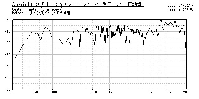

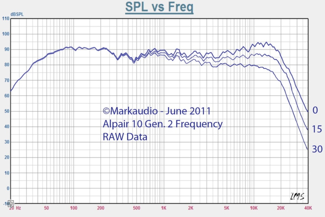

10.3 from taobao store for comparison (broad notch filter 0.4mH || 0.6uF centered at 10khz starts working on the HF plateau from 5khz and 16khz, leaving just a little brightness).The manufacturer's published graph of the 10.2 does not show a peak at 8 kHz, so I don't think the driver is the only cause.
Incidentally, 10.3 also has a large peak at 8 kHz when measured with smoothing off, but it does not bother me at all when I listen to it.

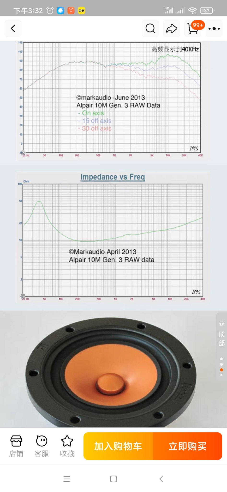

Well the three charts (two from #6) are remarkably consistent modulo smoothing; all showed the plateau 7-14khz. Raw on-axis, I can confirm the 10.3 highest spike was near 8khz but hearing sensitivity falls off above 10khz.

AFAIK this 10.3 chart is the only one with off-axis curves.I find it really interesting that the taobao store has off axis charts and none of the drivers on his main website does. Do you have a link to the store wchang? I’d love to see it.
