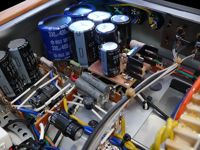

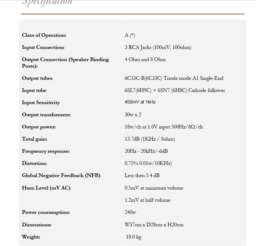

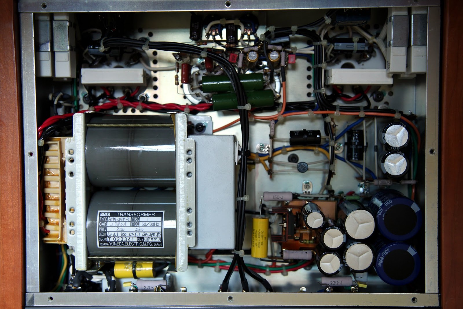

Hello folks,
I need to make a couple of simple repairs to my Almarro A318B SET integrated valve amp ([FONT=Courier New,Courier,Monaco]2x6C33C, 1x6SL7, 1x6SN7)[/FONT]. Namely changing the selector switch which is intermittently causing issues plus the IEC socket which has a crack in the plastic casing.
While I am in there I wondered about the potential for any simple upgrades by swapping like for like components. A few years ago I swapped the coupling caps and this was a huge step up in performance.
I have already changed the input valves after tube rolling with a small selection of valves.
Is there anything else that could be achieved with a simple swapping of components for better quality ones. The power supply caps perhaps? Could these be uprated by 10% or am I risking damage here and playing with fire? Would swapping for better quality caps at the same rating be worthwhile?
I have attached two images of the amp plus the specs and the schematic which is included in the manual (input and output). Unfortunately I cannot find a schematic for the PSU.

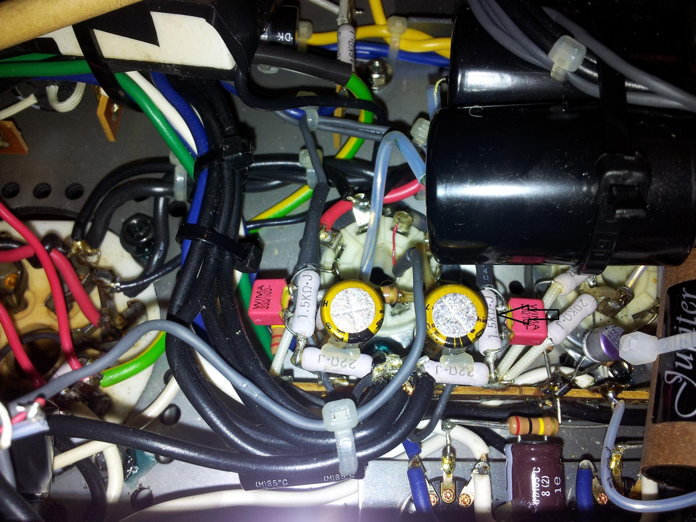

I got inside the Almarro A318B yesterday and completed the following work :
- Channel Selector Switch
replaced
- 250K Volume pot replaced with 100K stepped shunt pot
- IEC socket removed and captive power cable installed
- 0.22uf coupling caps replaced with Jupiter Copper Foil Paper & Wax Caps.
- 100UF 160v Electrolytic Cathode bypass Caps on 6c33c output tubes replaced with 100UF Jantzen Cross Polyprop film caps.
- 100UF 16v Electrolytic Cathode bypass Caps on 6SL7 input tube replaced with 100UF OSC-Con SEPC polymer caps.
To fit in the large 100UF Jantzen polyprop caps in place of the electrolytics on the output tubes I had to extend the wire from the valve pins, I also had to move the two parallel 0.1ohm 15 watt resistors that were across the output tubes so that these could be placed elsewhere in the amp to make room.
I finished quite late and only had a brief chance to switch on the amp due to work commitments today but I had quite a large channel imbalance. I checked the volume pot wiring and all seemed well there.
Is there anything about the above work that would cause this asside from an error in the soldering work?
I do have suspicions about one of the output tubes and also one of the 6SN7 input tubes and will check these when I am home again. One of the output tubes was running way over the recommended bias voltage when I powered up and checked this. The 6SN7 has become increasingly noisy over the last few weeks upon switch on and the noise goes when I put an old 6SN7 back in that it replaced. It does however seem a bit of a coincidence that one of the valves would fail and cause an imbalance just after I completed this work.
Many thanks in advance any input would be greatly and humbly appreciated!

I would still suspect the volume pot and/or wiring of it.I had quite a large channel imbalance. I checked the volume pot wiring and all seemed well there.
A bypass cap not properly connected on one channel could be the culprit as well.
But if the volume imbalance changes as you turn the volume knob...that would be wiring of the volume control.

I changed all of the valves last night and I am still getting a significant imbalance. I measured this at the listening position to be sure and saw a drop of roughly 8db. I had the pre mod measurements to compare to also.
I have noticed that over the last year my system does have a bias towards the left side which I have battled with often using speaker placement. it is now however much more significant and unworkable.
It also noticeable that there has always been a very feint transformer hum on the speaker that is connected to the louder channel, the quieter channel has never had this feint transformer hum but has always been a little more noisy.
- Anyhow, perhaps these are red herrings. I got inside the amp and checked the pot, at all steps I am getting the correct series and series to ground resistance and checked these against the attenuator calculator which showed the values to be within 1db of each other.
- I got inside the amp to check my soldering and various connections, everything appears to be correct as I compare the "bad" channel to the "good" channel.
- I then thought to check the resistor values against each other channel to channel around the input and output tube sockets and everything checked out apart from one resistor which I cannot seem to get a reading on at all with my multimeter probes. This 1.5k resistor is close to the 6SL7 (6H9C) first stage input valve and does not appear to be shown on the basic channel schematic. The 1.5k resistor opposite tests fine but I either get strange low reading or no reading at all across the reisistor with the arrow in my attached image (schematic also attached again).
If you could pass any comment on this particular element that I have identified that would be greatly appreciated!
I intend to obtain a meter to check all of the capacitors as my meter cannot check these with its test probes. I guess that if one of the caps is leaking DC however the only way would be for the amp to be powered up while testing which of course is a whole other thing to consider.
Many, many thanks again in advance.

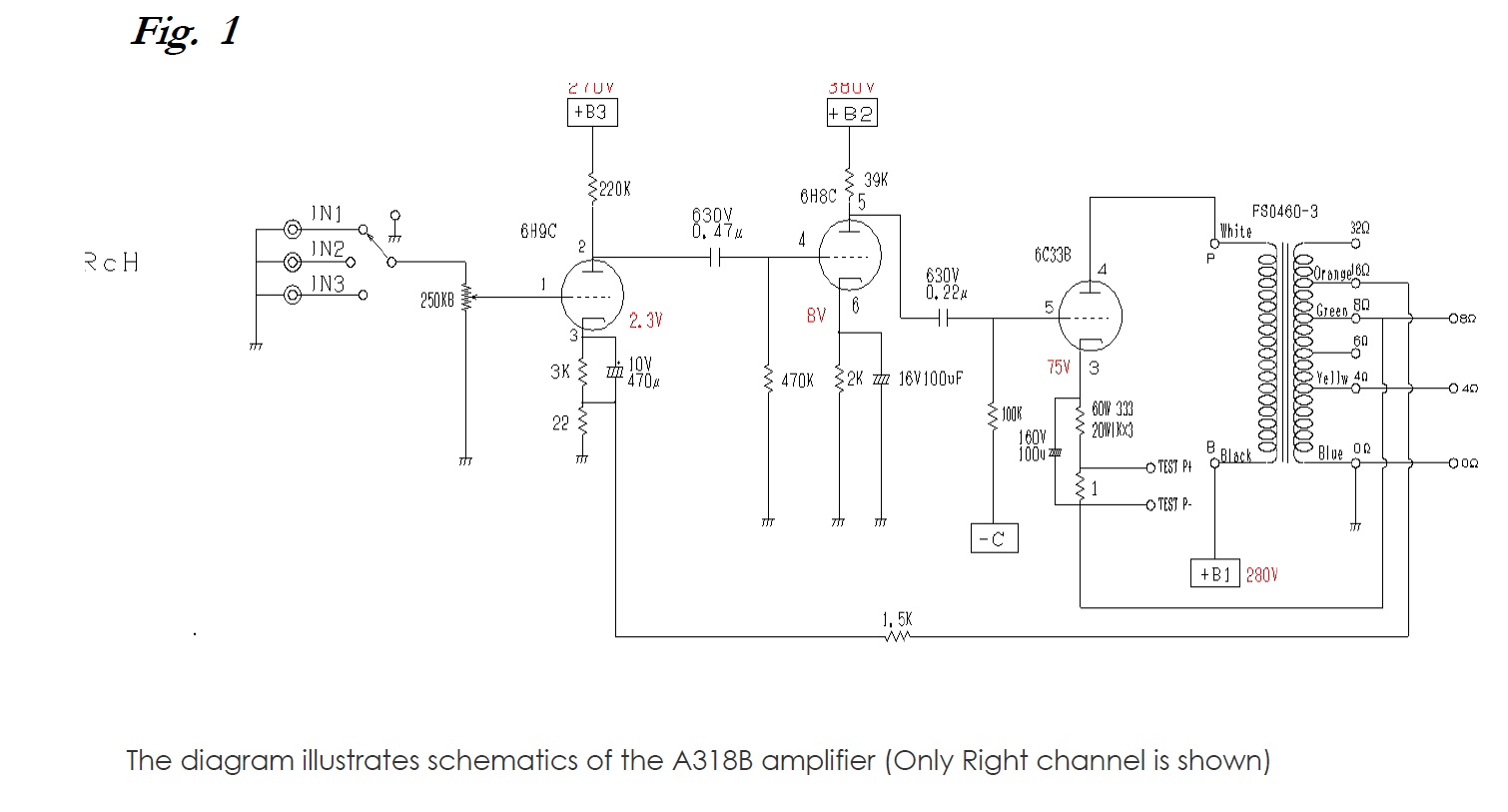

Looks like that is the 3k cathode resistor on the schematic. Probably went to 1.5k for a better operating point.
They should obviously both read 1.5k +- 5% or so. You could also try to measure the voltage across the left and right cathode resistor (1k5)
I suspect the cathode resistor bypass cap could be bust (unlikely because of the low voltages there..but more likely than the resistor not being ok anymore).....maybe heat did it in....so try to solder it out and measure again.
That could well be your problem. (Which was perhaps masked by an imbalanced potentiometer).The 1.5k resistor opposite tests fine but I either get strange low reading or no reading at all across the reisistor with the arrow in my attached image
I think that 1.5k resistor is your feedback resistor. Now, that would definitely skew your balance if it were shorted! That Wima cap that is in parallel is the feedback compensation cap. It's a polyprop, which usually fail open, but you could solder it off to check if it's the cap or the resistor that's shorted.
O...yes you are correct!I think that 1.5k resistor is your feedback resistor
