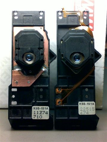

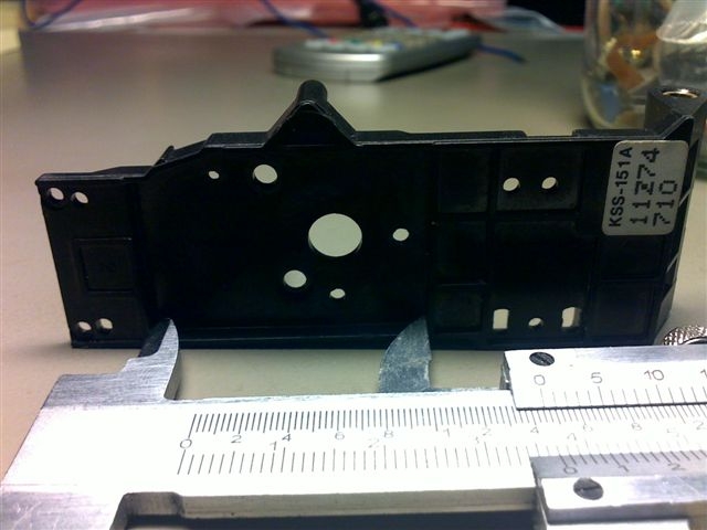

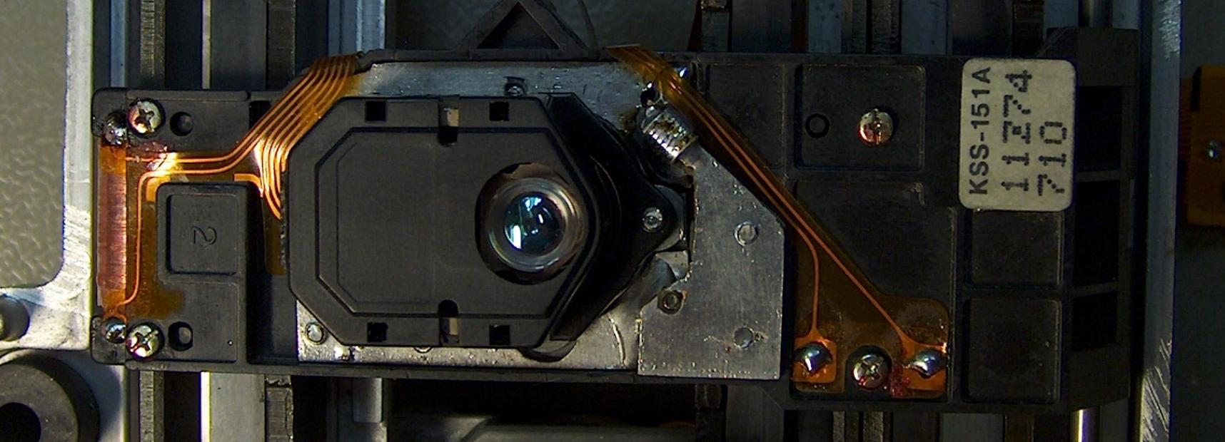

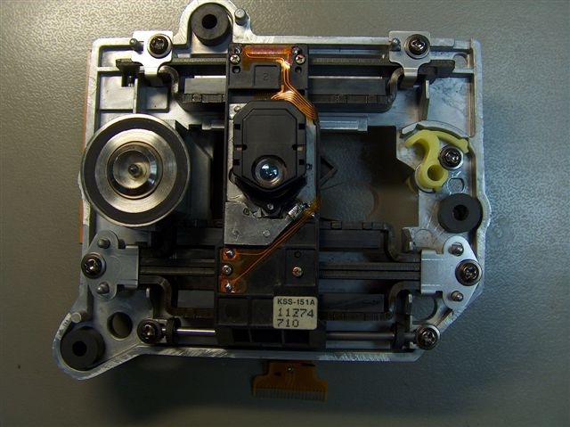

Where to find new KSS151A - no where...
Sometimes late at night...
Idea to marriage KSS151A + SOHOT4
My loved cd93 is working now
