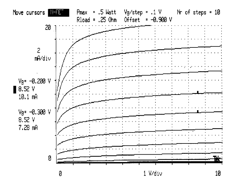

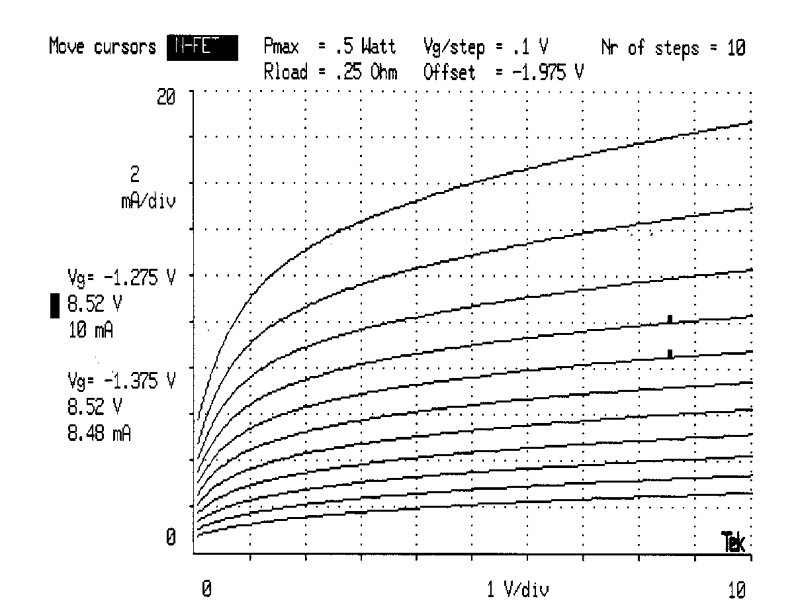

I found not one but two working Quantech's a couple of weeks ago so I plan to finally nail down the low frequency noise on some of the currently available FET's. You can find or make little conversion boards for SOT23 to TO92. This doesn't help with the sorting. If your circuit forces a constant drain current the need to sort is lessened.
I got the idea of checking out the BF862's from the guys over at LT. It has a pretty unreal gm/C figure of merit. My initial use was for a condensor microphone where the 1/f is masked by the bias resistor noise. It needs to be checked for use in phono apps.
There is no free lunch, most of these high gm FETs suffer from excess gate current at high Vdg including the Linear Systems LSK170, BF862, 2SK170, and J310. This is impact ionization, a short channel effect.

EC8010 said:Talking of J110, the linearity is poor; considerably poorer than LSK170 (for example).
Scott: Would you care to expand on your noise comment?
Initially I saw the BF862 in a couple of LT app notes boosting the performance of low noise photo-diode circuits. I thought they were really onto something, it had 1/3 the capacitance and the same sub-nV noise of some of the exotics. When you use it as an impedance transformer (like a condensor mike) the source impedance is really high at low frequencies. A typical high-end capsule might be 50pF || 1G Ohm. This means the source noise does not approach the FET noise floor until the kHz region and furthermore the roll-off is an RC one which is twice as steep as 1/f. So if the FET had a 1kHz corner it would get buried in the source noise. I need to measure the noise at low frequencies in a low impedance circuit. As of yet I have only confirmed that their process seems very clean and there is no popcorn or other gross noise anomolies.
BTW there is "clean" 1/f behavior that is based on first principles where each device exhibits the same limit, as opposed to someone being able to make the same device with no 1/f noise. This can happen with JFETs as well as MOSFETs (where it is better known).
The J110, if biased with sufficient current, has enough linearity for low level work. The thrust of this thread was never J110 vs. 2SK170, but to find a circuit to get the best performance possible out of FETs like the J110. I'm not tellng anyone not to use 2SK/LSK170 - its a free world, after all (more or less).
