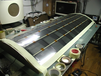

So I have M3s setup...3 9"panels .....so I have opened the panel on the inside
in each speaker...
Big tone....lot more of the magic......biger stage...image....more bal/even sound.....this can be done on any ESL panels.....Acoustat,quad 57s/63 not sure
Sound lab.....no back.....see pic...

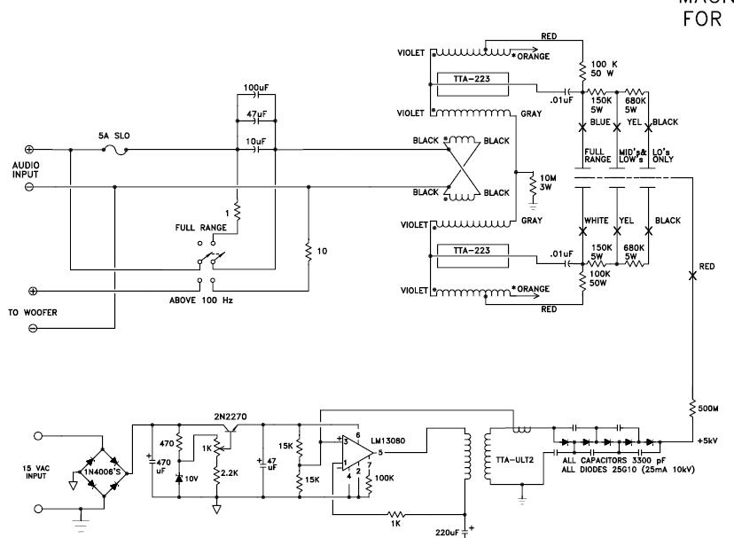

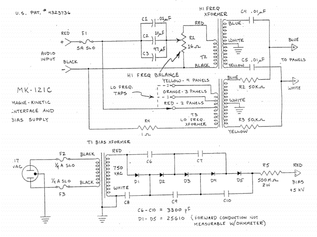

Runing the Acoustat 121 interfaces.... more are less as Jim Strickland setup the Spectra interfaces.... not to give full output...in the bass response......... if you look at the Spectra mixer schematics posted here you well see that the first res that feeds all the panels output res is 100k....with the .01 6k cap.....this is the Spectra fulrang output tap...
I have the Spectra 3....an even when the 100mf cap at the input is bypast..there still no where near the low bass output of the older 121 setups......even if all the Spectra panels input are all ran from the fullrang output point............this is how I run my Spectra 3.....it just sounds better to me......but I have lived with the sound of older Acoustat for over 25 years
An yes I know the 2123 interfaces use diff transfourmers than the 121.
but this is what I hear......when there setup side by side........
The Acoustat 121 interfaces uses a 50k res an the same 01. 6k cap in that same spot in the mixer as the 100k 0.1 6k cap in the Spectra
this 50k res lowers the frc ...vary low....if the 121 50k is replaced with 100k.. you lose lower bass output.....then if you add the 100mf cap on the input...it will move the crossover point up to above 100hz just like the Spectra...
All the Spectra interfaces mixers setup were made to have a 8"-10" driver in the setup to fill in the missing low .....
Now runing the 121...2123 this way with less lower output....an pulling the felt are any backing of the panels well give .....I say about 30-40% more output ...an way better sound.. more even frc response in the room.....that well shock anyone that hears this setup...Apogee,Magnepan,MartinLogan were always my fall back speakers.... vary closes sound to the Acoustats with mods......
this mod...tweek...an yes Voodoo magic..the sound with all open panels.....now the other speakers.... there not even close!

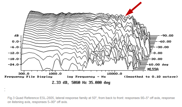

The Acoustats may also have a few upper resonances. (BTW, if you want to see serious treble resonances, look no further than the esteemed Quad ESL-63's, which have big resonance at 11.5kHz and others, somewhat hidden by HF roll off.) I'm seeing one resonance around 6Khz and other in the lower teens. As you go off axis the upper resonances disappear quickly but the highs remain plenty strong at least to 30 degrees off axis, which is the new angle I'm experimenting with.
… if you want to see serious treble resonances, look no further than the esteemed Quad ESL-63's, which have big resonance at 11.5kHz and others, somewhat hidden by HF roll off.) I'm seeing one resonance around 6Khz and other in the lower teens...

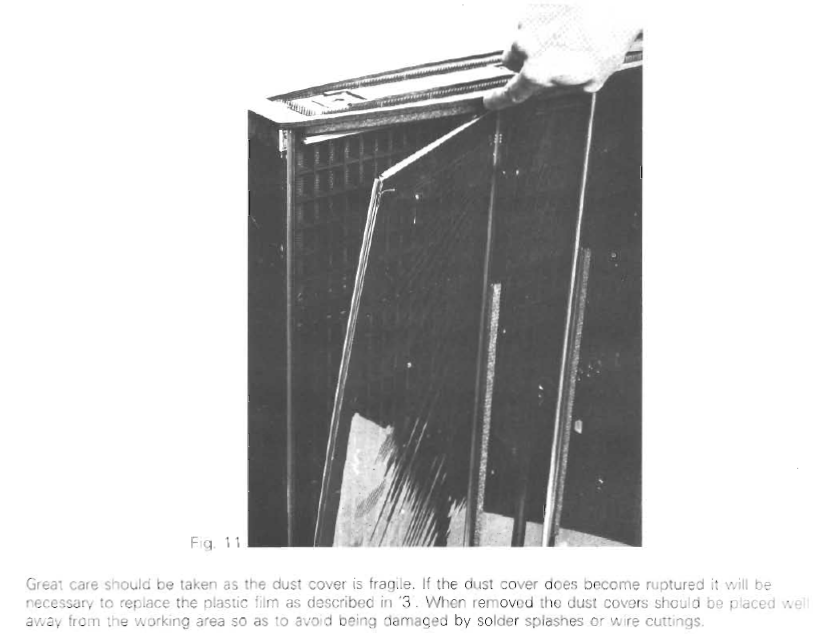

From your description it sounds like your Quads are in their stock configuration with front and rear dust covers in place? The majority of the peak-valley behavior in the top two octaves of the ESL-63 and successors is due to the passive dust cover diaphragms on the outside of the stators. Even though they are only 2μm - 3μm thick they are not completely acoustically transparent in the top octaves, and reflections between the driven diaphragm and the dust covers are readily apparent in measurements. Just to be perfectly clear, the dust covers are Mylar film, not grill cloth. These dust covers are Quad’s way engineering for a long product life by guaranteeing that no dust makes its way into the air-gap.
I know I have read that some owners removed the dust covers to improve top-end clarity.
But, I am not aware of any before-and-after measurement sets showing explicitly the effect of the dust covers on the response.

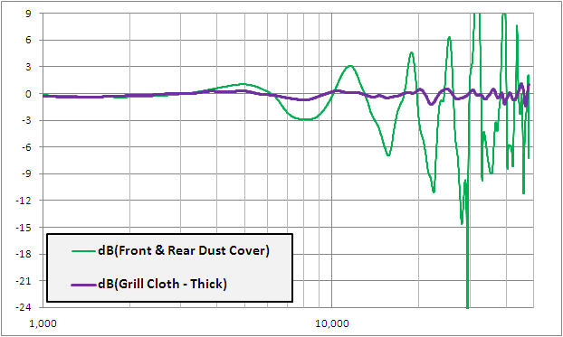

…ofc this all is almost impossible to determine without any measurements :)
+1 :up:
i could make that measurement in the near future. :) never seen a real difference. i can imagine the steel grill and thick cloth has more effect then the 3um foil

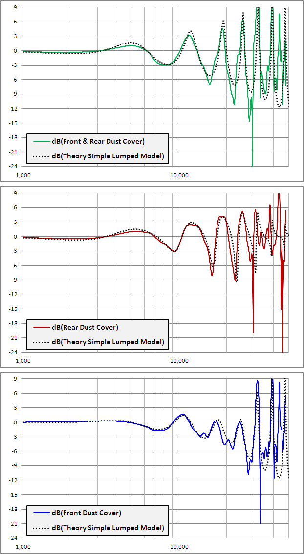

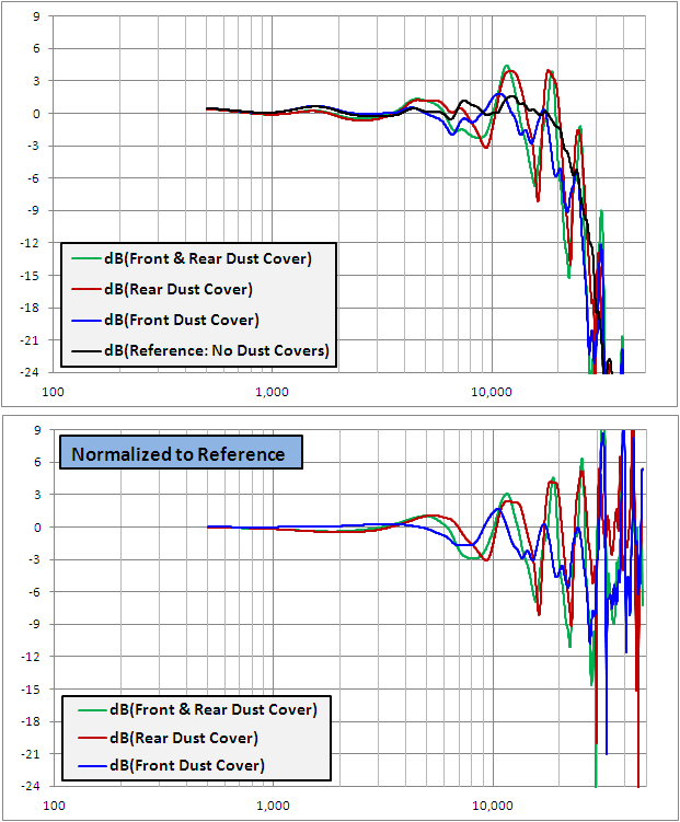

I have never measured an ESL-63, but I did experiment with 3µm dust covers on my ESL and in the end opted for grill cloth because of the effect the dust covers had on the sound. The dimensions of my ESL (ie distance from diaphragm to dust covers) are no doubt different than ESL-63 but you should see similar results to this.
Attachment #1: Measurements of ESL with dust covers on both sides, just front, or just rear.
The bottom plot is normalized to the reference response (ie no dust covers) so is easier to see the effect.
Attachment #2: Measurements(normalized) of dust covers compared to a simple lumped model.(surprisingly good match)
Attachment #3: Measurements(normalized) of dust covers vs. grill cloth.
This was the thickest grill cloth I tested, and even it had minimal effect compared to the dust covers.
Perforated steel grills will produce effects somewhere between that of the grill cloth and the dust covers.
The thinner and more open area they are, the more like the grill cloth they will be.
I meant to mention that the closer you can get the dust covers to the diaphragm the higher in frequency the peaks and dips are moved.
Because of my stator construction technique, I couldn't get them closer than about 20mm.

I hope you don’t feel this talk of dust covers is drifting too far off your topic. The reason I brought it up is that the tape you are adding to the rear stator to replace the felt is likely causing similar peaks and dips in the top octaves. Since the tape is thicker than dust covers, the reflections will be stronger, but they are limited to the area covered by the tape. Somebody will need to measure it to see what exactly the end result is.
Any high frequency boost that can be added to Acoustats is usually welcome. The effect you are hearing is likely similar to the “phase plates” often used on the front of dynamic tweeters to boost the top end and improve off-axis performance.
I posted some measurements in another thread here:
Note also that the perforated sheet metal had minimal effect compared to the thin mylar tape "donut"
Perforated plate Experimental Results

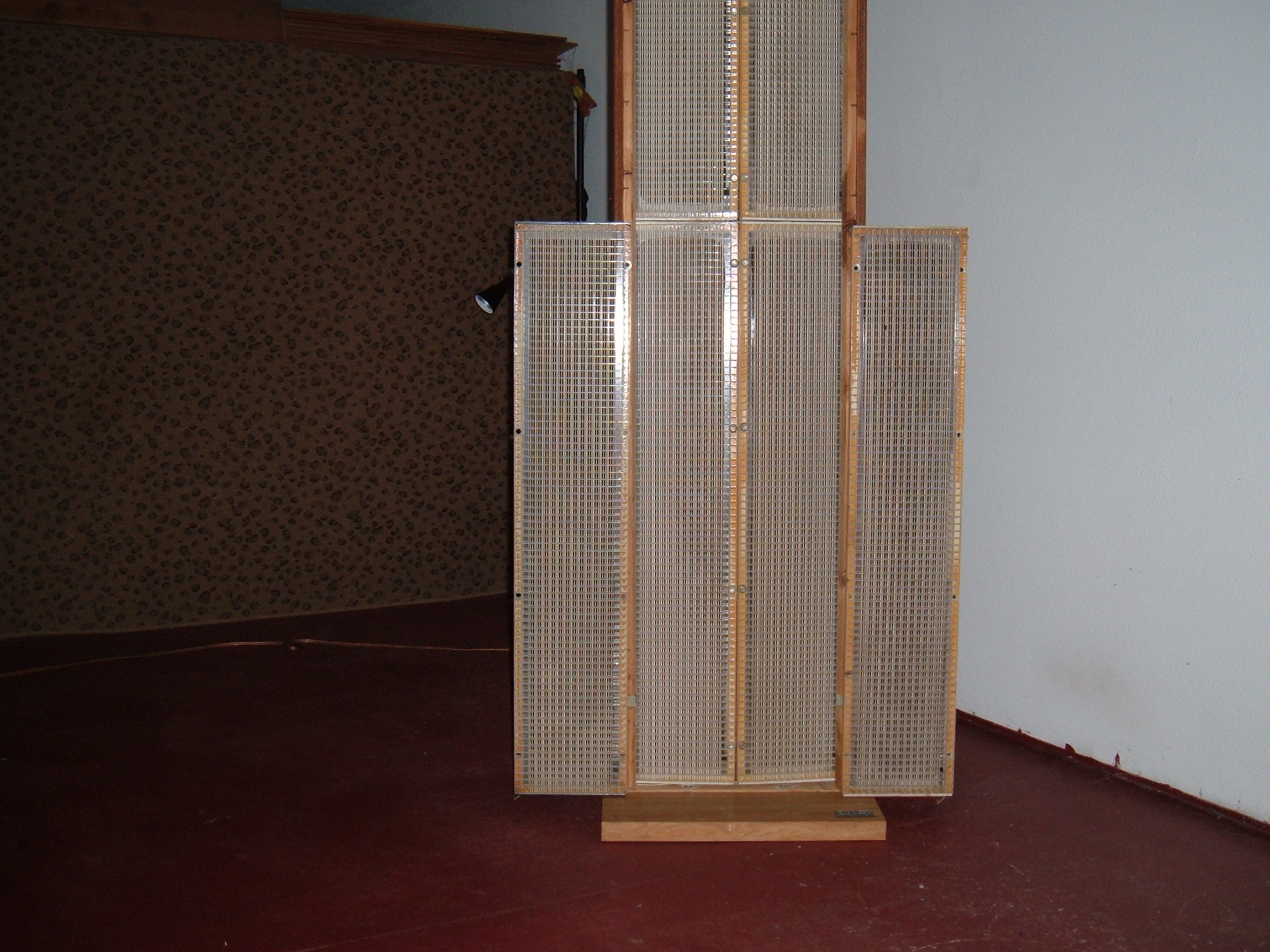

I had to take these 2+2 off a guys hands......no one need a 8' full rang ESL that as good anything $25k speaker made to day by hand in the USA.........
I have been running 6ea 9" panels off one interface.......anyone have any input on the down side?? thanks
