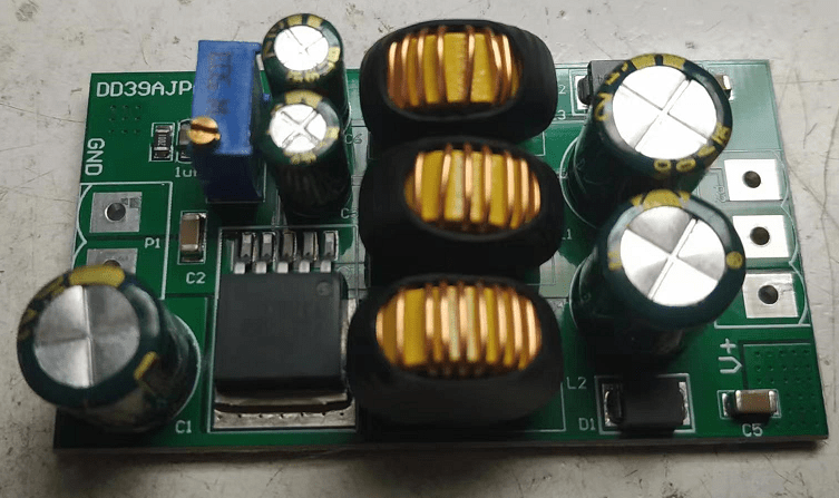

Aliexpress "20W" dual output DC-DC converter module
This is a handy and affordable little dual-polarity output module that's available on Aliexpress here for about $5. I
should point out that I bought mine on Taobao but the modules look to me to be identical whichever platform you
happen find them on.
I fired this up and made a few measurements, primarily I started off looking at its efficiency. The quiescent is
decently low (10mA or so) but delivering around 4W of output at +/-24V I found the efficiency rather dismal
for a switcher and definitely lower than as advertised on the vendor's Ali page. I was getting about 55% which
meant around 4W was going somewhere - initially I wasn't sure just where. I figured best to wait a while and
then poke around with my finger to see what was getting hot as 4W wouldn't be possible to hide for very long.

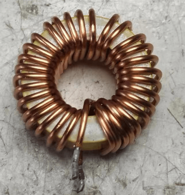

It took less than a minute to detect that the toroidal inductors were to blame, everything else was cool. After
extracting them and taking the shrink jacket off one, it looks like this :
My LCR meter confirms a nice low DCR but at 100kHz, the resistance is close to 3ohm indicating
high AC losses. The switching chip operates at 180kHz so obviously this particular material isn't a
great choice in this application. From its colour scheme (yellow/white) its probably a type 26
which is about the cheapest toroid going, a great choice for a CLCLC power supply filter but
unsuitable for high frequency work. I have quite a few different sizes of Sendust cores so why not
try some of those, they're much better at HF.

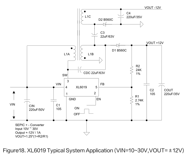

Before that though I wanted to see if I could understand the schematic, a switcher with 3
inductors isn't something I've encountered before.

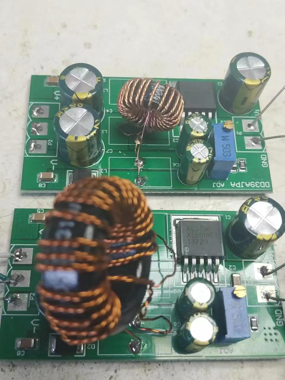

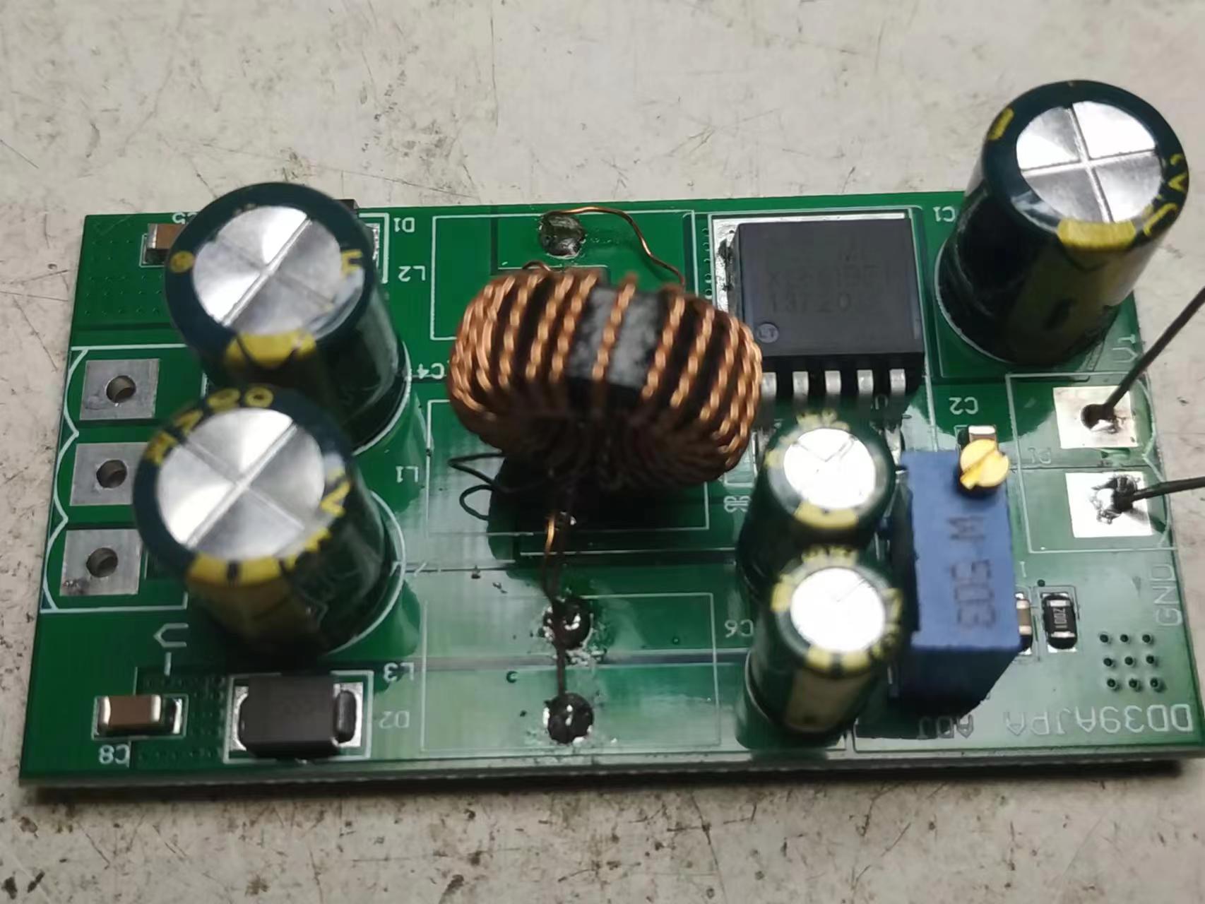

Here's the result - 3 separate type 26 toroids replaced with 1 trifilar wound sendust toroid. Efficiency figures to follow.
The trifilar wire is made out of 3 strands of 0.29mm enamelled copper, I unwound about 2m and divided that into 3, tied one end of the three parallel strands together in a knot then closed the chuck of my hand winding machine around that and turned the handle whilst holding the other end taut. The tricky part is then figuring out which strand pairs up with itself at the other end, different coloured magnet wire would come in very useful.
Reactions: 1 user
I arranged an array of resistors to draw symmetrical current (between + and - outputs, no current to GND). At +/-24V output with a load of 94mA I get 350mA drawn at 15V supply.
Thus input power is 5.25W and output is 4.53W giving an efficiency of 86%. That's more like it. This number degrades to 85% at 10V and 20V input. The toroid gets ever-so-slightly warm so I'm guessing that's where much of the 0.72W wasted is going.

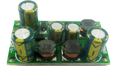

Over on Aliexpress, this next module is called 'DD1912PA' and goes for $2.72 right here. Oddly, its
also available on a Taobao page which is almost entirely written in English. Makes me think 'foreigner
pricing':devilish:
Its about half the PCB area of the earlier one and uses XL6007 which runs at 400kHz (vs 180kHz for
the XL6019). The power output is claimed to be 8W, I haven't tried that much loading yet.
What's different about this one is its using 3 ferrite cored inductors. So no need to change those for
upping the efficiency, ferrite is even lower loss than sendust typically. Why I object to these particular
inductors has nothing to do with the core material and everything to do with the topology. They're bobbin
wound which for the uninitiated means unscreened. You won't want to put this board anywhere near
sensitive stuff so as not to expose that to magnetic flux lines at 400kHz. So on the basis of making
this board a team player we need a screened inductor solution for it.

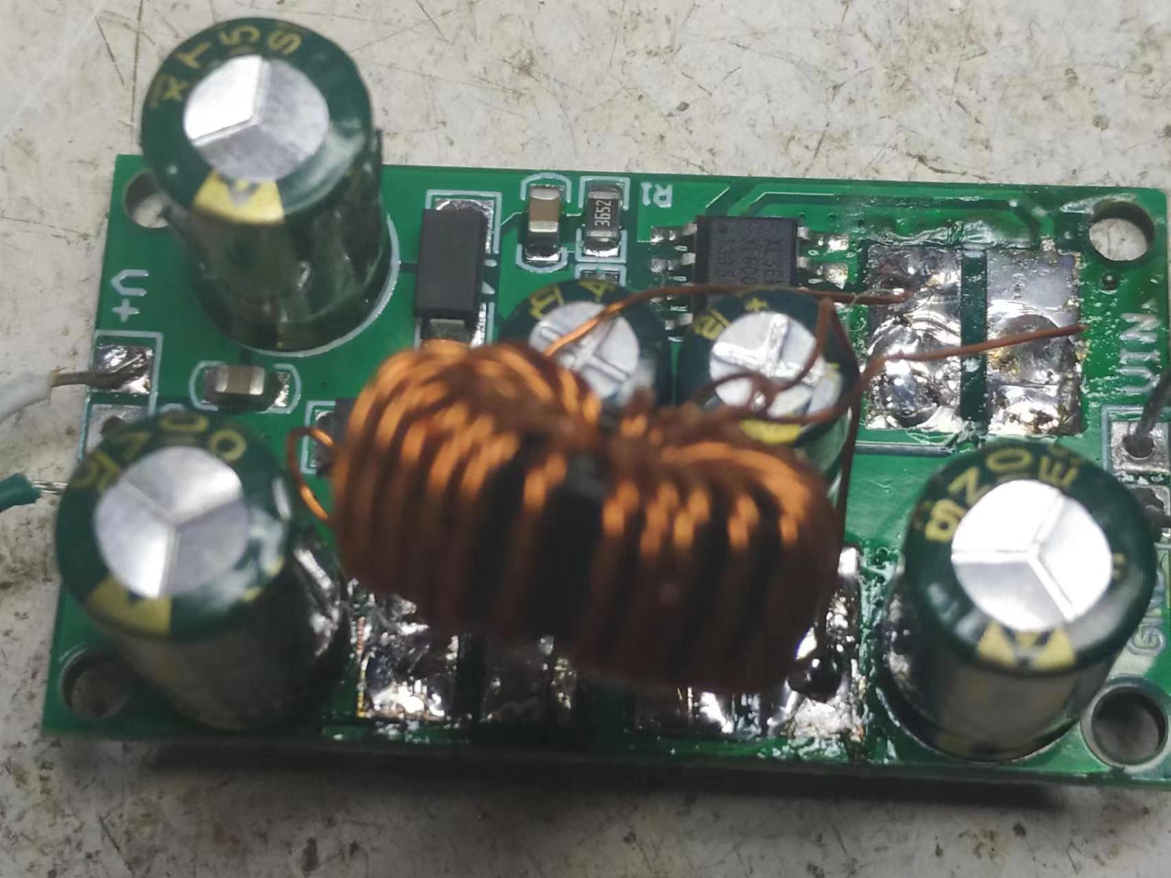

Same 14mm sendust core but based on the efficiency comparison earlier I've gone for thicker wire this
time, 0.33mm.
