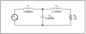

From TI AB-026A:
“The filter characteristic most desirable for sensitive DSP type applications is linear-phase. The linear-phase filter is sometimes called a Bessel (or Thomson) filter. The linear phase filter has constant group delay. This means that the phase of the filter changes linearly with frequency, or that the group delay is constant. These filters maintain phase information for sensitive DSP applications such as correlation, and preserve transient response. These characteristics are critical in audio applications as well, because they affect sound quality greatly.
FIGURE 1. Passive Third Order, Linear-Phase, Low-Pass Filter Prototype”

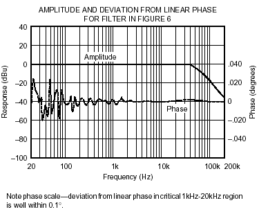

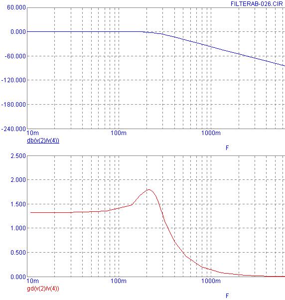

OK, later they wrote in AB-026A:
“The passive design shown in Figure 1 is neither a Butterworth nor a Bessel response; it is
something in between. The component values for this particular response, optimized for phase linearity and stopband attenuation, were found through exhaustive computer simulations and empirical analysis.”
Then they derived active circuit based on the Generalized Immittance Converter. The measured phase response of the active filter is shown below.
How they got this figure? It is not correspond to simulations at all.
Can somebody check the handbook for T L-C-L Bessel filter component values?

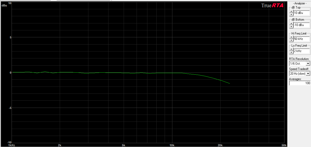

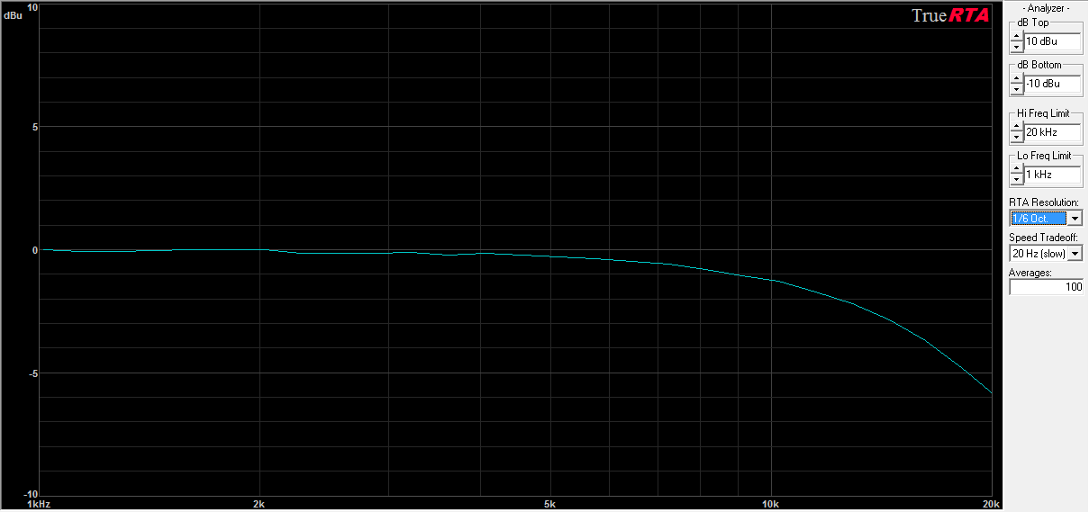

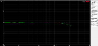

I just stumbled across this old post and just wanted to mention that one such DAC exists, and I actually now have it in my system:
RATOC RAL-24192DM1
(dual mono using two PCM1704 chips, no oversampling and no digital filter)
I measured its frequency response when reproducing 24/96 material, and it's -1dB @ 20 kHz. With 16/44.1 files, instead, it's almost -6dB at 20 kHz (see attachments).
It sounds good with high-res, but a bit dull with redbook, IMHO.
