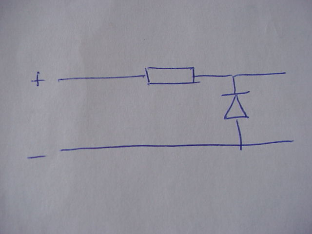

By the way, is there an easy way to test whether the Zener is OK or not? I am shure that I intended to ordered a 9.1V one, but maybe I have mixed up the ordering number. Just measuring with the DMM will not work I guess, gives me something like 0.6 V.

Testing zener voltage can be done by connecting a resistor to a dc voltage greater than the zener voltage to test. Select the resistor to limit the current to a few mA.
Measure the voltage over the zener. Done.
/Hugo :)

The way I have checked a zener:
grab a bench psu of say 12v dc. Tie the banded side of the zener (cathode) to the positive on the psu. Tie the neg lead of your volt meter to neg on psu. Touch your pos meter lead to the non-banded side (anode) and you should read ~9V.
Reverse the diode and read ~.6v just like a regular si diode.
:att'n: Please note: I am NOT saying to place the diode across the terminals of the psu.
Maybe you have it backwards in the circuit?
Please flame me if this is bad info guys:smash:
edit: netlist posted as I was typing, I'd bet his way is better as he is likely more qualified to answer the question....
I tried to check the Zener last evening. Useing one of our normal Lab PSU I connected the Zener, the PSU and the DMM as mpmarino suggested, the PSU starts blinking and telling me that I have an "open circuit", if I reverse the Zener, then I can read approx. 0,7 V. But then again the Diodetest on my DMM tells me that the Zener is OK? I tried this method at 12 and 22 V.

If your not seeing a voltage with that test, it is behaving like a normal diode. The forward breakover voltage should be .6-.7v. The reverse breakover normally wouldn't be attained at a low voltage like this with a normal diode...therefore an open. Are you sure you have a zener there?
Normally you can not test the reverse breakover of a 9v zener with a regular multimeter. My assumption is because the meter can olny develop less than 9v (due to the 9v battery inside) and never reach breakover.
I would try netlist's method. maybe your psu needs to see an actual load before it 'turns on'?
