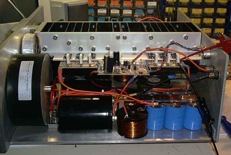

Jean,
it weighs 30kg.
Rodd,
the transformers are from Schuro here in Germany and are vacuum filled with some kind of raisin (very quiet) and made especially for audio. They now got a new type wich is also magnetically shielded.
The 4 black caps are Albs 40.000/80V wich were left over from another project. (I know 80V is a bit overdone but the space was there)
The chokes are 1.8mH/0.38Ohm
The second batch of caps are 22mFx6 per channel.

Hi all,
just a pic of the (almost) finished Aleph5. Don´t know how I will finish the case so for now I settle for this "unfinished" look.
Since the last reports I changed the trimmers for R19 and R21 with resistors (49k and 390R) so now it runs at 2.4A bias and about 63% ac current gain (about 6.7A peak).
I will leave it this way and start on a pair of monos with about 31volt rails and 4A bias with 6 paralleled fets. I think this will cure the power problem into 2-3 ohms and make for some happy listening....

just change the R19 and R21 from the original scheme will work exactly like what u said? 2.4 A bias and 63 % ac.
also have you compare 2 trafo or single trafo for aleph 5? any benefit?
it will depend a bit on the exact values of your transistors but approximately yes.
I didn't compare one or two transformers sound wise, the advantage of two was packaging and maybe a bit less mechanical noise.
William
also to confirm that the original r 19 is 221k and r 21 is 453 ?
