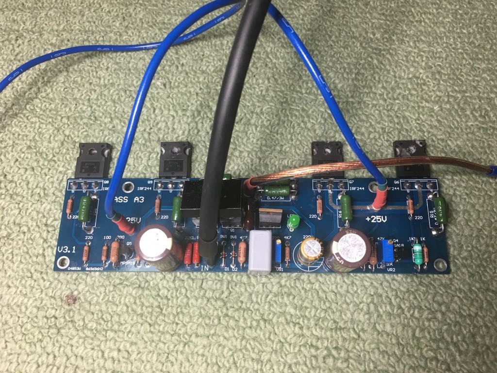

I am a rookie, none electronic background. I am building Aleph3 clone based on an ebay PCB, All fet devices are matched. I changed R106 to 500R VR and R113 to 100K VR for adjusting DC offset and bias. A power supplies is about +/-23Vdc.
I face on Output offset problem. Right channel seems okay. It start at 70mv then I can easily adjust to 7 mV. But on left Channel it start at 3.7V. I try to adjust but not much effect. Moreover a LED will dim when turn too much.

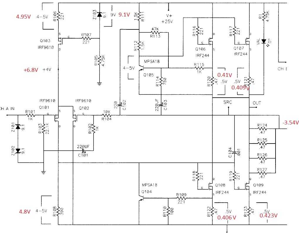

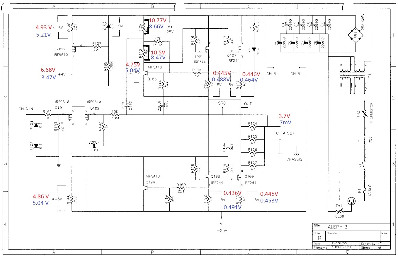

I have checked many time on installed parts and quite sure they are correct as schematic. I measured voltage on both side to compare please see in picture. Please give an advice what I should do next. Thank you

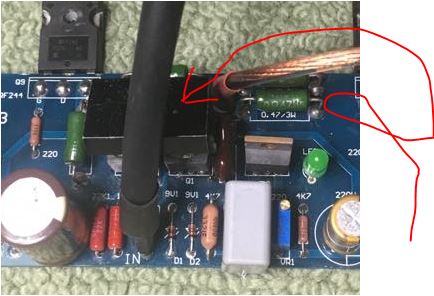

What is the thing over the '610s? (see subtle arrow)?
Is it shorting the tabs together?
Otherwise, I'd go through the ebay board trace by trace to check for errors, and maybe make certain ALL the fets are matched. I've built countless Alephs, and never had an offset issue if ALL the fets were matched VGS. edit - never needed a pot to adjust

Hi Zen mod , The pot was set at 220 at starting point then trying to decreases R108 lower than 390R as you suggested.
mpmarino :they have insulator pad, do not touch each other. The good channel has be good since first SW on , without any VR to adjust. I just decided to add when fixing the bad one.

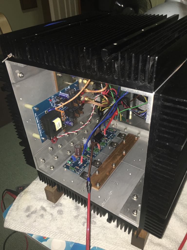

I believe heat sink is big enough.

These input fet is second set actually. At First set, I got about 1.2V, cannot remember plus or minus, then reload second magazine and installed two VRs and get -3.7V. …do not know what to do next ......
I may take some parts out for check and re solder all joints again. Do you think where be a possibly bug area? I really hate to take part out /in through hole pcb.

I changed the parts as you told on both channels. The situation are still same.
When turn the new POT 500R at R108 the DC offset can not be lower than -2.5V then fluctuate , LED dim down.
I reckon it might be have some malfunction or dead part there.

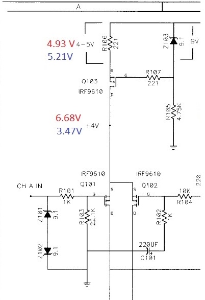

All compared voltage seem be okay except at the Q103 drain leg . It is about 6.7V but the work channel is only 3.5V.
What I should do next? thank you

-if input mosfets are OK,
-if there is no some wrong resistor value,
you must be able to set DC outout offset varying R108 ; in this case you need to decrease it's value (lower bank of mosfets opened too much)
with inputs shorted and no load ........ use multiturn trimpot for R108 , if you don't have steady hand , needed for single turn trimpots
