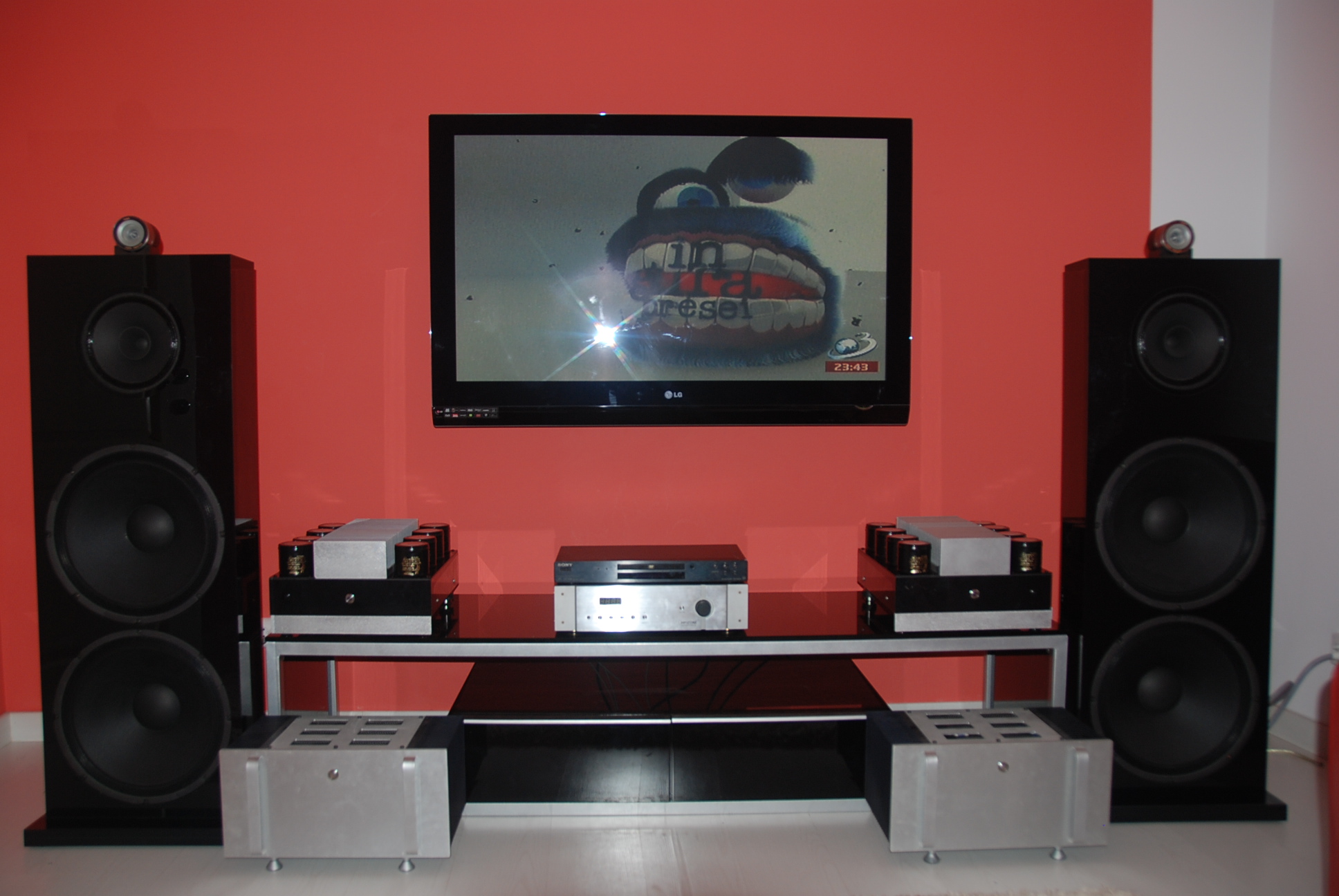

We made measurements to determine gain.
On 4 ohm speakers have 58% (both monoblocks).
I hope good
Maximum output voltage is 25Vrms.
4 ohm power should be 156 wat.
I am very very quiet.
And the sound ... fantastic!
Especially bass.
I am very happy that I succeeded
Thank you all for your help!!!
I hope good
Especially bass.

Hello Vitallica, first let me tell you one thing this is an outstanding and beautiful Aleph 2, I' m like you building my Aleph 2 and have some questions that I need to finish mine. 1- what is the purpose of the clarity caps and the value they have same for the inductors( value and gauge). Thanks in advance and happy listening, JP Duarte.
Hello ,
I apologize for the delay in responding, I was out of country: (
My coils are 2.2 mH / 2.5 mm Mundorff.
Capacitors ClarityCap 4.7 mkF give better clarity and transparency to medium-high.
I like your projects
And to be sure it is worth doing it, it's a fantastic amp!
Best regards,
Vitaly

What speakers are you using?
I made an Open Baffle.
Active bass - two Eminence Alpha 15 "(with Aleph2).
On medium-high - Supravox (with First Watt F5X).
I am very pleased, especially the bass.
