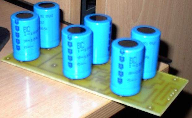

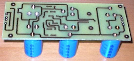

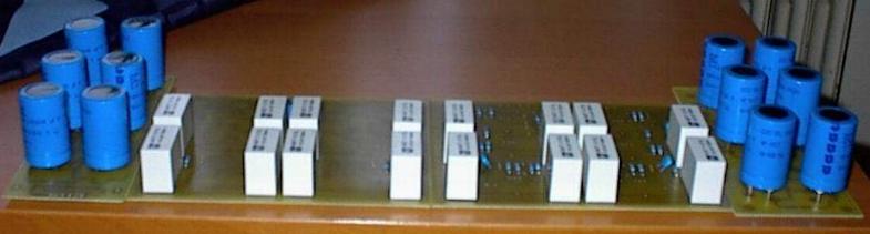

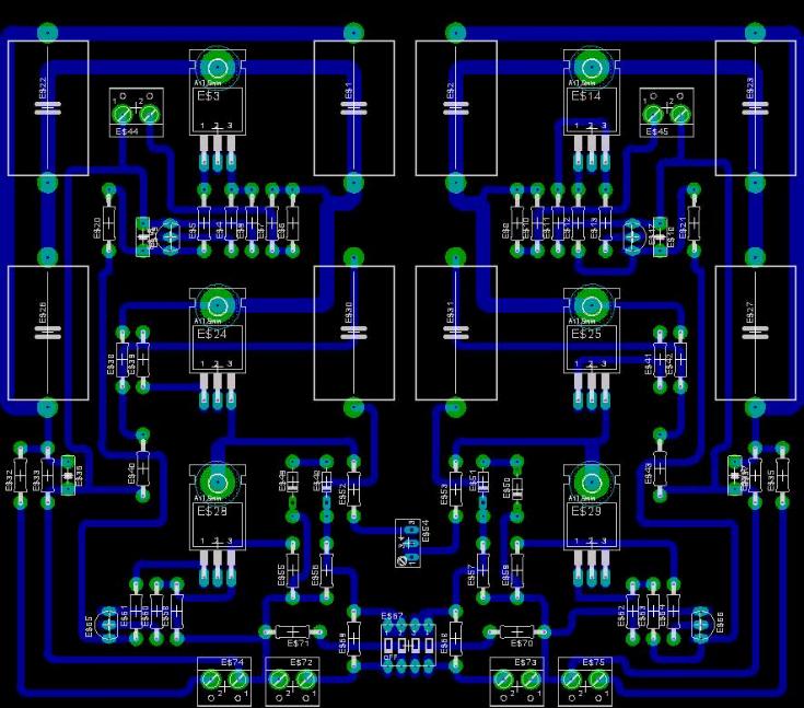

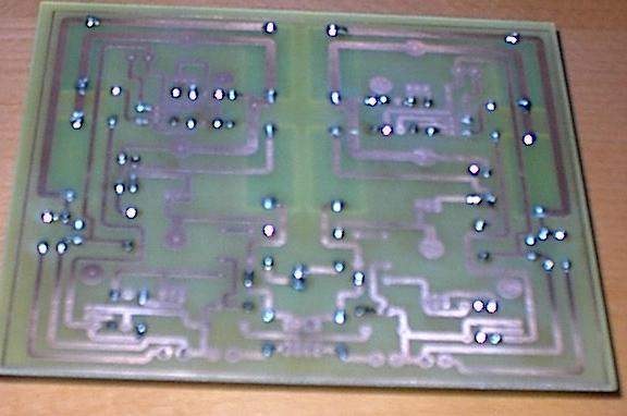

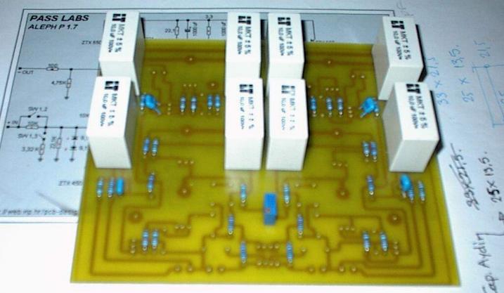

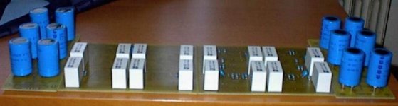

Here is PCB eagle format Guys
Nick:
Can you add the component name to your eagle file?
Thanks,
Thomas
Sorry for reviving, but schematic is in error
Dear Nick and others,
Thanks for the very nice layout, but i feel that there are some critical errors on the final pcb (more on the files in pcb.zip). On the final pcb the orientation of the rightside ZTX are in error (E$66 and E$17); they should be facing the same way as the leftside. Now collector and emitter are reversed on the rightside (with devastating results). Also there are two 221R resistors that should be 221k (E&39 and E$42). Also on the pcb.zip file there is a trace error from the 80v reg input; it runs to earth instead of the correct resisitor. This is corrected in the final pcb.
Can anyone confirm my suspicions?
Thanks!
Regards.
