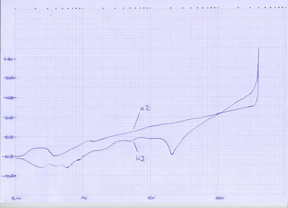

I've drawn down the k2 und k3 components of a X-amp (have seen that in a magazin). Could you explain what happen with k3 @ 20W.
Why is it so low only for a short periode of outputpower?
It has something to do with the SE-bias, but I don't know what?

noisefree said:I've drawn down the k2 und k3 components of a X-amp (have seen that in a magazin). Could you explain what happen with k3 @ 20W.
I assume that K2 and K3 represent 2nd and 3rd harmonic
distortion. If so, I don't recall having seen such a thing, that is
to say a short disappearance of 3rd harmonic on a swept
power curve. It might be an artifact of the test.
