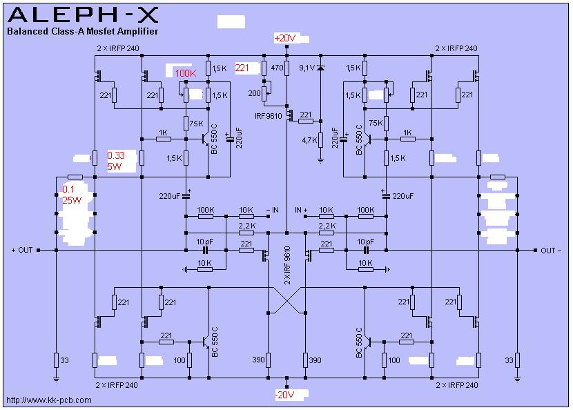

Re: Re: My aleph-x finished with minor problem
Babowana,
There are no cap on circuit.
I prefer input transformer than cap.
Now I consider using input caps.
Here is my schematic. Sorry for unclean pic.
I modified few points since I can't raise bias above 0.53V on
source resister.
But now I only can raise bias 0.54V maximum.
I hope to raise bias upto total 8A.
I think heat sinks are satisfactory.
Power transformer 800VA each channel.
Is it right?

Babowana,
source resister.
Is it right?

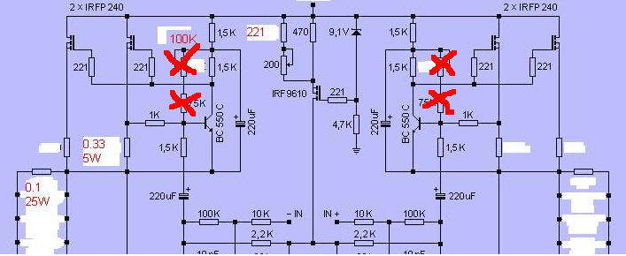

Re: Re: Re: My aleph-x finished with minor problem
If you cut off the resistors cross-marked in red,
you would get about 0.66V across each source R of 0R33.
It will give total 8A bias you want to have.
By the way, I don't understand the input cap yet.
Where are you going to put?
Chois¢â said:But now I only can raise bias 0.54V maximum.
Thank you Babowana
I'll try to raise bias.
I should put cap between input terminal and 10K
resister.
