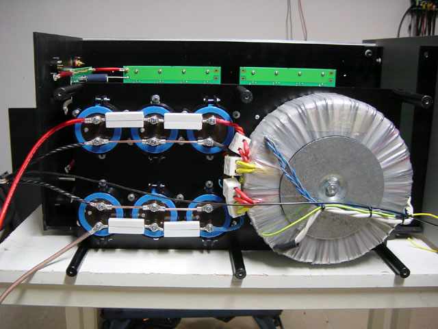

are you shure it is less expensive? You´ll need a bigger transformer, bigger heatsinks and you will draw more current (so your electricity bill will be higher). The temperature inside your case will also be higher.
The Torobars cost around 13€ a piece depending on source and will give a better result.
William
Hi Emeric
I used 2 10W ceramic 0.22 Ohm resistors parallel and connected on the elco.
They heat up the elco to much so I changed the layout and now use a Coil.
Rob
the 2.2mH would be enough. You could probably even go for the 3.3mH but I don´t think this is necessary.
You can have a look with PSUdesigner to see what the difference would be.
I´m not shure if they are easy to buy in France. Just try. If it doesn´t work I could order them and sent them to you but this would cost twice the postal fees......
Be shure to use the right values for the impedance of the caps and transformer. If you want I could sent you the file from my Aleph-X psu.
William
yes,
that´s the one. I just had a look myself but this is the only coil they spec the saturation current (11,7A) for (in the german pdf).
I know I looked quite a long time before I bought them.
William
just found the value for the HQ58 in their catalogue: 6.98A
This could be enough although I don´t think they specify for DC current.
