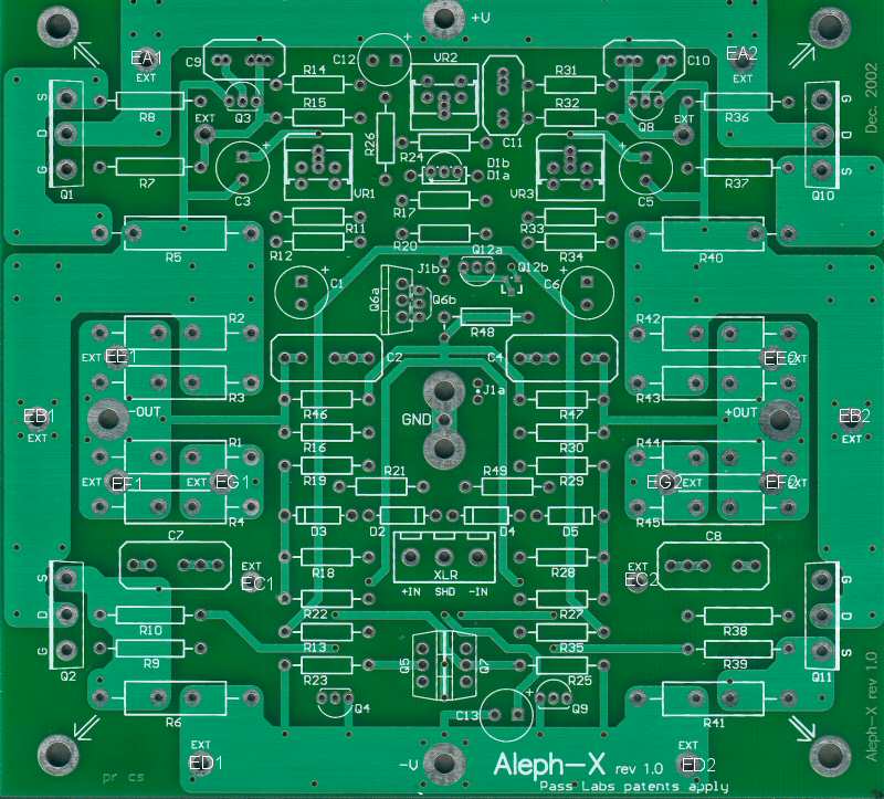

Since many builders of the Aleph-X will choose a version with more than 4 mosfets per channel, the use of the Extension points on the PCB will become important to many.
Here is a picture of the PCB with a numbering from EA1 up to EG2.
Maybe someone experienced with construction of a highpower Aleph-X and these PCB's can give us a short list of how one has to connect these extensions.
EA1 connects with ....
EA2 connects with ....
EB1 connects with ....
EB2 connects with ....
etc. etc.
Thanks in advance!

I never thought we needed to include these connection in the board but it didn't hurt anything.
In short, I would only use the EXT before the gate of the mosfet, the EB's for the active CCS, and the EE's points to run the McMillian resistor back to the differential, R46 and 47, I think. am I forgetting something?
The high current + and - rail, the source and the output resistors should be mounted on an approriate PCB or wired p2p like many I have seen here.
It makes alot more sense to run large cross section wire directly from the capacitors to the bank of output transistors rather than going through the PCB traces.

If you are using Dale's output boards, Where would you pick up the Sense line? The Drain connection is easy enough to connect to the rails but I thought the Source had to be picked up from EB1 and EB2? That takes care of the positive side, but I am thoroughly confused by how to hook up Dales boards on the negative side. It would be so much easier to label the EXT as Gate, Drain, Source and Sense I guess.

I give a complete description of how to use the EXT connections in the wiki page ... hmm... wiki seems to be down right now, so I don't have the url handy. Anyway, it's under the Amplifiers -> Pass Labs section. Note there are two EXT pads you missed... close to EA1 and EA2. Basically, I tried to put enough EXT points to be as flexible as possible with parts that people may want to connect off-PCB.
grataku:
Personally, I wouldn't hesitate to use the EXT points for the power rails, if only to retain the nice symmetry of the PCB layout around the rail feed points, and to keep the wiring clean and tidy. I don't think there will be any issue with the current handling of the PCB... remember, that's 2oz copper, on both sides - not your standard PCB trace by any measure. I figure they'd handle 15-20A with ease.
